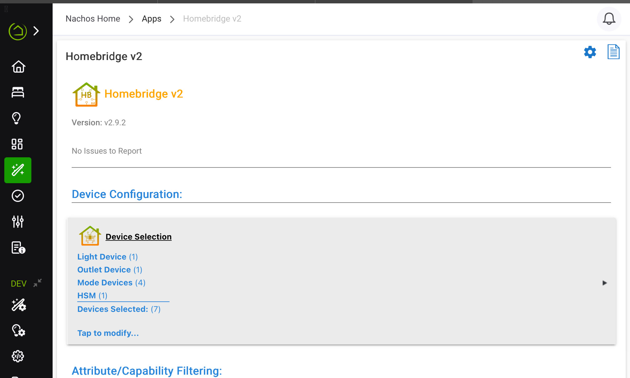

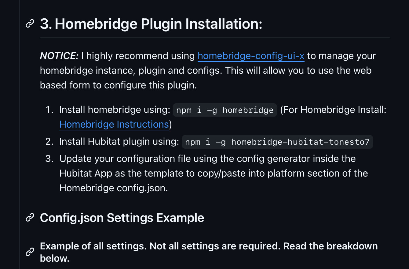

Hi I installed home bridge v2, added the devices but now I'm stuck, I see some generated code but I don't know where and how to use it, I read on the developer's page that there is a plugin ui to easily manage it, but how do I install it ? is it necessary, the npm install commands where do I enter them considering that on Hubitat there is no prompt or terminal.I'm missing some steps.
NOTICE: I highly recommend using homebridge-config-ui-x to manage
With Hubitat's Homekit integration, everything is built in to Hubitat and you need nothing else. However Homebridge V2 that you've installed there cannot work standalone; it is an integration that connects to Homebridge running on another always on machine. In my case I have Homebridge running on a Raspberry Pi. The information from the generated config in the Hubitat Homebridge V2 integration gets entered into the UI for Homebridge on the other device that runs it.
In summary, you need to either install the main Homebridge app on another always on device OR delete the Homebridge V2 integration and just use the Hubitat built in integration which can do everything.
