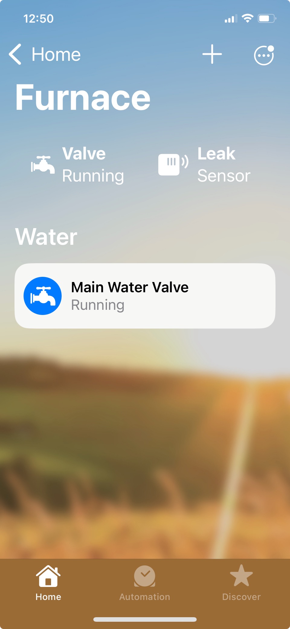

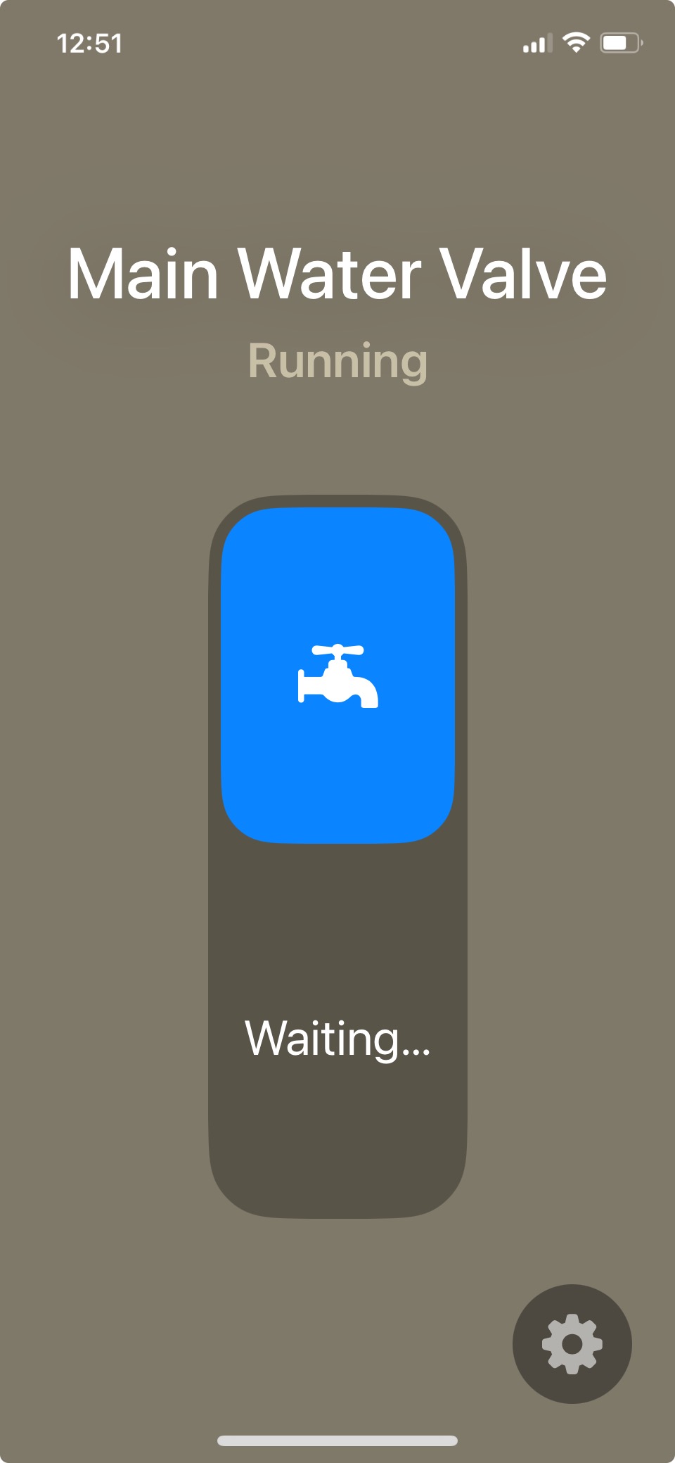

In Hubitat I am able to open and close the Bulldog. It appears to work as expected. Going to the Home app on any of my Apple devices and the Bulldog lists as "Running" but "Waiting", and never gets past that. As a result, I cannot create any automations for the Bulldog based on a leak being detected from the Aqara sensors.

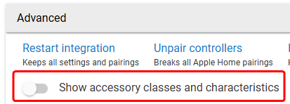

Turn on this setting in the HK integration, and then see what attributes are enabled for your water valve.

Your note on the water leak and automations on the valve is concerning if true, but it does not add up for me. Aqara's new valve implementation in HomeKit would appear to counter that logic but I don’t have first hand experience with it to confirm (just the advertised materials). When I go into a water sensor I can create an automation based on a leak detected, but the valve doesn't show up in the list to apply the action against (what you were saying). It is likely that the valve does not show up though because it is in a "waiting" state which means it is not responding to HomeKit. HomeKit can't include a device for use in automations if the device is non-responsive or if it fails to provide the characteristics that say what it is and does. There is a wrinkle in this thinking in that it may be that, to your point, Apple does not recognize Valves. I created a Virtual valve to see if that offered a different experience. The interesting part is that when the Virtual value was in the Closed position HomeKit showed it as off and nothing about “running”, but the minute you clicked on it (it looks like a switch in HomeKit) to change states (going from Off to On) you get the “running” and “waiting” state. It switches back Off and all is good again. Not sure if this is a Hubitat valve implementation issue or a HomeKit one.

Nothing where? Show a screenshot of your valve in the HK integration app with that setting enabled. There will be additional information shown once that setting is enabled.
I have a valve integrated via Homebridge and it works fine, so I know it can work. I can turn it on and off from Apple home and it shows the status correct with the water spigot icon. I see mine also says Running and "Waiting..." under it, but I know I have turned it on from HK before (do not want to disrupt things right now and test it). I have never tried it using the system integration.
I just tested automation in HK again, making an automation to turn off the valve. I selected a water sensor and add automation, click next to pick the device to act on and the valve is not in the list at all.
