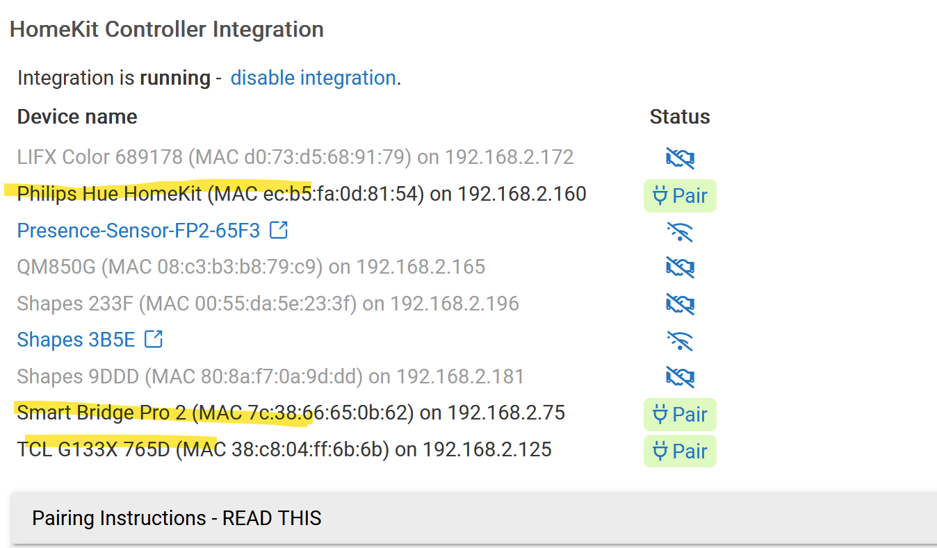

These three are hardwired. (Not paired)
Yup that's what mine used to look like too, not sure what's up
