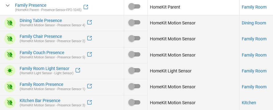

I presume all the zones you may have created and the lux sensor are properly presented in Hubitat?

Yes, all the zones as well as the illumination sensor are present as child devices:
