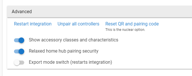

Yeah, if you go to HomeKit integration app, scroll to the bottom, and turn on Show accessory classes and characteristics toggle, it should give an option to remove battery capability from devices, one device at a time.

It is in 117. There will be some visual improvements ot it in the next update, but the basic functionality should already be there.

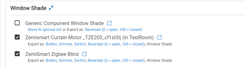

Screen Shot 2022-12-10 at 8.24.53 AM

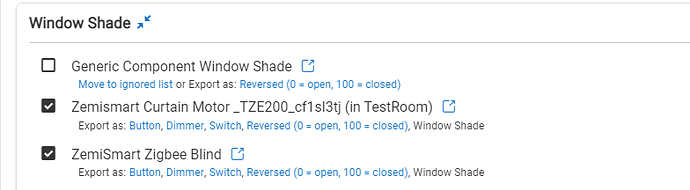

No battery "Extra"
It exists as an attribute in the driver.
Looks like a bug, to be fixed in the next build.

I am still seeing this :cry: should it appear below the Blind?
Edit: Now showing, many thanks.
