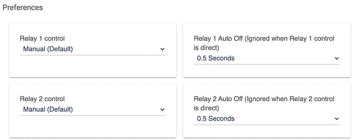

In order to get a more palatable UI, I caved and setup Homekit. Everything works as expected aside from this z-wave relay I use to open and close my skylight. It's two normally-open relays (into one) that needs to be closed for ~0.5s for the skylight to register it. It works fine within Hubitat thanks to this configuration:
However, no matter how I expose those to Homebridge, they appear as dumb switches that don't reopen after they're pressed so I can't operate my skylight.

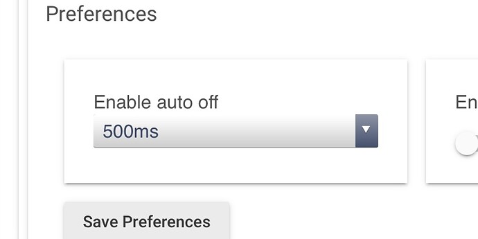

Well, actually, while it does work, the switch state doesn't reset as it should in Homebridge. Is there a limitation of some sort?
I have enabled auto off set at 500ms, but HomeKit doesn't reflect that, the virtual switch stays on until I set it back to off.
