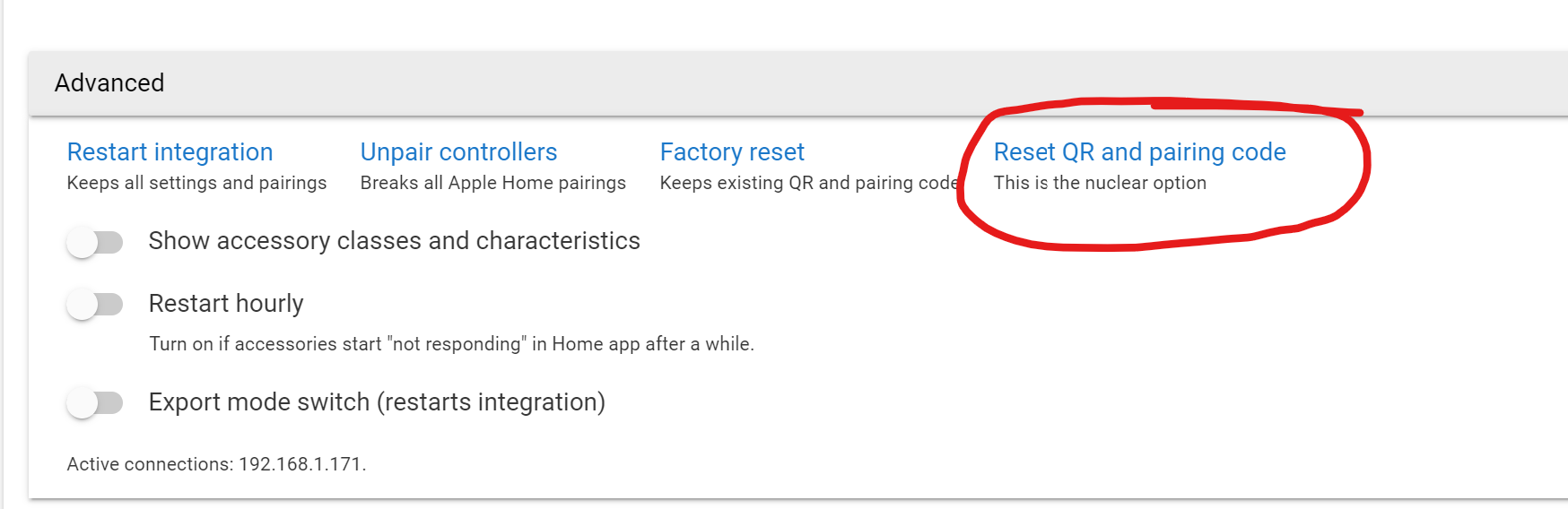

You could also try the Nuclear Option. :sunglasses: :boom:
In the Hubitat HomeKit App's Advanced Options
Since your Hubitat devices are no longer in Apple Home, there should be no reason to be concerned with the 'nuclear option', right? This will generate a new QR code which you can then try using to add the Accessory again to Apple Home.

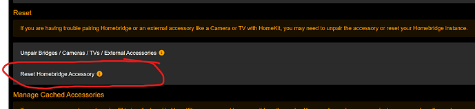

I am sure you can change the HomeBridge QR code as well. Have you tried doing so?
Perhaps simply try this option in Homebridge?
