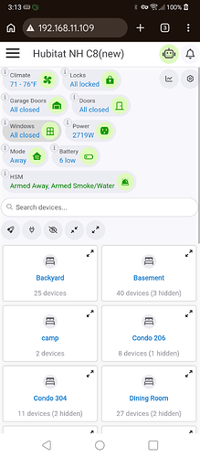

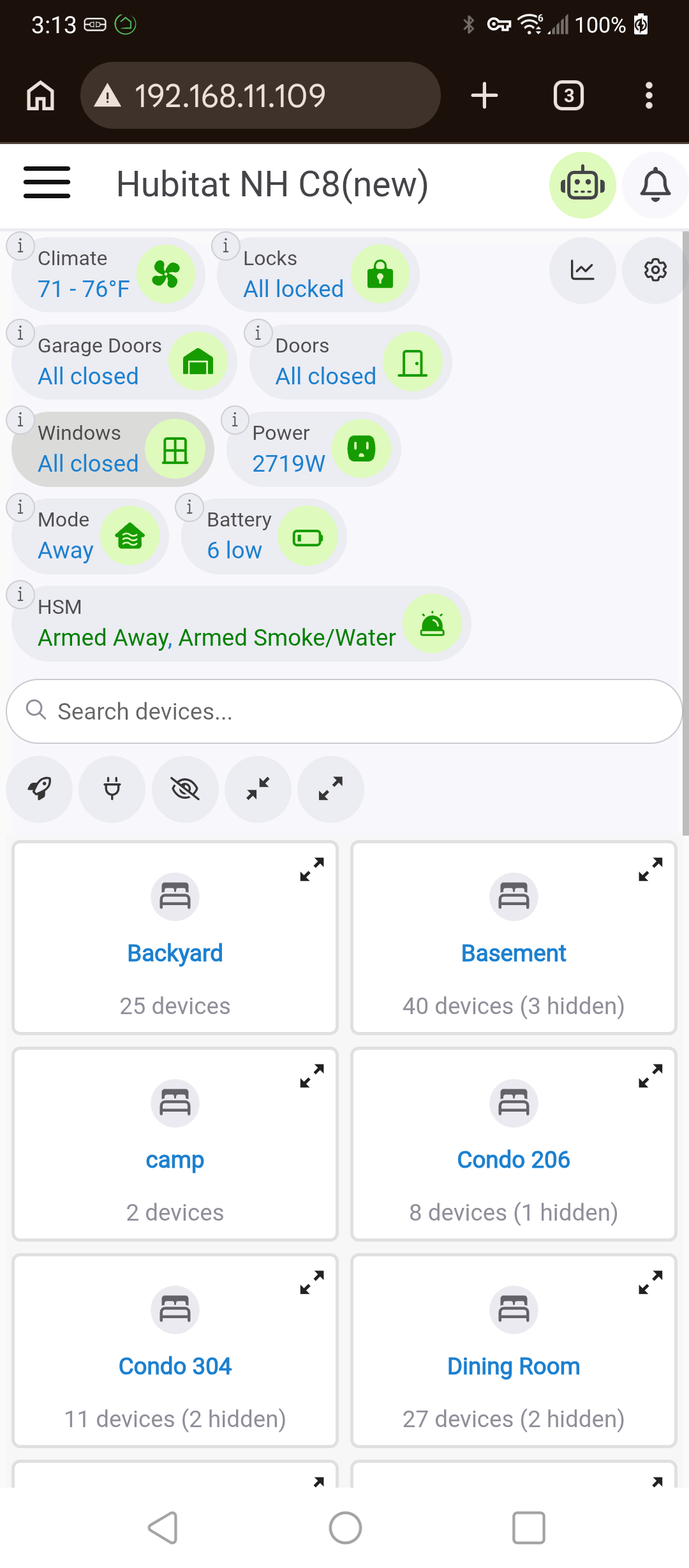

Home page bubble power attribute
My Aeotec is using a custom driver - so I can see that it supports VoltageMeasurement, Refresh, PowerMeter, EnergyMeter as capabilities. It also has power and energy available as attributes so I wonder what capability is needed.
YA as i mentioned (ignored) when i switched to my custom driver it came up as soon as i added switch capability.
Just powerMeter. But like I mentioned above, there is an issue that will be corrected.
I added switch to mine and it's there now. Unfortunately with all of the readings being brought in from my shades, it appears as though my home is about to crash the National Grid! So I guess unliking of 'Switch' from the power bubble is the fix for that :+1:
thanks now fixed and with the customization options the bubbles are finally becoming useful.
