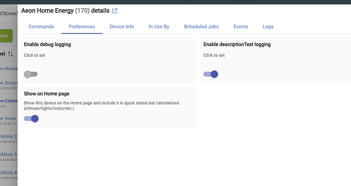

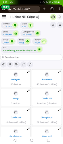

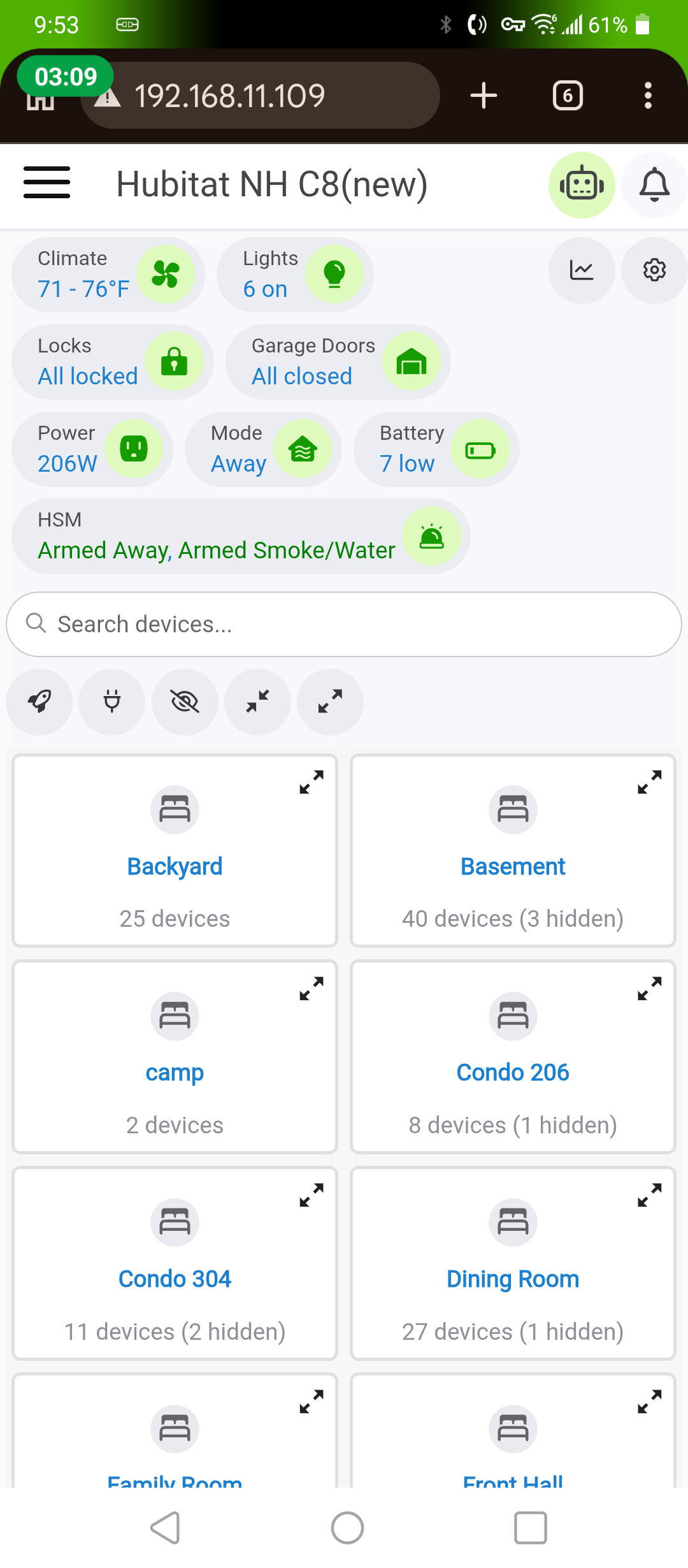

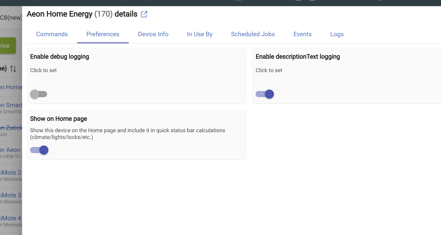

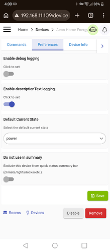

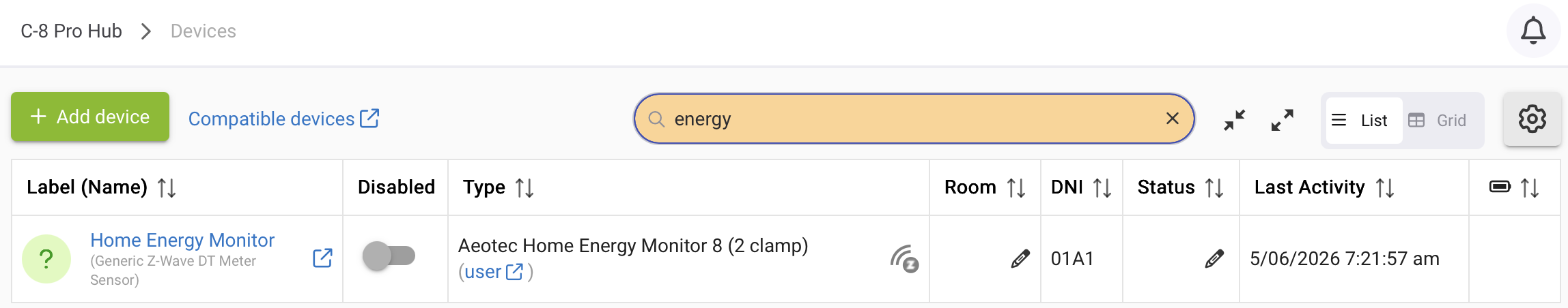

why is my aeon home energy meter not showing up as a power option.. that is the one i really want not the stupid kasa switches. I am using the built in driver

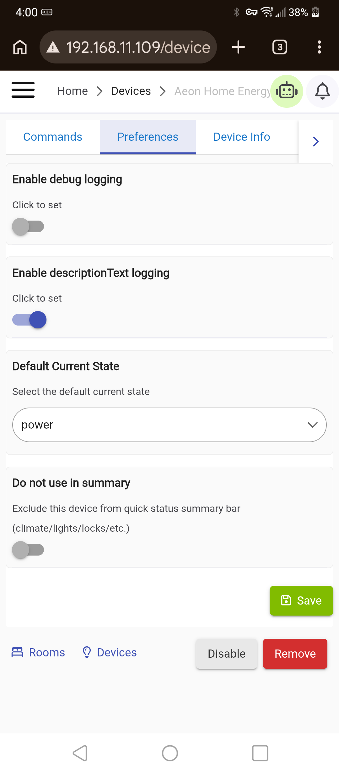

thanks i assume that just refers to the do not use in summary radio button i referenced. so how does that differ? weird
i also checked that and it still does not appear..will try new beta now, thanks
again thats not my issue. it still does not show up and the driver does not show up as a compatible device
ie

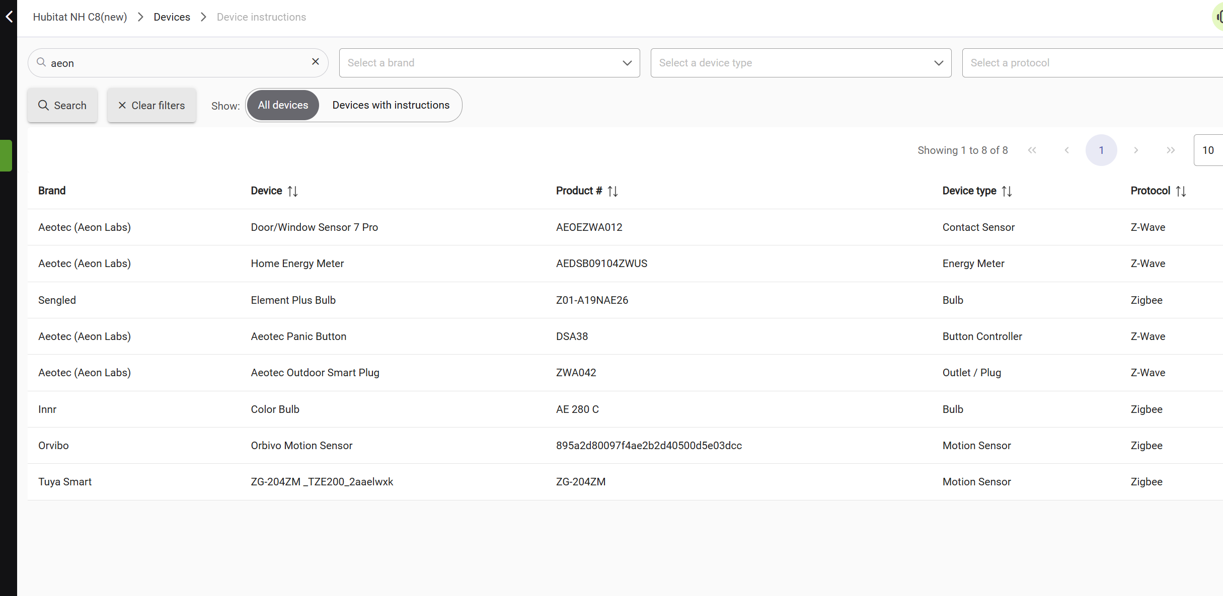

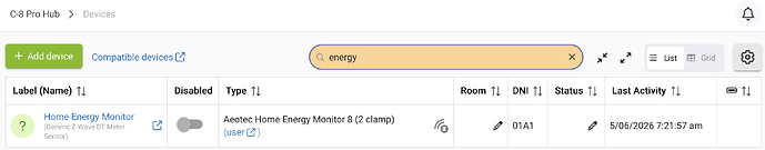

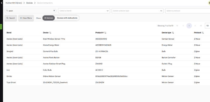

actually looking closer it does show up as a compatible device in the list but still not showing up in the list of devices reporting

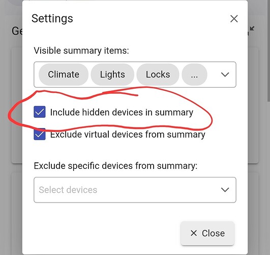

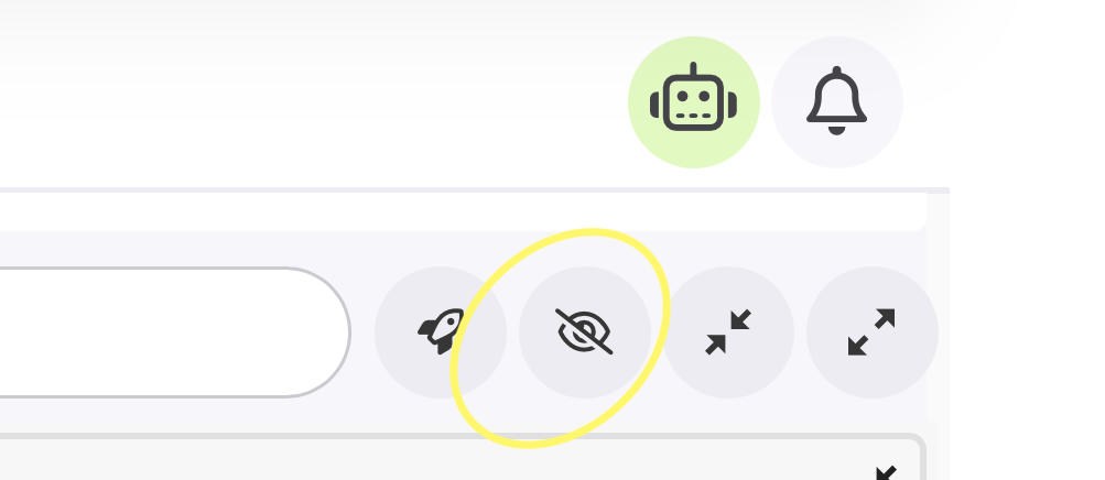

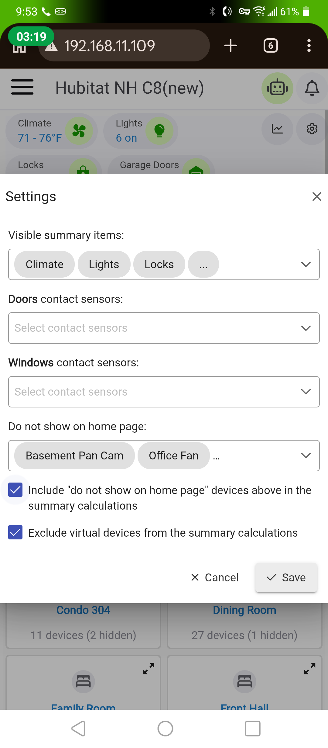

I think Bobby was talking about these hidden devices (the longstanding feature unrelated the the new additions you've ruled out), where you'd have to enable the option to show the device and then click the eye icon on the device to un-hide it, if that is indeed the case:
The built-in driver exposes the Power Meter capability, so there's no reason it shouldn't work for this like other devices do.

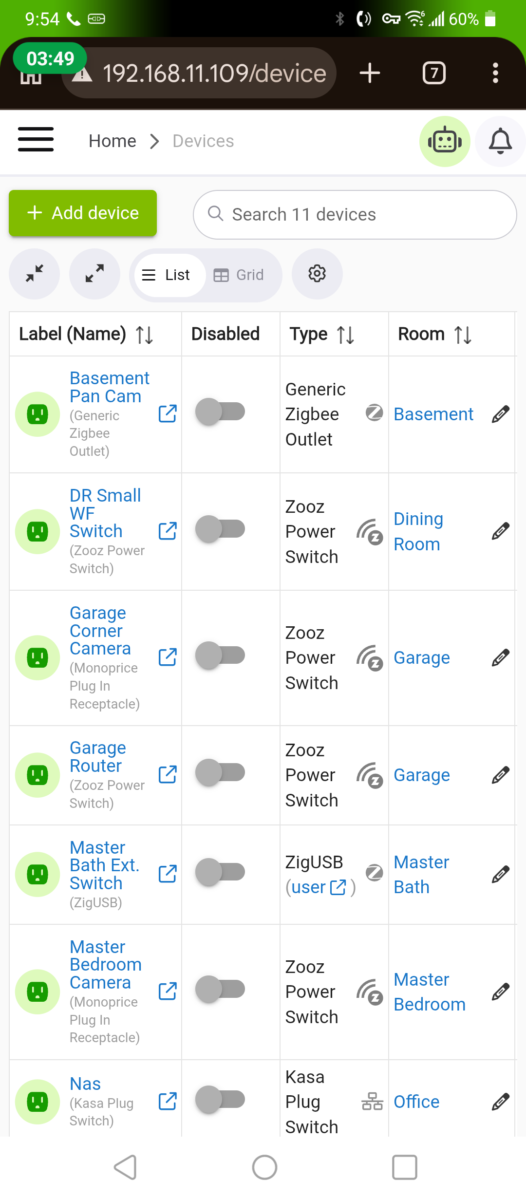

it doesnt work.. i just verified by switching to an old version of a custom driver for this.. take a look at the devices it only shows devices that are in addition to power meter are also SWITCHES... as soon as you remove the switch capability it disappears.
@bobbyD
probably has to have another capability primary along with power meter.. probably bulb, switch, dimmer etc. but the power meters do not.

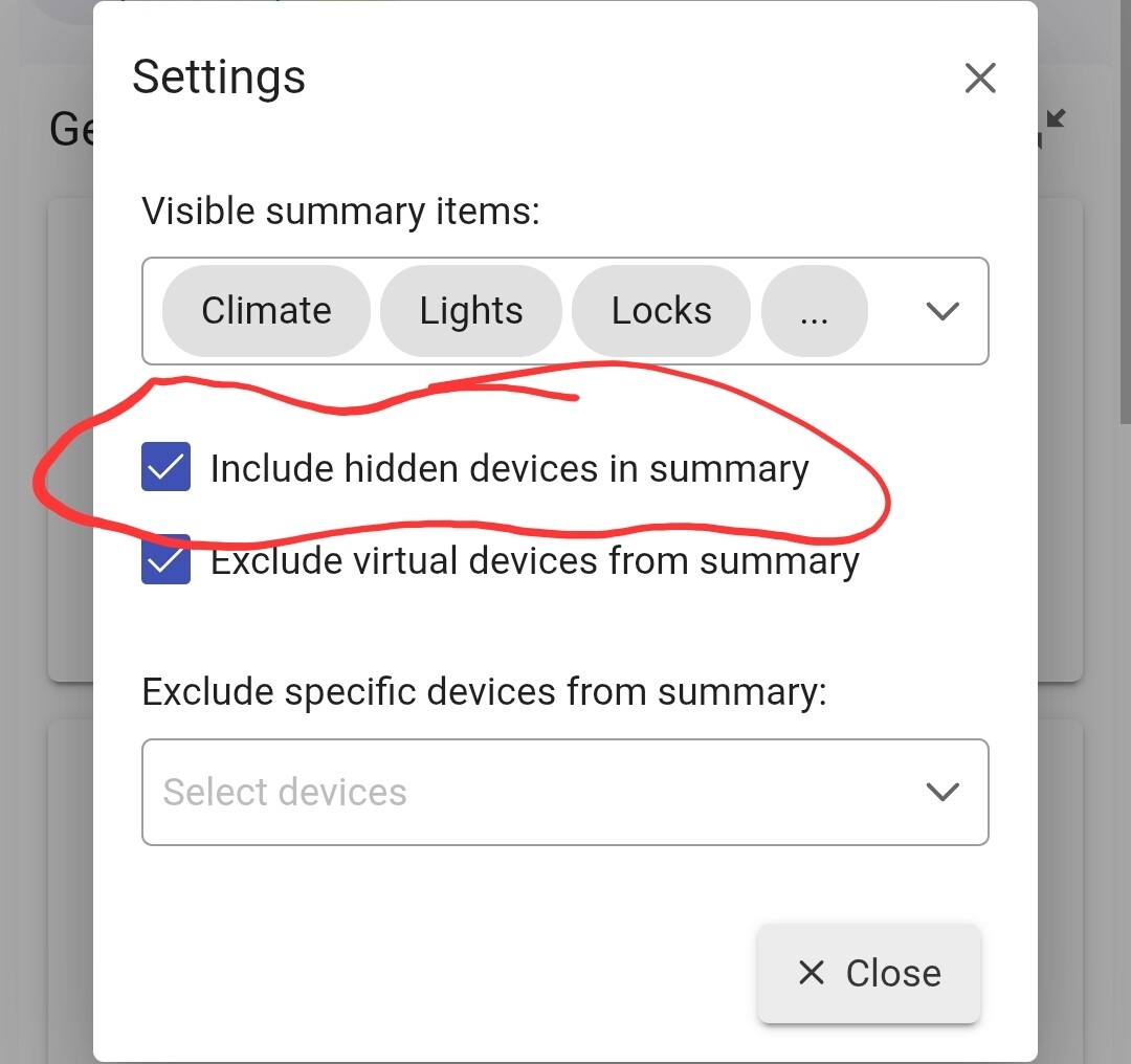

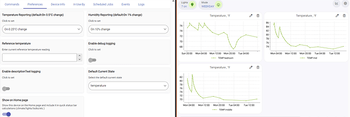

Did you enable the summary settings like in my picture? If so can you post a screenshot of the settings and the tiles? I wouldn't start changing drivers. As long as the PowerMeter capability exists and the power state is populated, it should be included.

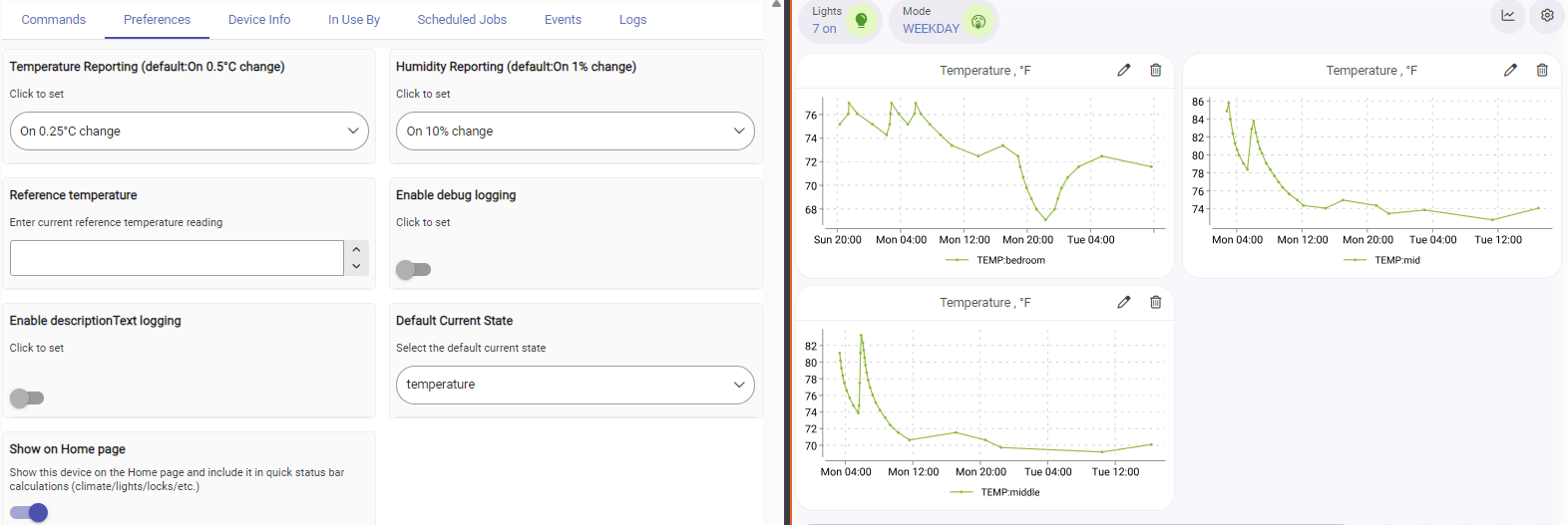

Temperature sensors aren't showing.

yes I did all that did was re+show all devices that I purposely don't want to show like my kasa switches

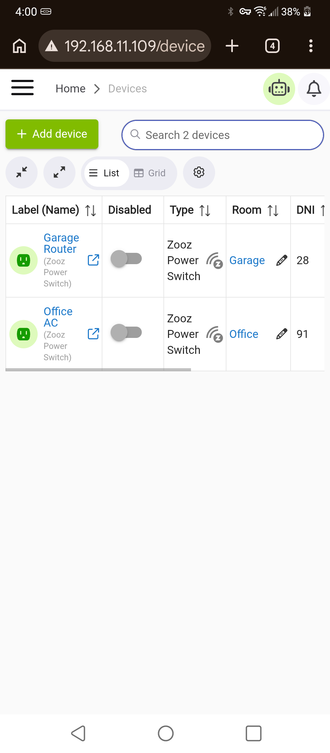

Think my Aeotec HPM is the same, I’m only seeing outlets. I’ll have to take another look :eyes:

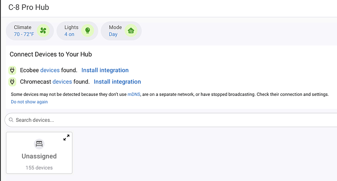

I don't use the Home page at all, or Easy dashboard if related, but as a result of this thread, lol, it suggests to install the Ecobee integration. Now, it's been a while, but the HomeKit controller is installed and I have my two thermostats on the dashboard. I hesitate to click on anything on that page, lol.

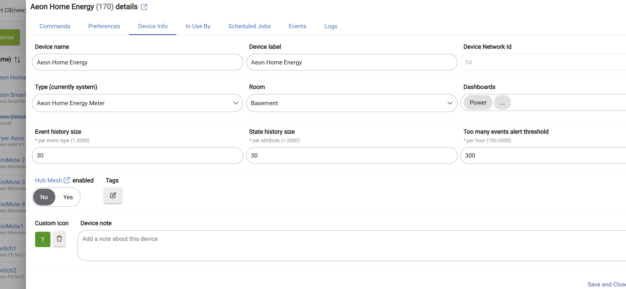

As a side note Hubitat gives me a ? on the device page for my later model Aeon HEM.
You can change that.
Device Info --> Custom Icon
Thanks. I don't really care. I thought it may have been related to OP's post. Probably not.
I think it may be . same here . as mentioned it's not identified as any primary capability like a switch which I summized is why it is not coming up. bit only hubitat knows for sure
