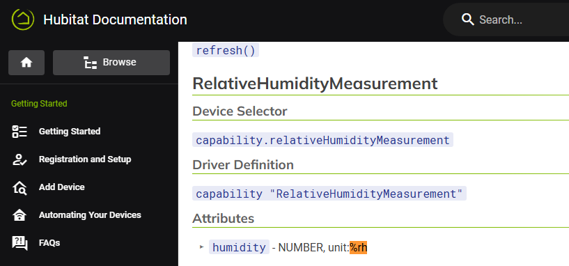

Hubitat's standard is that the Relative Humidity unit is %rh, not just a percentage sign :
For compatibility with Home Assistant, I suppose that the substitution must be implemented into the MQTT Export Integration (beta) @gopher.ny
Next (beta) build.
