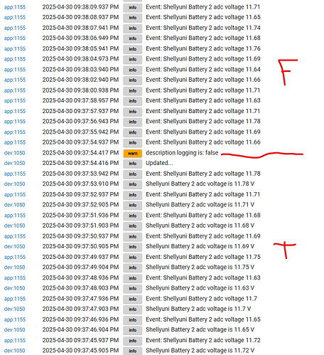

I went to the preferences tab, enabled the DescriptionText logging and did a save. Then went back and toggled it to the left and did a save. Below is the log. The bottom half of the log is with the toggle to the right(true?). The top half is with it toggled to the left(false).

Dev:1050 is the HADB voltage device. And as your logs are showing, the description no longer appears for that device. You still get logs from an APP (1155) which is not HADB.
If you click on the grey info button, you should get to that app and be able to find out if the app logging can be disable.

I paused that app and it stopped. I resumed the app but unchecked Events from logging and now things are good.
