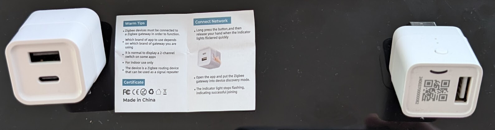

Two different types, with a male A or C port. Too bad quanity is limited to 1 of each.

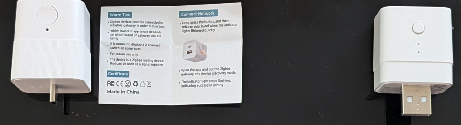

It's a bit "cheap" feeling, compared to the Sonoff ZBMicro. On the other hand, unlike the Sonoff, so far it hasn't crashed my Zigbee mesh. (to be fair, I've never moved the 3 ZBMicros I have to the C-8 Pro; they remain as the only devices on my 2nd C-7; they were crashing my main C-7 before I migrated the mesh to the C-8 Pro).
The biggest annoyance: the USB male port is centered. The design of the ZBMicro is nicer with the port being offset.
Some comparison pictures:

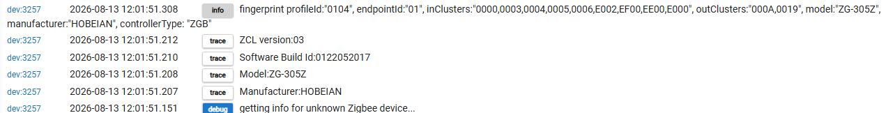

Fingerprint:
@support_team Can this fingerprint be added to Generic Zigbee Multi-Endpoint Switch?

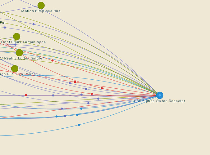

The sonoff one I just got is one hell of a repeater, signal very strong, not even on turbo. My mesh seems to be fine 2 days in, we will see. My Hobeian one was a fair repater, lots of connections, but close to 50% red(poor links) were displayed. Not sure how accurate the Zigbee Mapp app is...

Not surprisingly, the fingerprint for the USB A device is identical:
fingerprint profileId:"0104", endpointId:"01", inClusters:"0000,0003,0004,0005,0006,E002,EF00,EE00,E000", outClusters:"000A,0019", model:"ZG-305Z", manufacturer:"HOBEIAN", controllerType: "ZGB"
ZCL version:03
Software Build Id:0122052017
Model:ZG-305Z
Manufacturer:HOBEIAN
