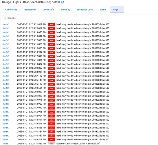

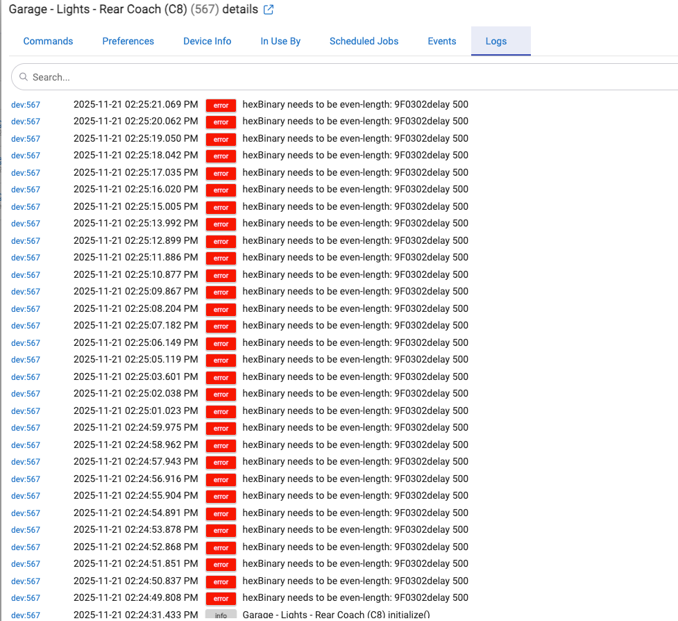

I recently observed that my hub was experiencing excessive load. Upon checking my logs, I noticed that one switch (Inovelli Dimmer 2-in-1 Red Series VZW31-SN) is displaying the error 'hexBinary needs to be even-length: 9F0302delay 500' over and over each time the switch is initialized, see screenshot below. This is the only Inovelli switch that I have on my ZWave network. I have reached out to Inovelli and worked with their tech support to try a number of things. Below is everything that I have attempted, but none of these steps have resolved this error. Please let me know how to resolve this. Thank you for your help!

Thanks a lot for your reply. The problem is that the device works fine. There is no device or app to troubleshoot. After about a week of uptime, my hub alerts of excessive load and when I look at the device stats, this switch is consuming the most resources on the hub. The error in the screenshot seems to indicate that there is a coding error in the device driver, or in the Hubitat firmware. When I reached out to Inovelli, their support said that they arenโ€™t able to replicate this error.

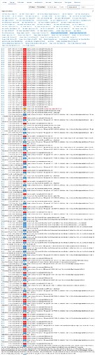

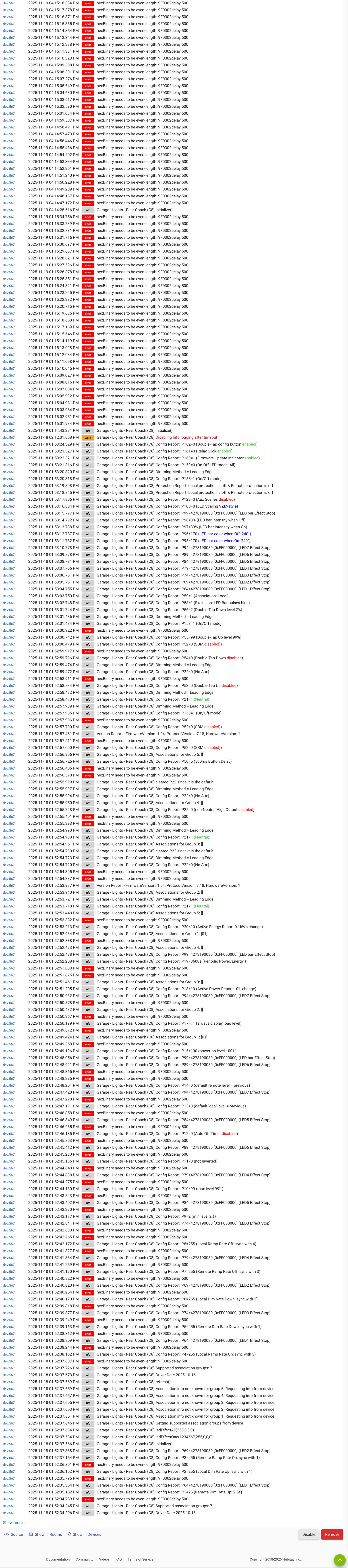

  3. I took screenshots of my logs before turning on debug logging and again afterwards and rebooting my hub, since this issue seems to be triggered by the initialization routine. I also took a screenshot of my device statistics, which shows that after 3 days of uptime, this switch is consuming 17% of my hub's resources and has over 3K states. Could this be caused by the code error as well?
Before enabling debug logging and rebooting the hub
After enabling debug logging and rebooting the hub
Device stats
Yeah, the very last (reading top down, or first chronologically) log entry in your second screenshot, the one at 09:49:43.307 AM, has the key: they're apparently trying to run zwaveSecureEncap() on a list of commands that has both already had this method and delayBetween() (or perhaps manually inserted delays) run on it. The zwaveSecureEncap() method is barfing on the "delay"s, but I'm not sure it would like to be run twice on the same actual Z-Wave command either (I don't know; it may or may not work -- the delays are just the problem that is apparent from the logs). They need to figure out a way to stop this from happening in their driver -- confirming my guess above.
