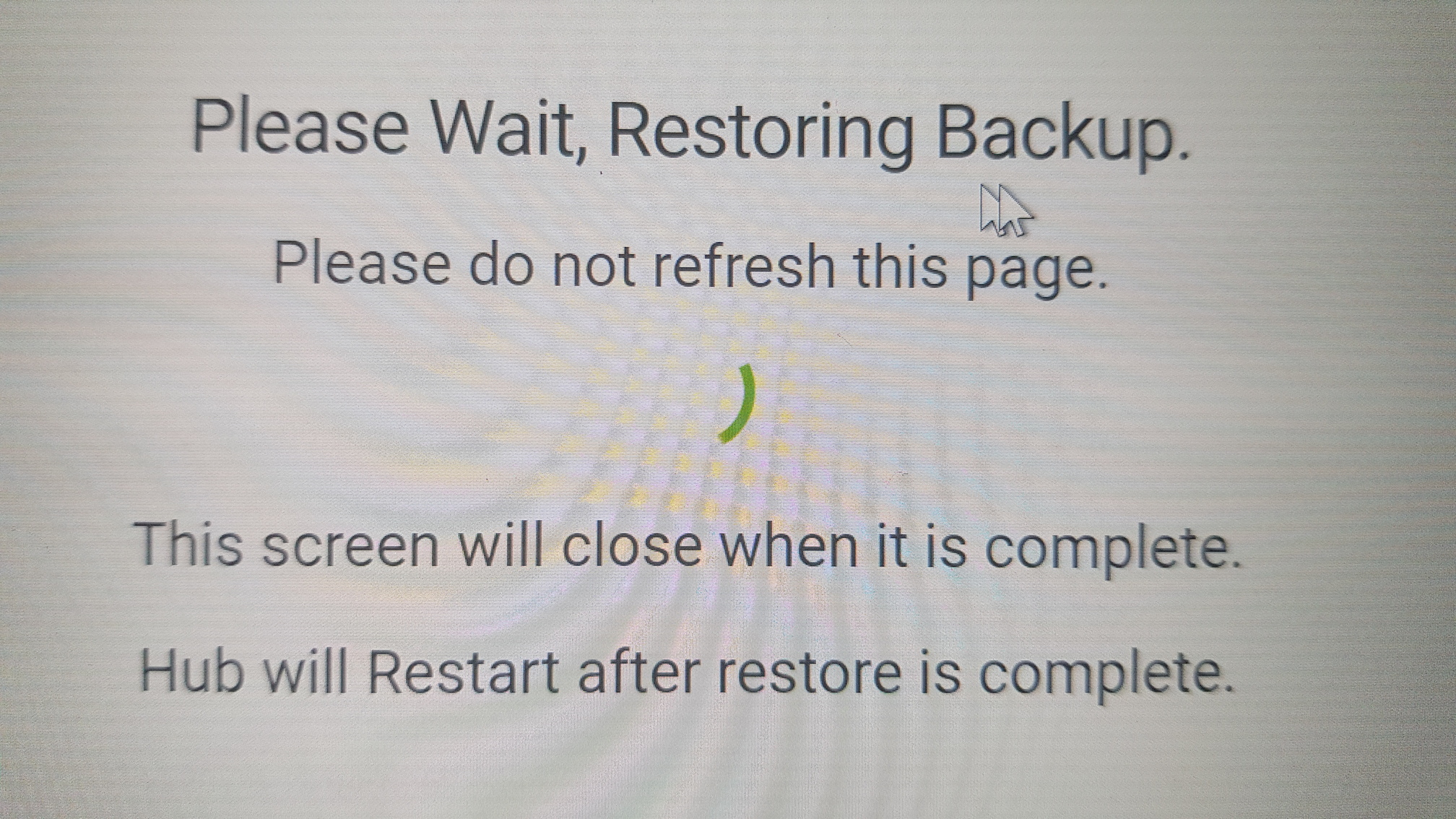

Will try a soft reset now.

Life is nothing without that excited yet strangely sick feeling in the stomach. Like asking your first crush out on a date. Or an important appointment with your boss' boss. Or waiting for a Hubitat soft reset to successfully complete.
It's taking a heck of a time. How slow is this device? How huge is my database? How high is the moon?
