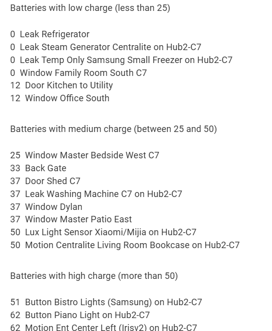

I like the BatteryMonitor app, run it every day. But I took the liberty of modifying the display so that all sections are in alphabetical order. Here's the revised code:
// lgk change all \n to \r\n so att mail to text does not reject the email

            ' * modified by lgkahn to send complete message whenever the schedule fires, showing the status of all devices.\r\n\r\n' +
			'2025-10-16 v0.0.6\r\n' +
			' * modified by John Land & ChatGPT to sort each section alphabetically in ascending order.'

        if (listLevel0) {
            section("Batteries with errors or no status") {
                paragraph listLevel0.sort(false).join("\r\n")
        if (listLevel1) {
            section("Batteries with low charge (less than $settings.level1)") {
                paragraph listLevel1.sort(false).join("\r\n")
        if (listLevel2) {
            section("Batteries with medium charge (between $settings.level1 and $settings.level3)") {
                paragraph listLevel2.sort(false).join("\r\n")
        if (listLevel3) {
            section("Batteries with high charge (more than $settings.level3)") {
                paragraph listLevel3.sort(false).join("\r\n")
        if (listLevel4) {
            section("Batteries with full charge") {
                paragraph listLevel4.sort(false).join("\r\n")

Nice addition, John, hopefully Larry can pick it up. :slight_smile:
What I think new users would LOVE would be a "Select all" option in the device selection drop-down. Choose all battery devices and remove the few you don't want monitored. Or could auto-select all devices w/batteries and allow users to unselect devices they don't want to monitor (usually a small amount).
John:
Oops...for me, only Batteries with Full Charge (last section) is properly alphabatized...all the other sections before it are not...some examples:
Replaced the original code w/yours and saved in Apps Code section, then Used Refresh in app to update (also used Update in device selection section). :man_shrugging:
To be clear, when I said "alphabetized", I was including the battery reading, so that for each battery level (e.g., "37"), that group is alphabetized.
I think that a "Select All" option would be great too, but I tried that with another app I wrote and was (ultimately) told by ChatGPT that it couldn't be done in Groovy for Hubitat (apparently a Hubitat API limitation), so I gave up.
Ah, thanks, I didn't notice that the alphabetizing was within battery readings...thanks, that makes sense of course.
ill look at it when i get a chance should be possible need to put it in a list to sort in alpha order.. so not easy .. so you need to do that for each section number, then also for all
I believe the code I posted above does all of that.
