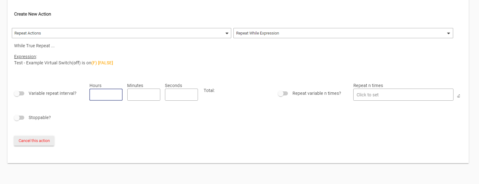

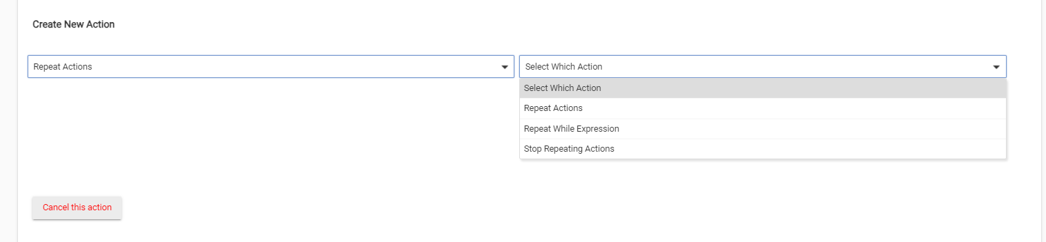

To begin I am going into RM and choosing Repeat While Expression

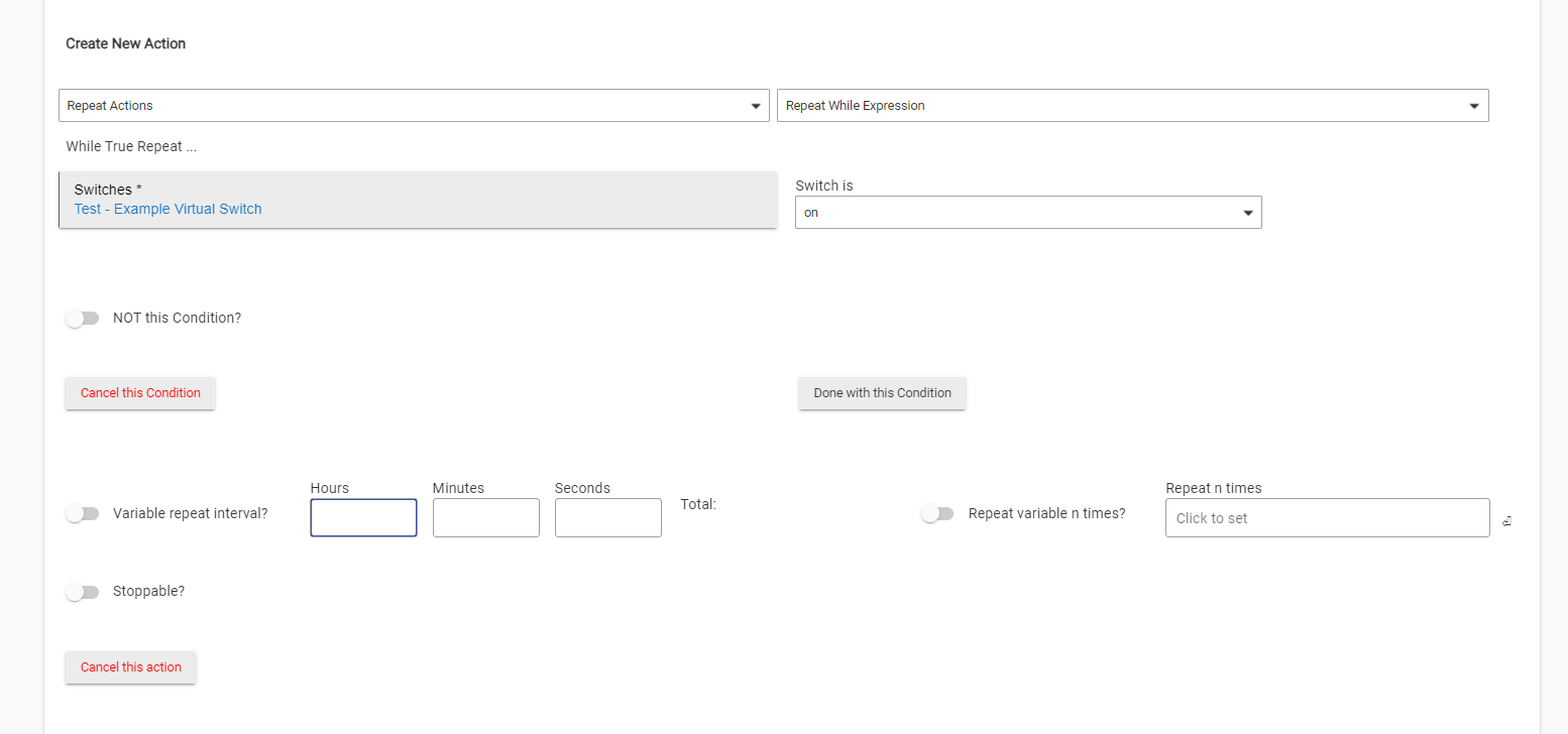

I then indicate the switch that needs to be on in order for the rule to repeat (while)
I dont understand the next stage, it then asks me to specify the number of repeats I want using n or the time period before it repeats again (I think) - neither of which I want, but the UI insists on this. I dont feel like I should need to know how long it takes to run my rule before it begins again which is what I think the first one is asking for?
My only option is to either cancel or go back into the rule from scratch, if I go in from scratch the rule I was just trying to create is missing.
If I go to create new action
It then remembers I was part way through the rule but keeps insisting on the number or the duration
I feel like I have really misunderstood how to use this.

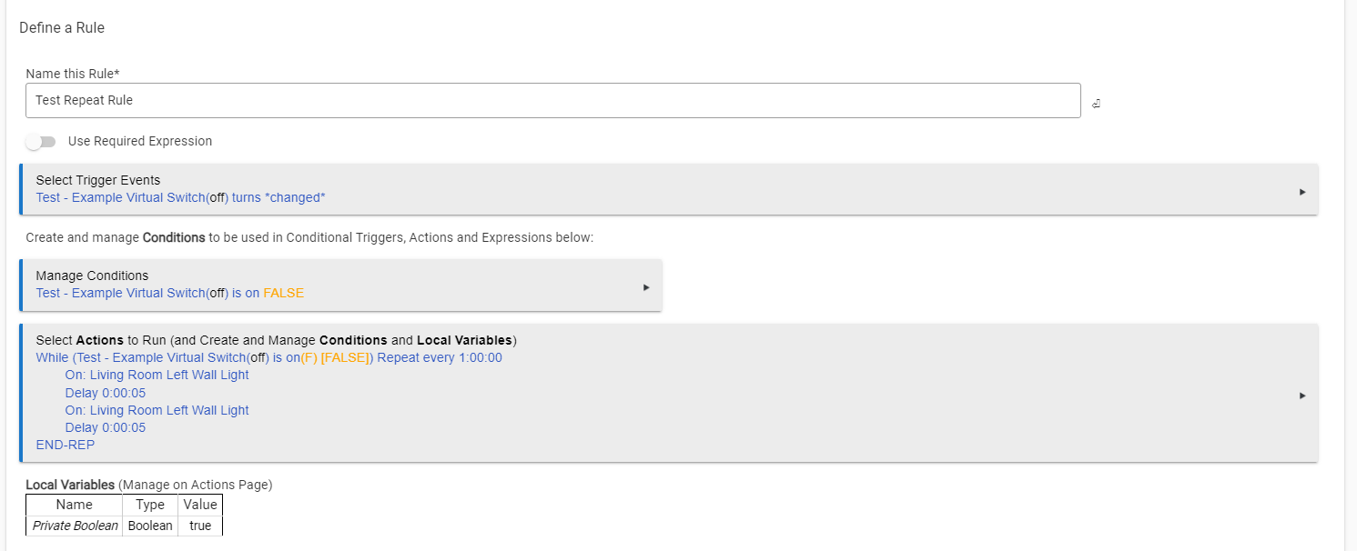

But I cant even complete the first stage unless I specify the number or duration, if I do then I can make it run like this
But how do I just get it to start my rule when I turn my switch on, repeat it and only stop it when I turn the switch off again?

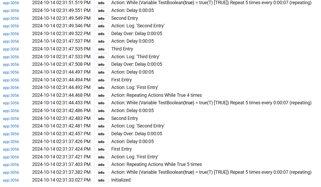

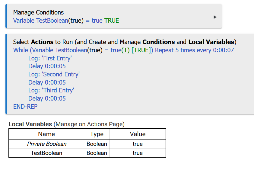

The repeat is not dependent upon the amount of time it takes for the actions within it to run. It'll execute as often as the interval you define. Here is an example where the repeat is 7 seconds but the actions take 15. You can see that the repeat is repeating faster than the actions can occur. The First Entry log of the second repeat is happening before the Third Entry log of the first repeat.
If you could setup a repeat without an interval the repeats would happen so fast (likely milliseconds apart) that it would either be useless or cause you system to overheat.
