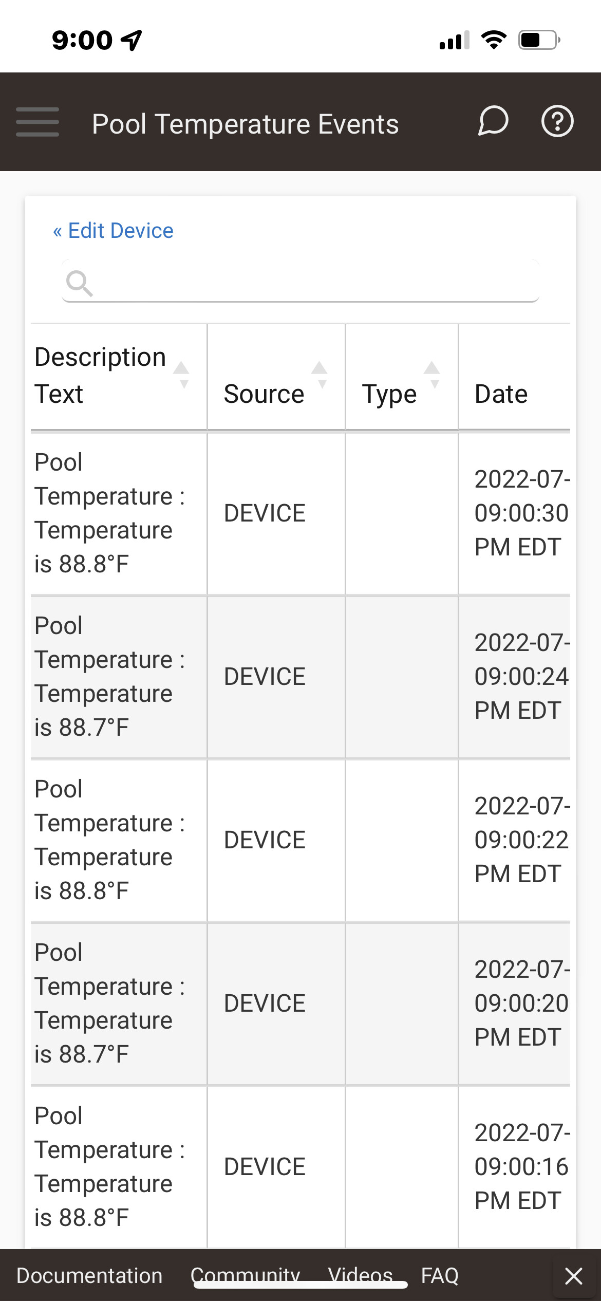

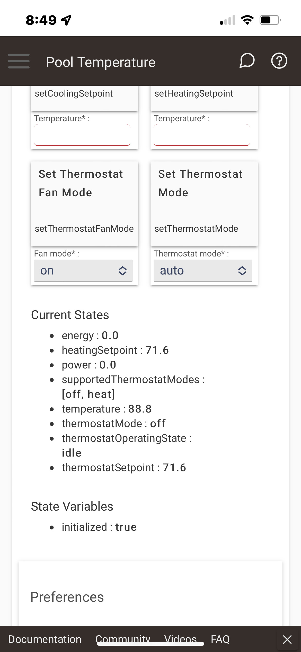

Is the temperature changing every two seconds? Can you post a screenshot of the device page? Iām not familiar with this device.

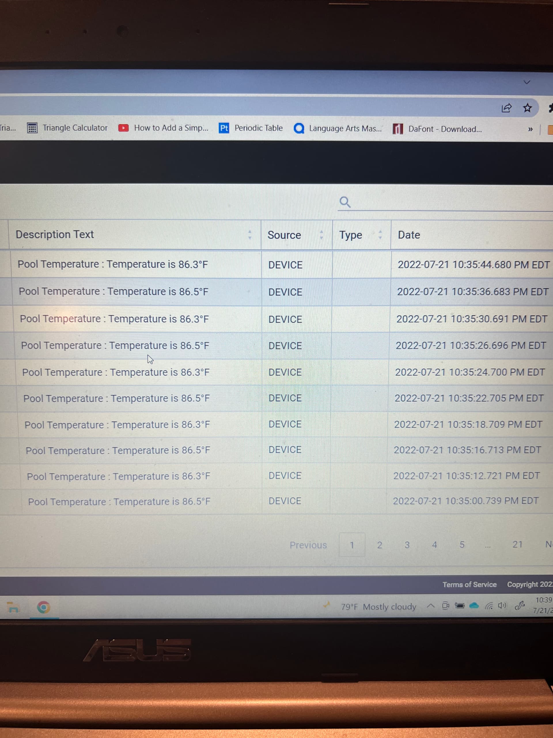

Could you post a snippet of the event log showing temperature reporting every 2 or few seconds?
Youāve configured to report only on a change of 0.5 degrees F, so it should not be reporting that frequently.
Got it!
Can you change the report to be >0.5F? Like 5F? And post logs from when you do this change. So we can see if the qubino responds?

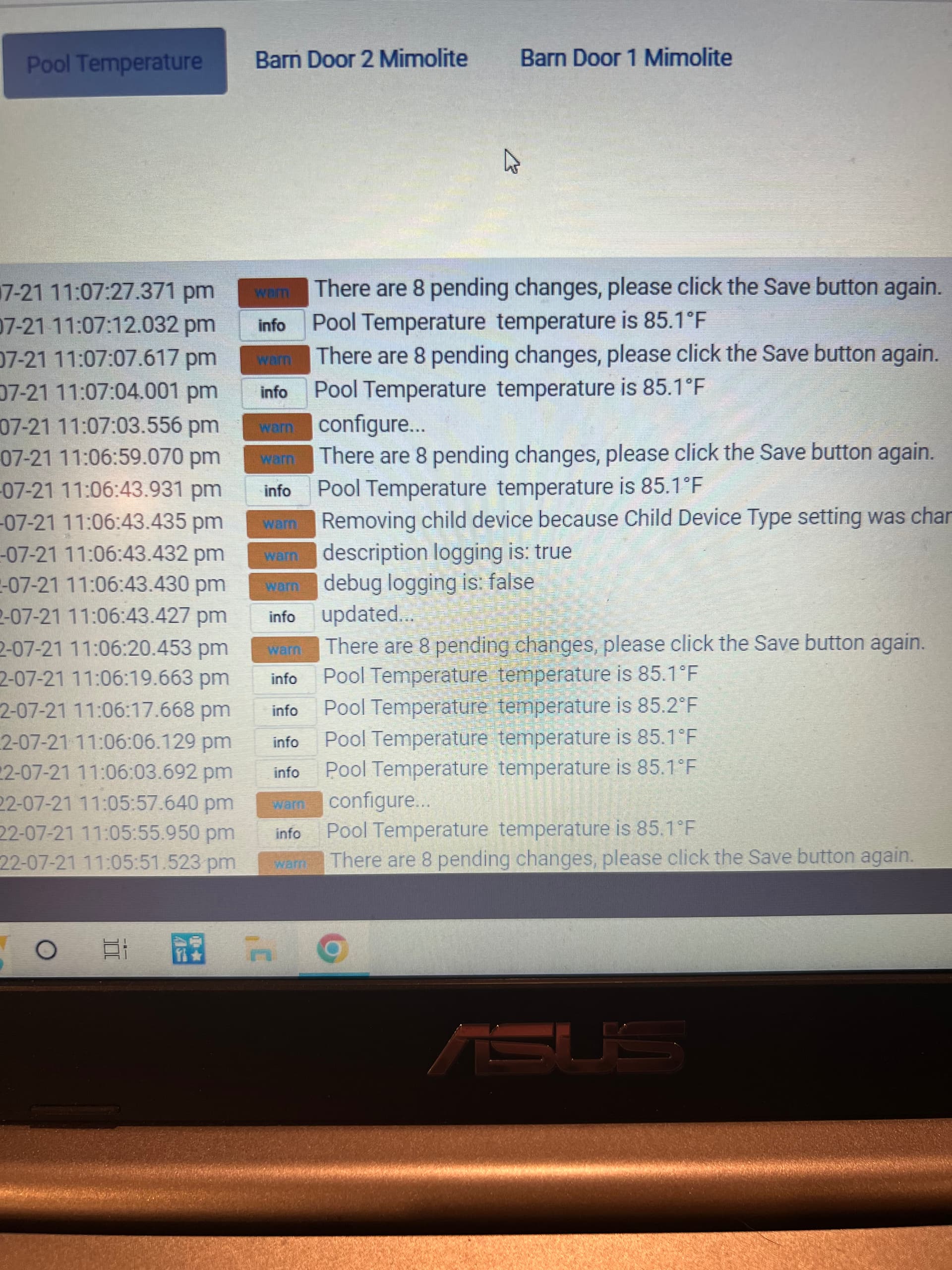

Under Commands, have you selected Configure?
That maybe the answer. I changed it and it hasnāt reported anything yet. Thank you, Iāll keep an eye on it.
As @pseudonym suggested, click on the Configure button. That device is misbehaving.
Can you confirm using logs that the device accepted the configuration change you did?
See those pending changes - you need to wake the device for them to be applied.
Dumb question, how do I wake it?
It should be in the manual for the device.
And let's hope "remote" isn't too remote and it doesn't require a button hold
