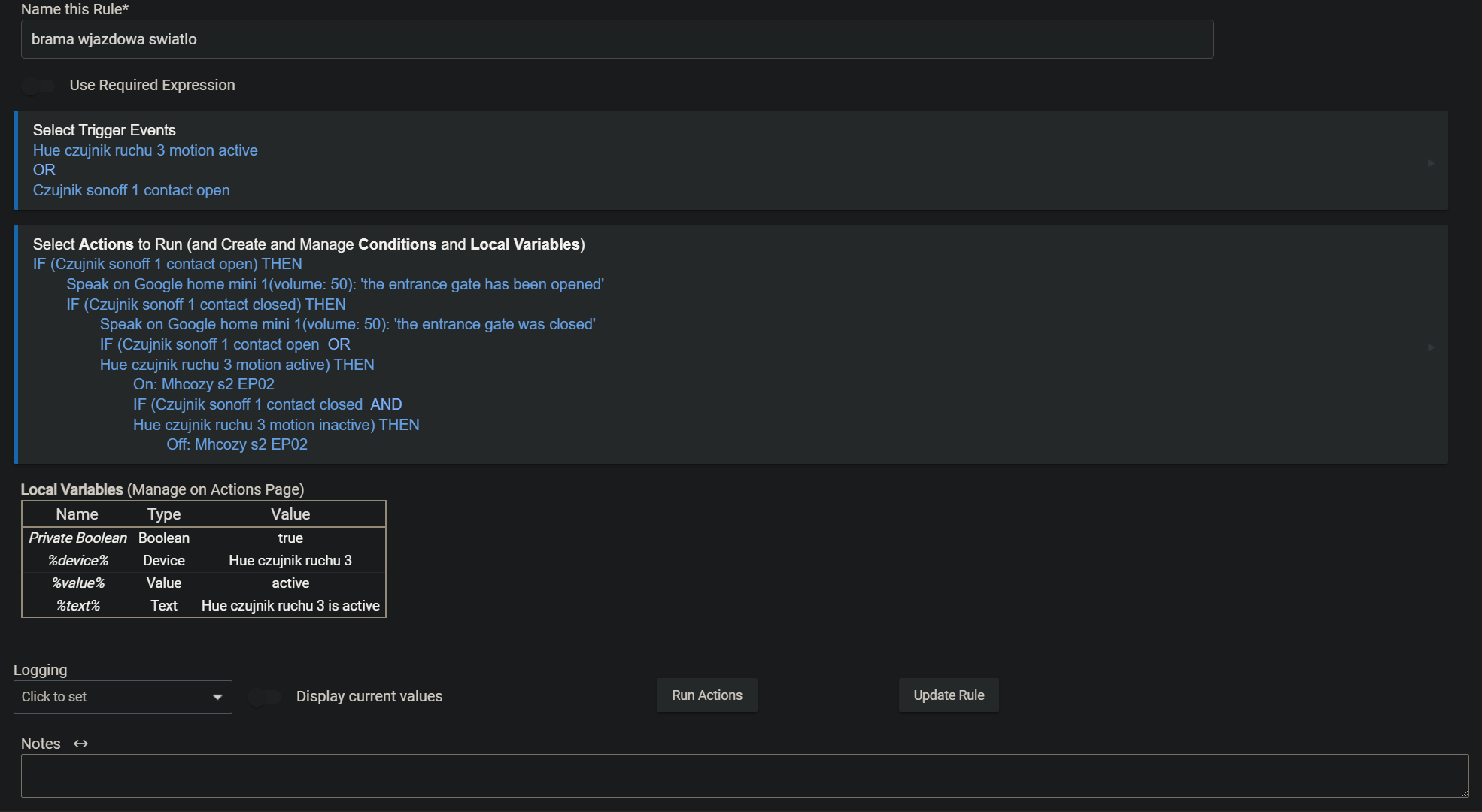

hello everyone. I have a problem with rule machine. I'm doing it for the first time but it seems to me that it should work in this form as in screenshots
when gate contact sensor is open - google home speaks (gate open)
when gate contact sensor is closed - google home speaks (gate closed)
when gate contact or motion sensor is active / open - turn on lights
when gate contact and motion sensor is inactive/close - turn off lights
I don't know why it doesn't work. google home only informs about the opening of the gate and not about closing, and the lights do not turn on when the gate is opened

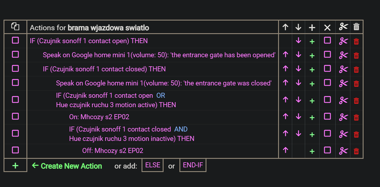

Can you post the whole rule including triggers? I suspect that's where the issue lies.
Also... each IF/THEN needs an ENDIF.

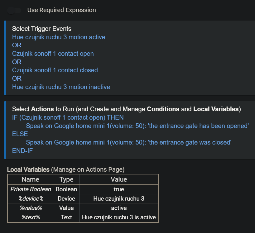

Do you mean this?
That helps... not sure why the funky colors.
So here's part of the problem... your rule triggers when the contact switch opens. But if the contact switch closes the rule doesn't get triggered. Same with the motion sensor - triggers on activity but won't trigger on inactivity.
And then there's the endif issue.

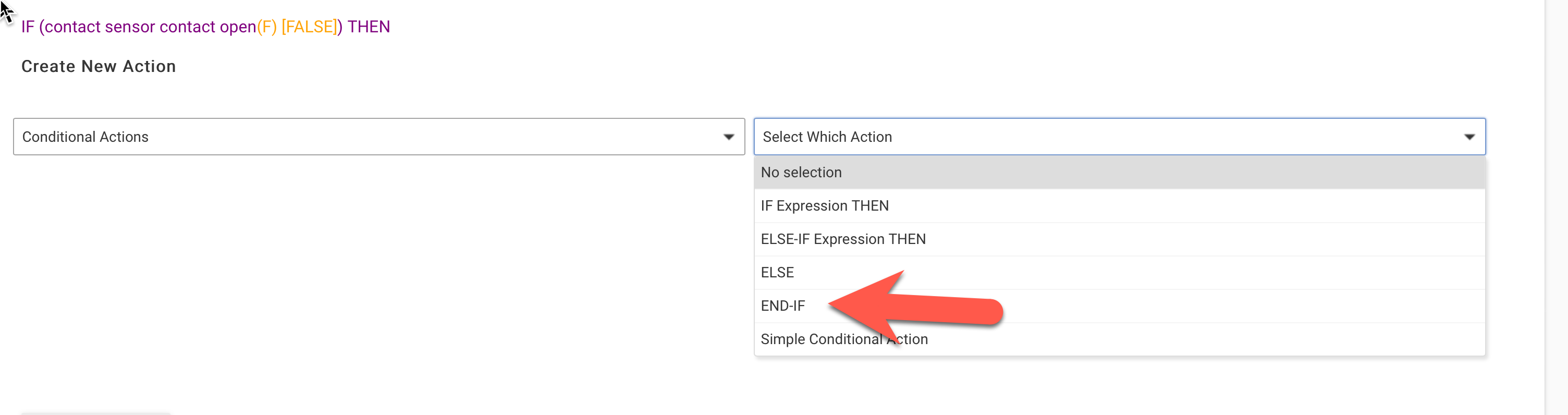

The ENDIF is a conditional statement you can add as an action... screen shot below.

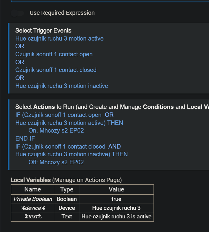

Understand. I split it into two rules and it works now. I'll post ithere, maybe it will help someone else.
Thanks for help
Looks better! FYI you're still missing the last ENDIF in the first rule. Probably won't affect the rule running but my OCD is all over it.
To make your rule cleaner, I'd change the triggers to
Hue Czujnik ruchu 3 motion *changed*
OR
Czujnik sonoff 1 contact *changed*
Your second posted rule will announce "the entrance gate was closed" when the motion goes active or inactive. From your first post, I don't think that is what you want. I'd remove the motion sensor as a trigger.
