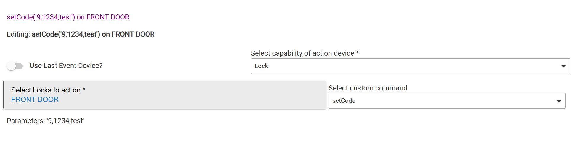

For the life of me I can't figure out what I'm doing wrong. I've used Maker API and webhooks to set door codes remotely with zero issues. I use the generic Z-wave lock driver.

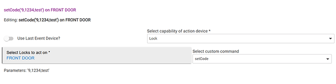

All I want to do is use Rule Machine to set a lock code on one of my doors. I'll be using variables later on but I can't get the most basic command to work. I want to set a code in position 9, code 1234, and the name Test. I've tried this every which way as you can see in the logs there but I keep getting the same error message displayed. Here's the rule I set up and I've tried this adding ' ' around the code and the name, adding " " around them, adding spaces, no spaces, etc. etc.

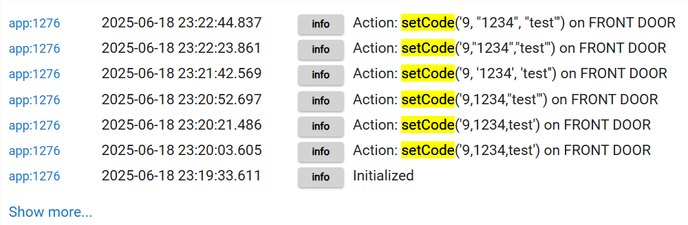

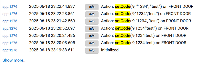

Here are all the variations I tried:

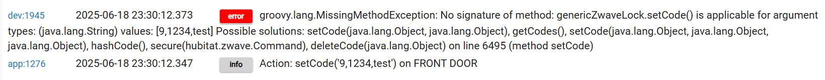

And here is the error I get with every single one of them:
The setCode method requires three parameters, are you just sending one?

No, I was sending all three: position, code, name. I tried it in every conceivable (I thought) configuration of those three, as you can see in the log here:

Ahhh, oh wait I finally get it. I had to add a number parameter separately and then two string ones separately. Once I did that they just showed up as looking exactly the same as if I entered a single string parameter with the three components, i.e. ('9, '1234', 'Test').
