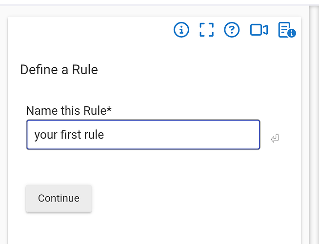

To create a rule click on RM in the app list. You'll get this type of response.

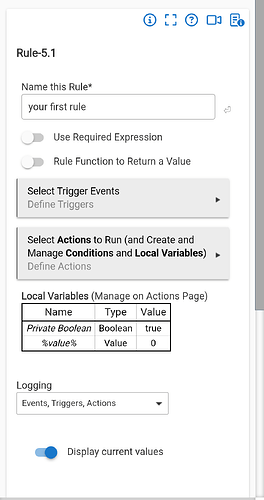

Enter your Rule name and then select the Continue button RM wi) create your first rule and you'll get this response.

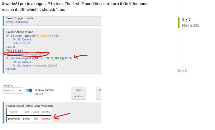

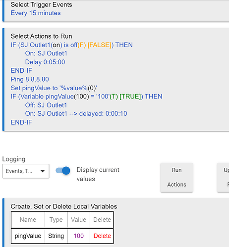

This is the rule from the linked post.

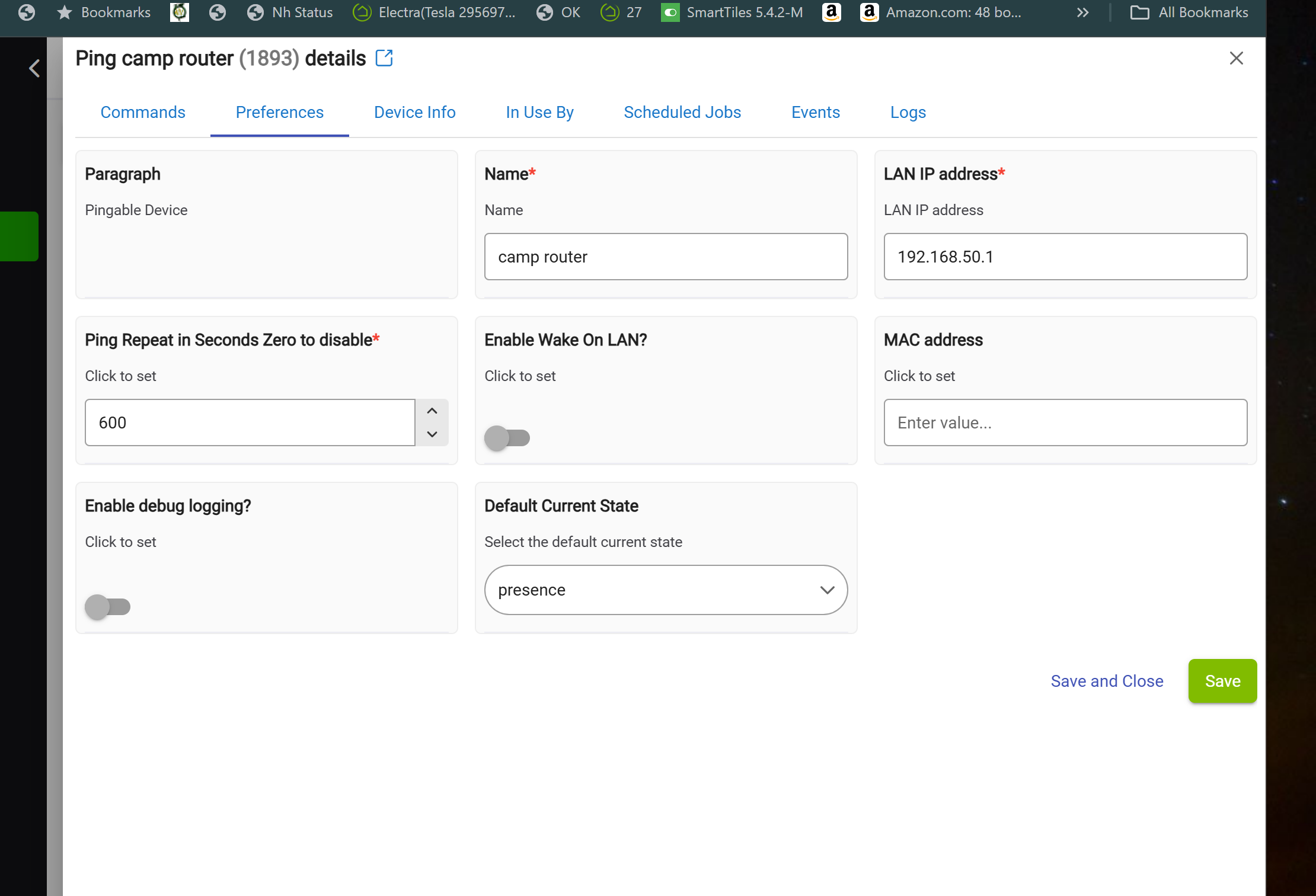

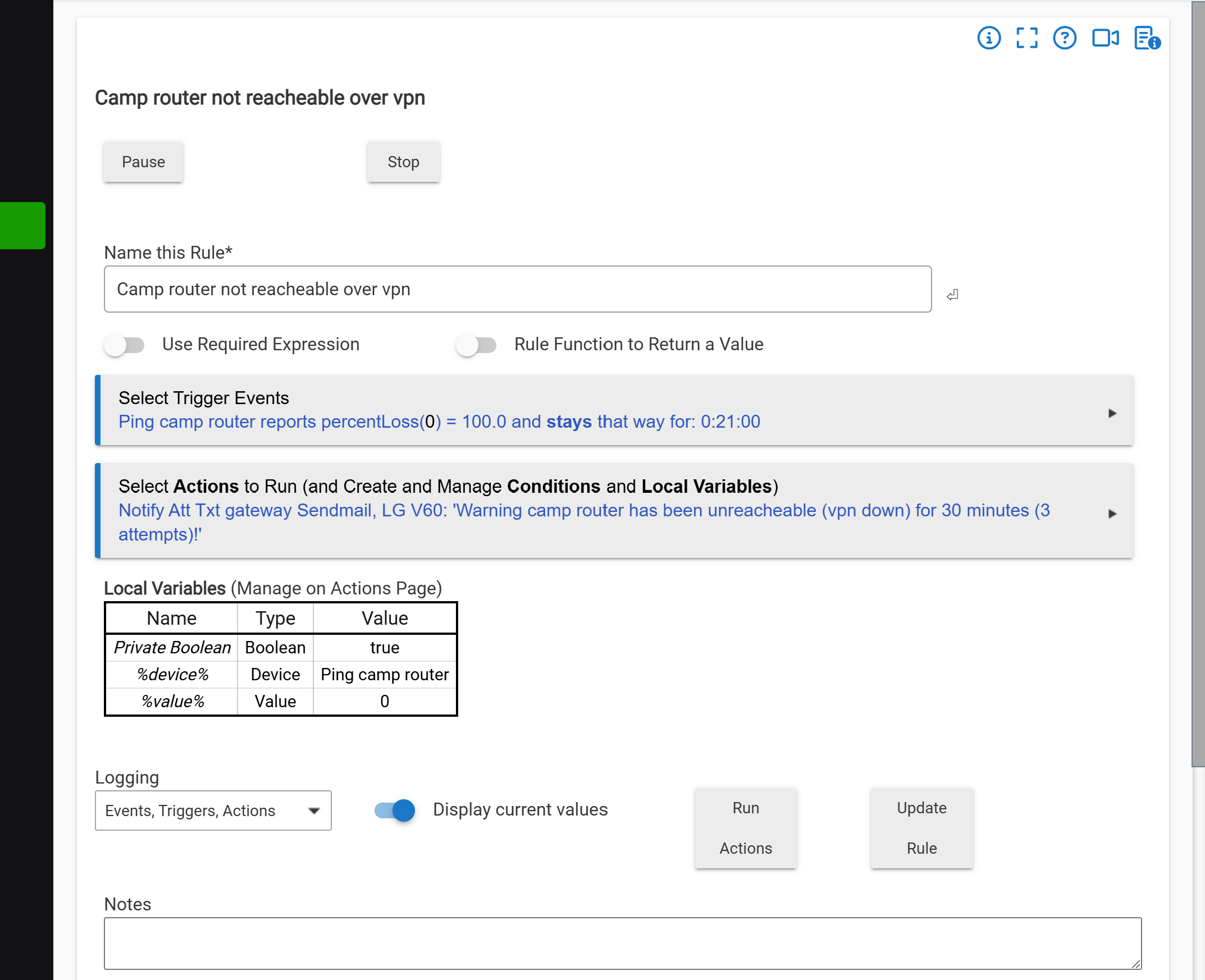

i would not write it this way why wait 10 minutes. i would use the ping app and write a separate rule that says if ping missed maybe 2 or 3 pings ie down for 20 minutes or a half hour. off/on immediately.
ie
just use the ping device that way can set it to more that one errant ping.
replace the notification i have with off, on delay say 10 secs. to get it to go off then on..

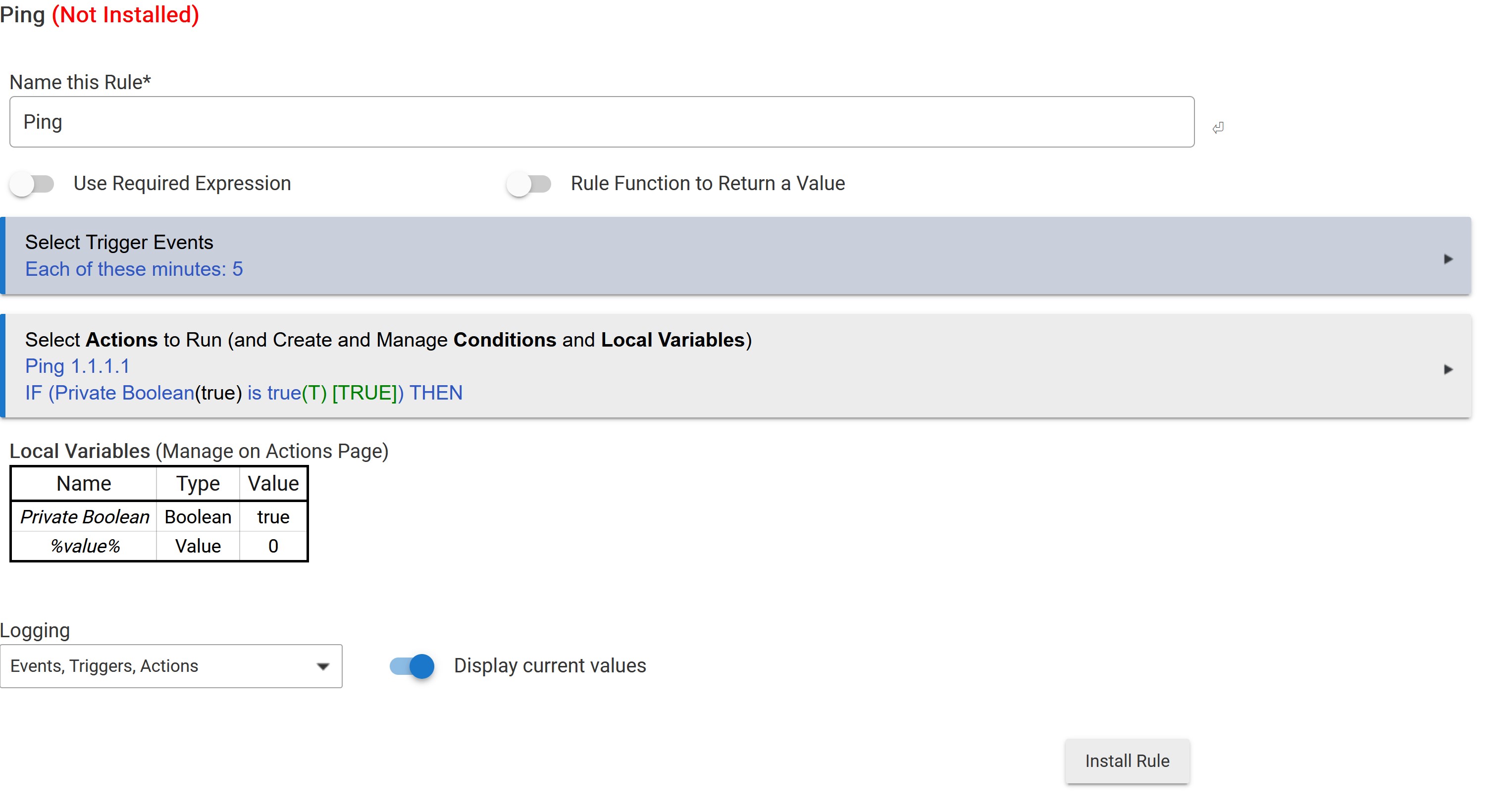

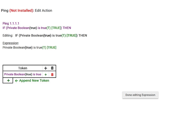

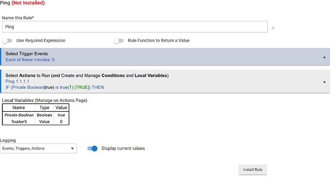

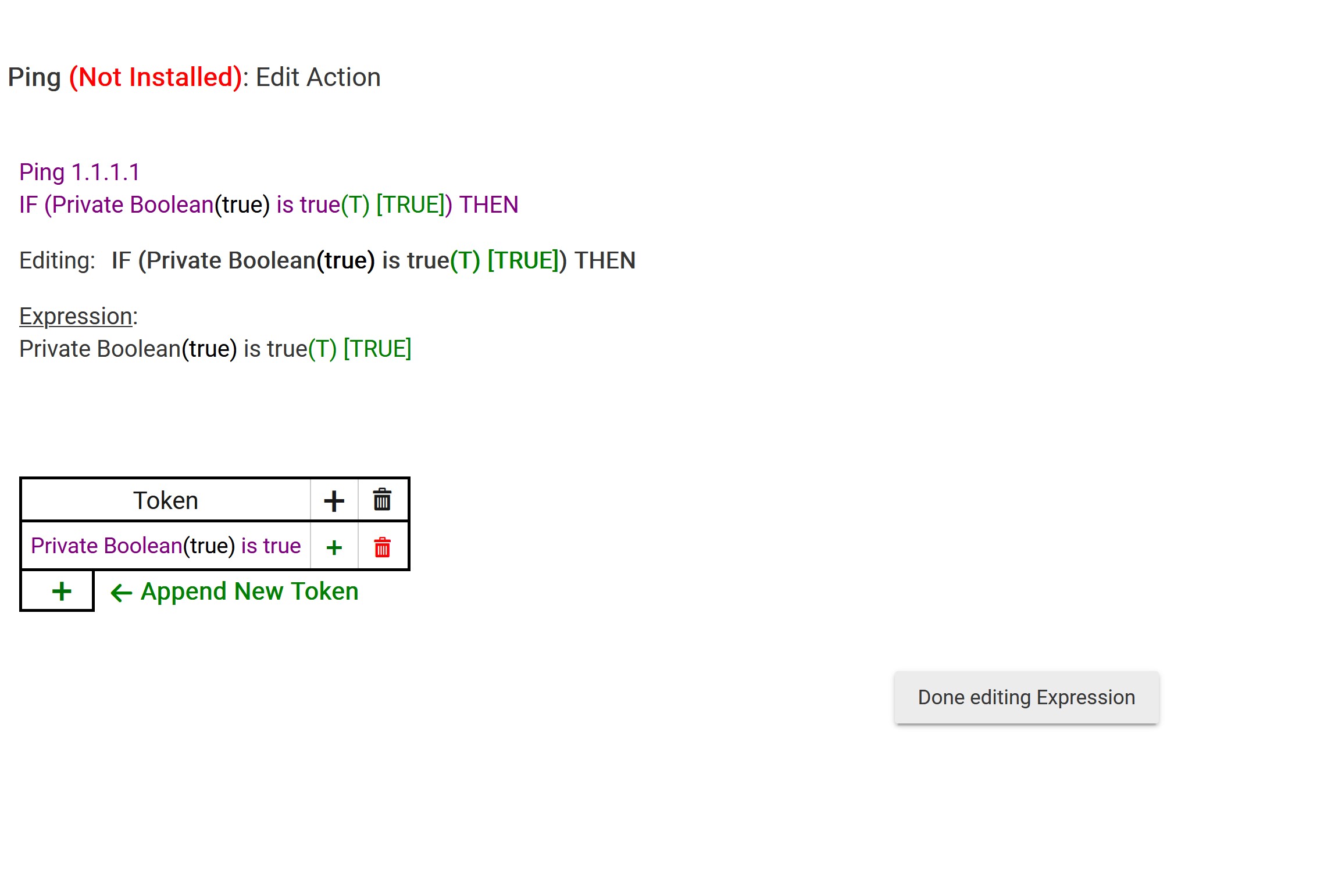

I can get started, but I'm lost after the Ping step. I can't figure out how to set the Ping variable and all that follows. Here's a screen shot of what I have. My trigger looks a bit different, but I can't find a way to match the example.
Here's a screen print of the original, which I'm not trying to copy exactly, but I think is close to what I'm after. The circled and arrowed bits are the ones I can't figure out how to find and incorporate in RM.

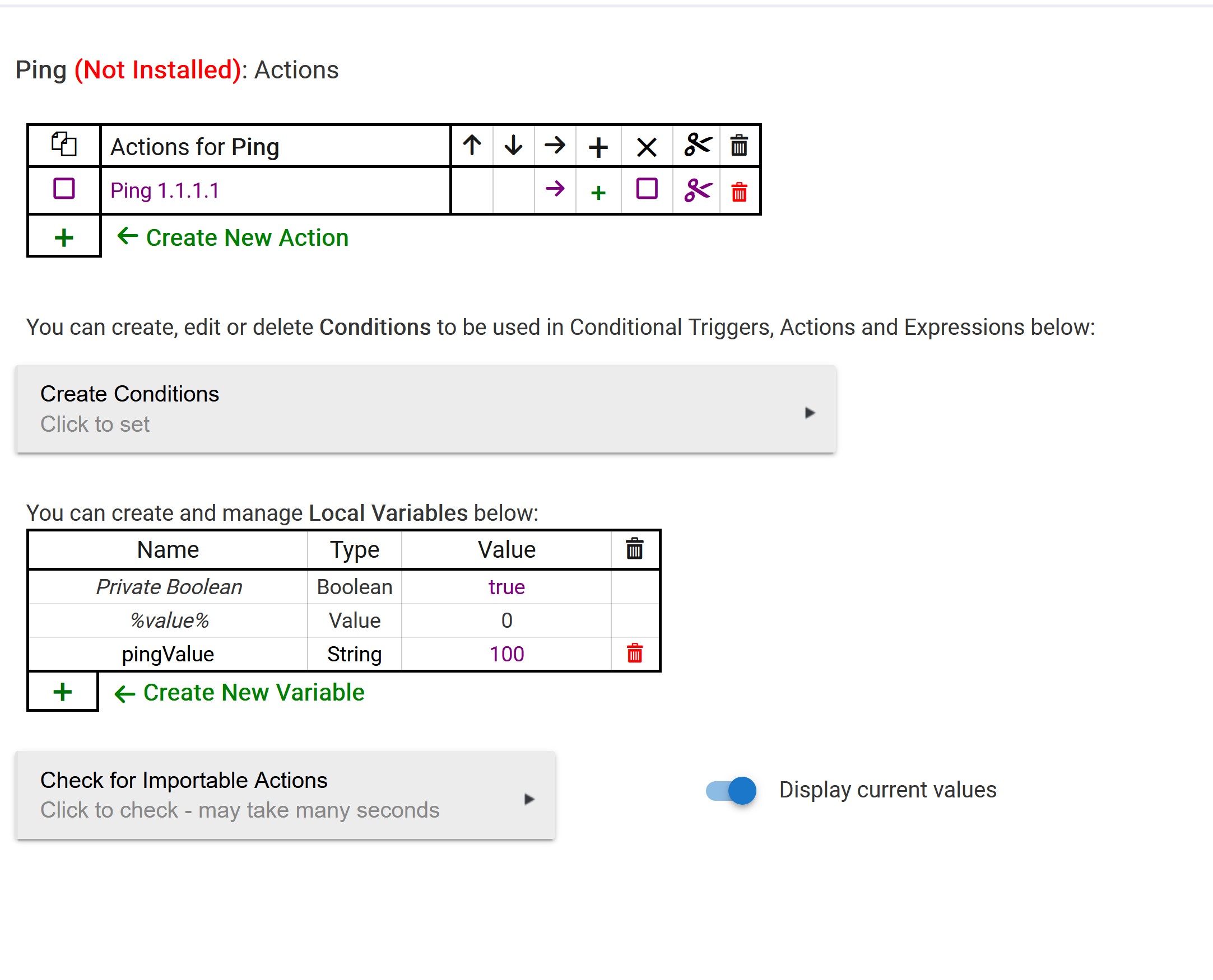

First create a string variable.
You'll need open the Action list The Variable list is at the bottom. Click on the green+ sign to create a string variable.
Progress. Hadn't been able to find that on my own. Now seems obvious. I'll do some more poking around and see where I end up.

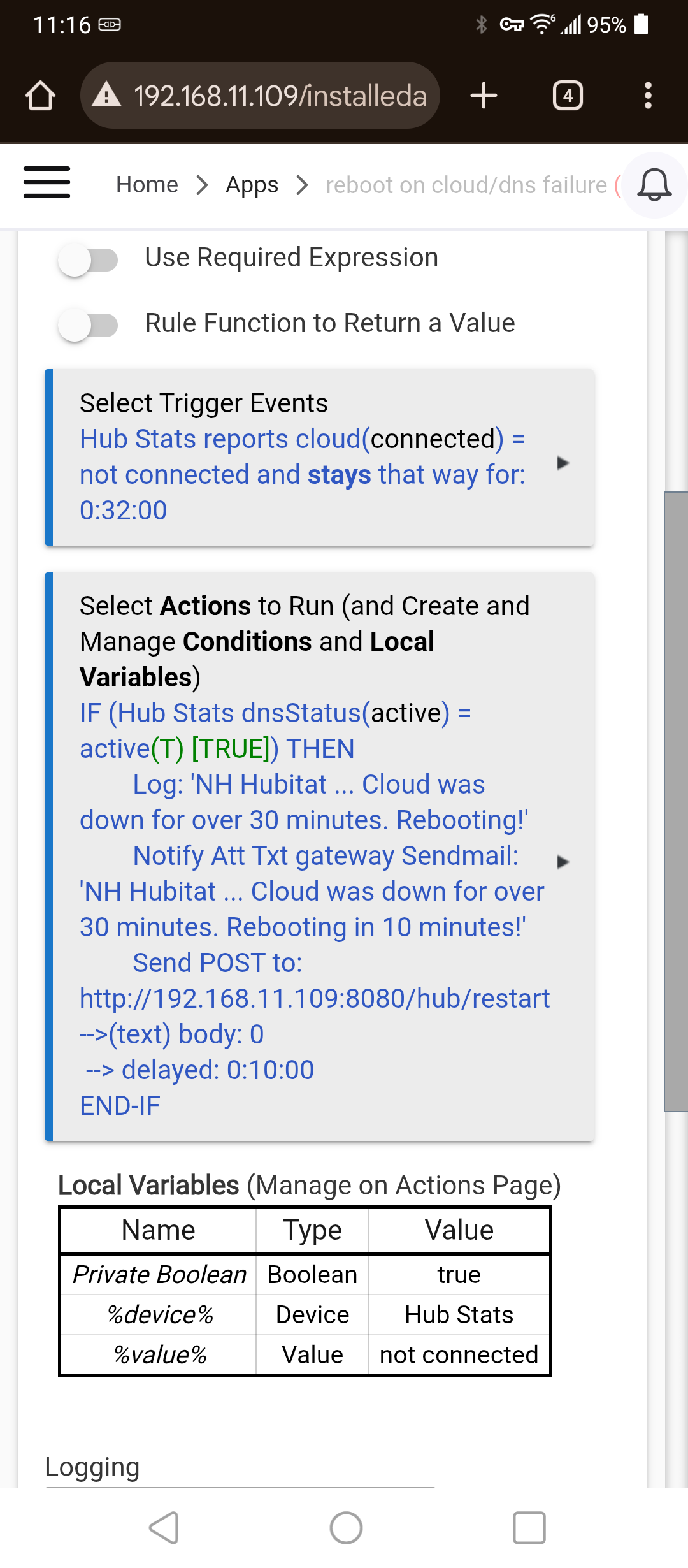

I have a RM scripts that runs once a week at 3 am;
Send POST to http://192.168.0.11:8080/hub/reboot
Simple

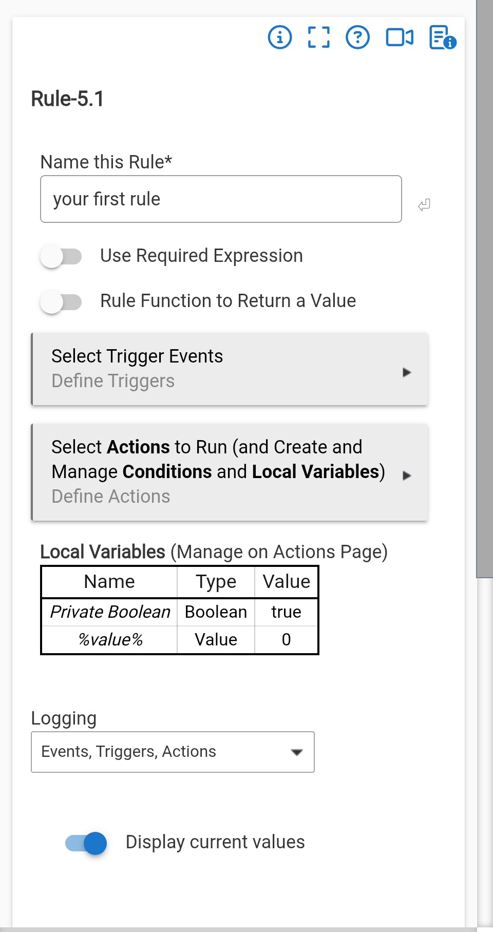

I'm having the exact same issue as the OP, but while it seems like they've given up for now, I am struggling to continue myself. Can you please help me? This is also my first rule in RM, and also relatively new to Hubitat. How do I set the variable, and what variables are needed to accomplish this same task as OP. I can set the "PingValue" to 100, but not sure where to go from there. How do I set "PingValue" to %value%? How does any of this equate with a ping failure? Can you please step by step this for me, like your talking to a newbie to all this? And for what it's worth, I'm usually pretty tech savvy, but this I just cannot figure out for the life of me. I've already spent 8 hrs now today trying to figure this out :frowning:

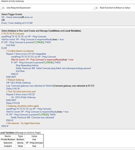

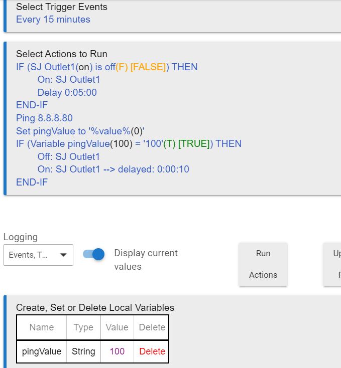

This is my rule to reboot when the internet it down.
How do I add photos so I can post what I have so far? It keeps saying I can't add embedded media to a post...
I've essentially gotten the actions listed above by JimB, at comment 3/16 ... will that work as intended? I've got it setup temporarily with just a light bulb to test with, so I don't turn off my actual modem until I know it works... but also I guess I won't know until a ping fails
Once you have tested your rule on a light, then create the actual rule to toggle the router power.
You can test that rule by disconnecting the Internet from the router. Make sure that you have logging turned on in the rule before the do the test.
Suggest that you check the log right after you disconnect the*Internet

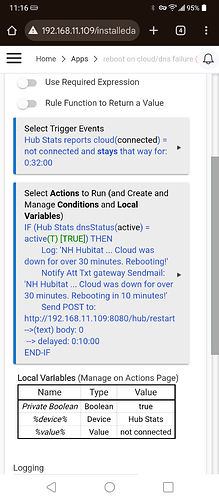

My rule is a bit simpler. Using hub info driver.
It reboots if cloud connection is down..
