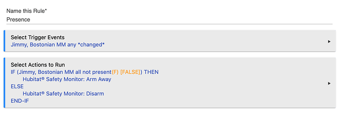

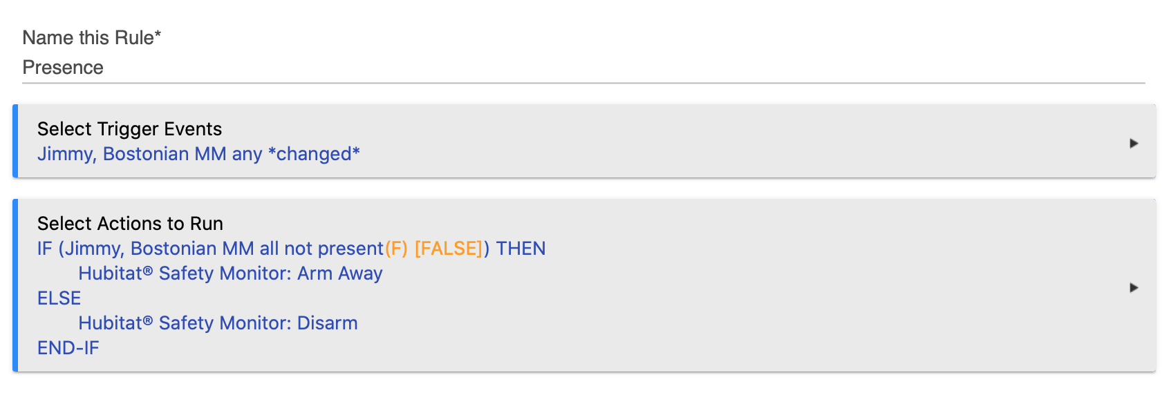

This is my suggestion, others may chime in. As was said on Monday - KISS. To keep it simple, a virtual device is not needed (Jimmy and Bostonian MM and physical presence sensors):
If you also use "Arm Present" additional logic may be needed but this is simple if you just use Arm and Disarm.

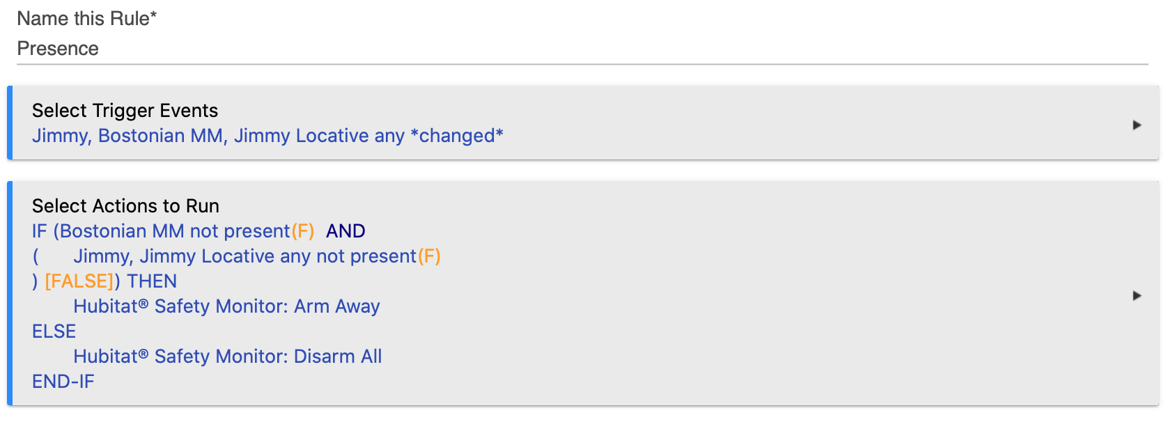

Ah! Got it now. Sorry for the misunderstanding. I would think the app sensor is the right solution here, but you still can achieve what you are doing with two physical sensors and no virtual sensors. (BostonianMM is my wife's sensor and both Jimmy and JimmyLocative refer to my sensors).
Don't get me wrong, nothing wrong with using virtual sensors and I use them for other things. You will achieve the same result. It's just more complicated.
The key thing is the two presence sensors for me are inside of parenthesis and setup as an OR logic test while comparing that result against my wife's presence sensor.

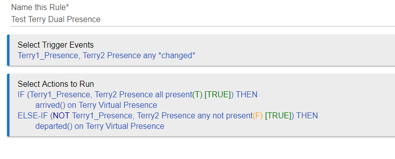

@tgrant48 I'm sorry. I looked again at the rule I posted and it would not work for your use. It should be something like:
If all are present> virtual device present
Else-If any are not present> virtual device not present
I tried this, but it doesn't work. I can't seem to wrap my head around RM yet.
I think you need to get rid of that first 'NOT' in the ELSE-IF. ( Not not present would be the same as present)
Not even sure how I got that in there but taking it out made it work perfectly! Thanks!
