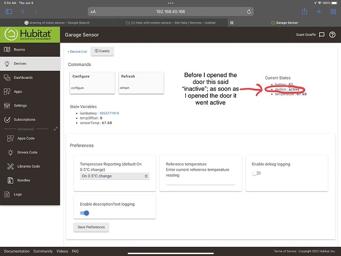

Ok, This morning I brought up my device on the ipad in the hub and it said “inactive”, as soon as I opened the door, all the light went on and the motion sensor changed to “active”
The only problem, the switch from inactive to active did not show in the events page
The last time any “motion” show in the events page was June 6th,
What is going on?

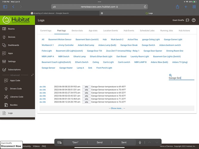

It looks like you have descriptive loging on - do the motion active/inactive events show in the logs? Can you post a screenshot of the latest logs (and events)?

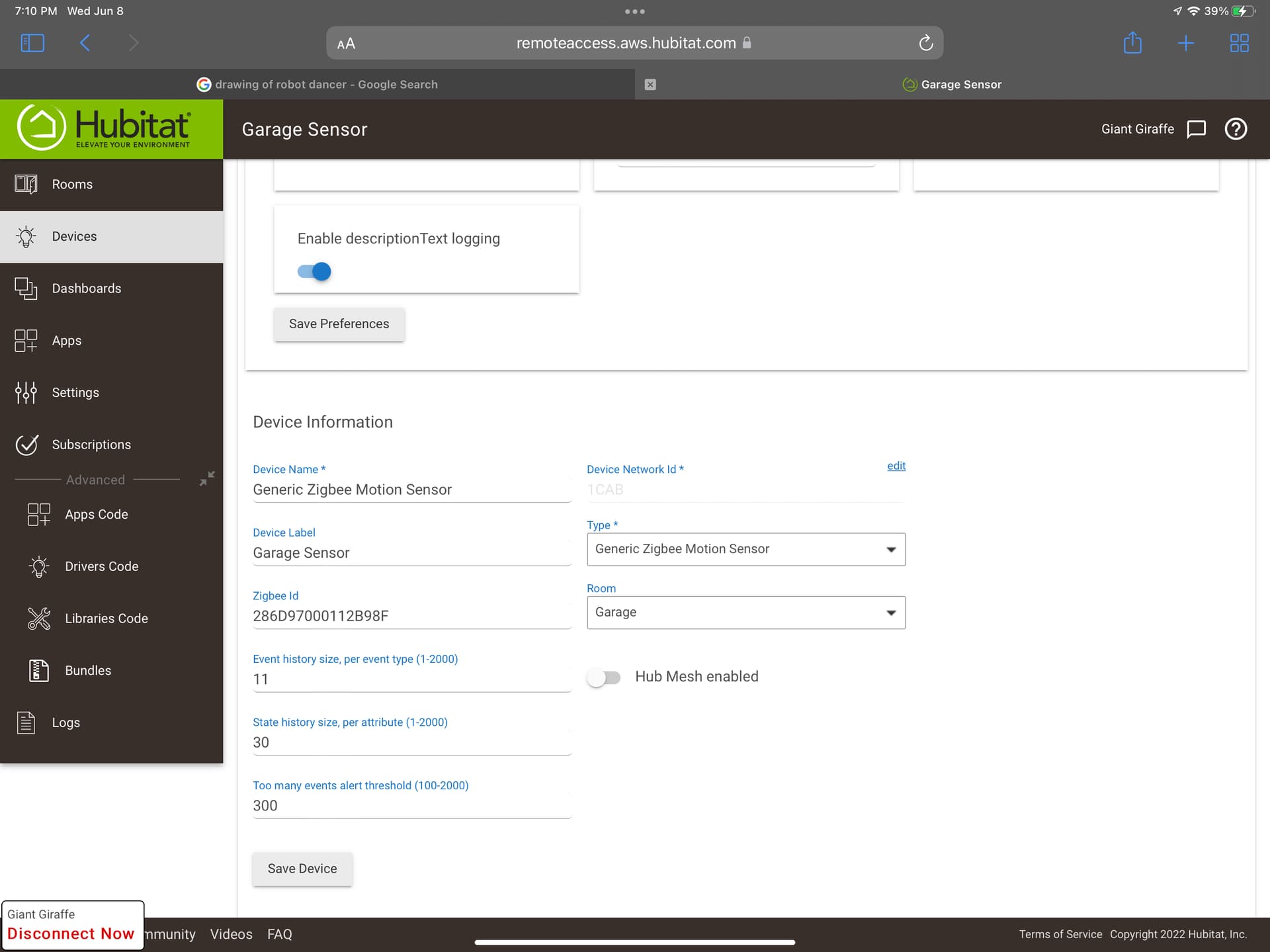

Weird...besides the above, what driver are you using? This is under "Type" on the device detail page. I'm also curious what you have for "event history size," but that should at least give you one event with the minimum value, and the most recent one at that...
