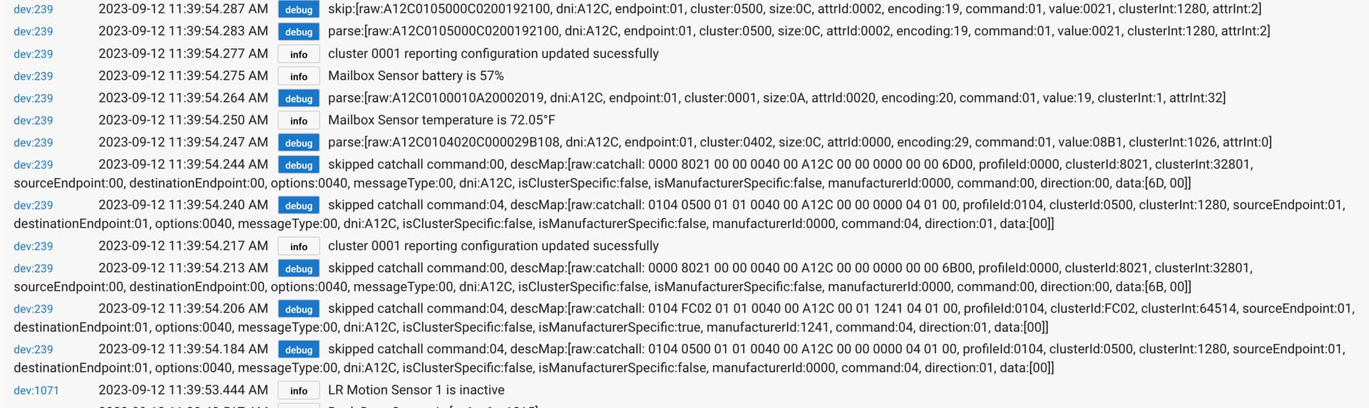

I stopped receiving notifications and went to the logs. Here is what I found.
Can someone help me figure out what the problem is? Thanks.

Notifications app. I performed a Configure from the device page and now it seems to be working OK. I might have already fixed the problem. I just shook the mailbox and received a notification, plus the logs show no debug error now.

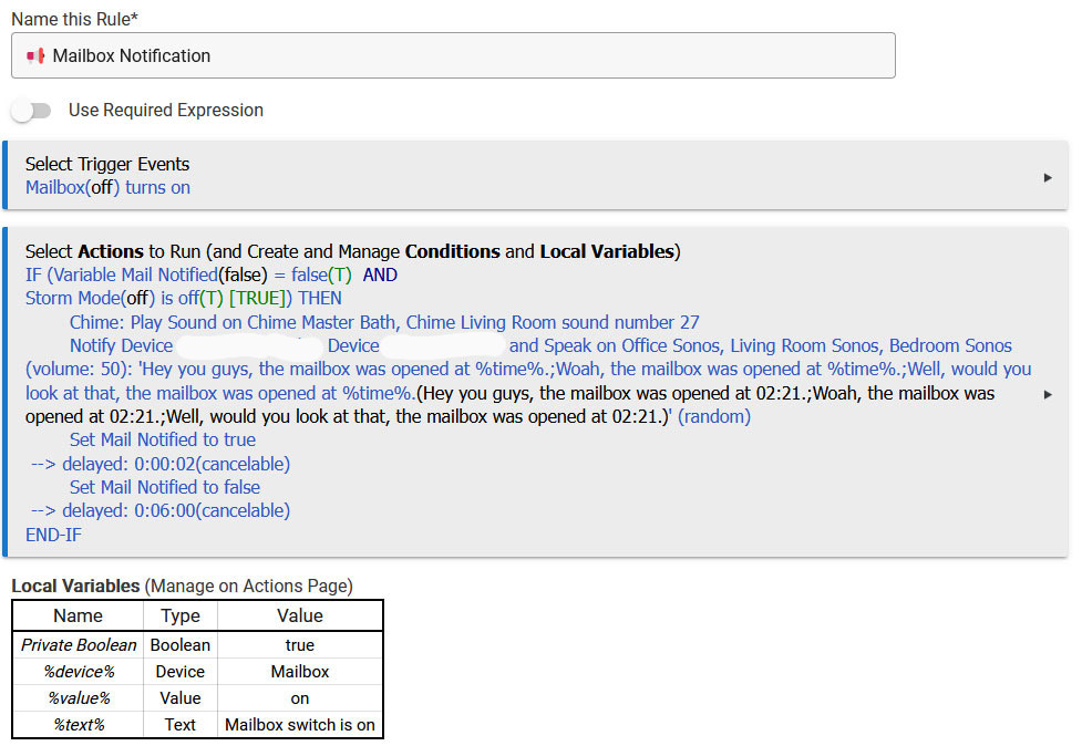

I think RM will serve you better. I have a more complex mail notifier that has worked fantastic. My problem is the mail box is more than 1000ft from the house. So I use a micro switch in the mail box and the dry contact sensors on a Dakota Alert Doorbell UTRE-4K Plus that get the signal to the house. The Dakota alert at the house also has dry contact sensors and it is connected to a Zooz Z-Wave Plus ZEN16 to get the signal into Hubitat. This is my RM rule. Lighting will sometimes set off the Dakota Alert that is why there is a Storm Mode check...

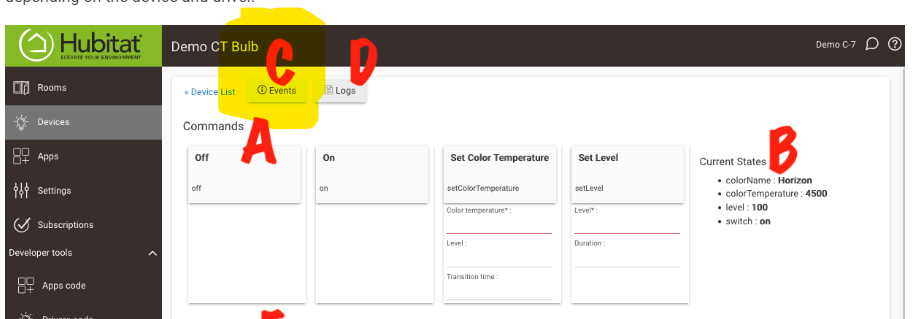

What does your Device Events look like when the mailbox opens?
