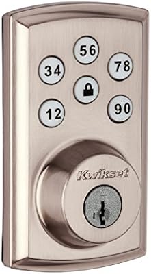

I have just bought the elevation controller and converted my first home device to be able to control it from afar. It is a kwikset z-wave lock. I was able to pair it and see the device but am only able to open and close the lock on the device panel of the portal. I just get a ? on the dashboard. What app or controller do i use to be able to control it from my phone? I thought i was tech savvy but not with this. thanks for the help anyone.

On a side note, I have to say that I had HORRIBLE experience with Kwikset zwave locks on Hubitat. I ended up swapping out the comm module in them for a zigbee comm module. Hopefully you have better luck with yours...
As a side note, I have a Kwikset Smartcode 888 (zwave plus), and I've had no issues with it.

So, I have the Kwikset deadbolt and locking door handle. Both of them configured as "Generic Z-wave Lock" and they work pretty much perfectly. I have buttons in dashboard that work fine, and they even integrated with Alexa without issue. I have a smartcode 914 and a 912.
I had the older non plus versions on the last house with SmartThings, and they never worked right. They also ate batteries like crazy, and they never reported their battery charge accurately. Sometimes I would only get 2 weeks on a set. But these have been in for about a month now, with no problems, and the batteries still look like they have a lot of juice if the reporting and driver section of Hubitat are to be believed.

I have the Kwikset Smartcode 888, zwave plus, using the Generic Zwave Lock:
