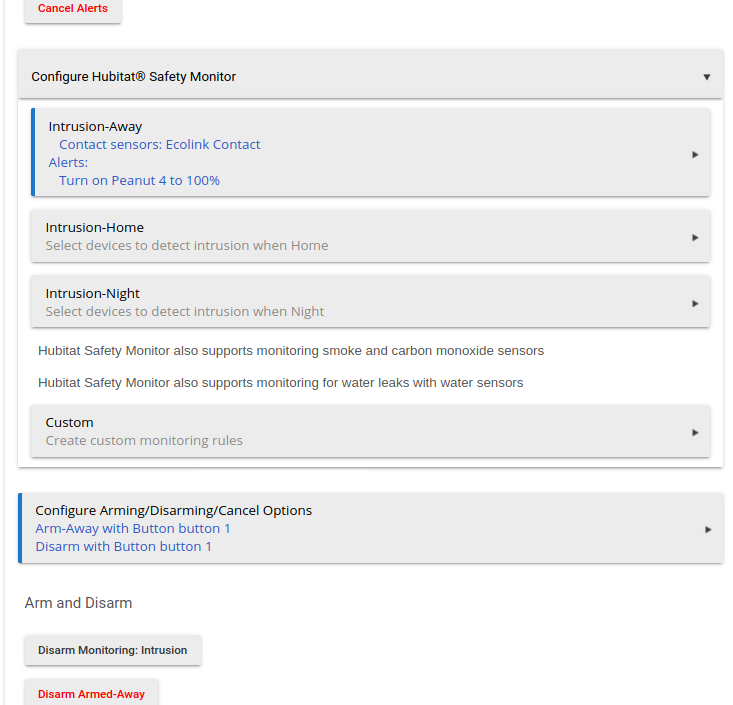

In HSM, playing around with this as well, I am able to use the button to ARM the system. However it seems to only allow a single press. I don't see the options I see in RM to use doublepress/hold. I wonder if it's by design or if I'm missing a setting somewhere.

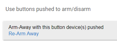

Use buttons pushed to arm/disarm
"Arm-away with this button(s) device pushed"
I may have a gap in my knowledge for button vs button device.
Can you screen shot your trigger events? For your rule
HSM only supports using pushed nativly in HSM. If you want to use any other button action you have to set up a rule in Rule Machine.
See, it says "pushed" right there. Push is the only capability that is common to ALL buttons. Having double tapped or held isn't common to all button devices.

You can use rule machine to do this also if you want to use a different action. All of the controls of HSM are available in Rule Machine.
