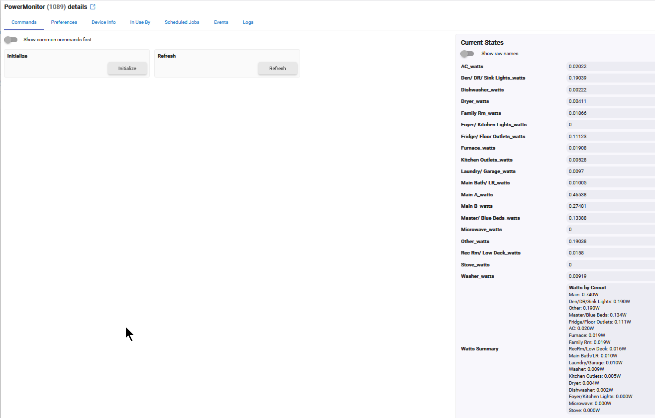

sorry to answer my own question...but with a little (OK, a LOT of help) from chatGPT I was able to get a driver working with Hubitat... and read all the values into Hubitat
still learning about this device and not quite ready to recommend...stay tuned... but the price is really really good @ $129.
I got the driver working correctly and the data matches the app screen..... Still have a few questions out to the company....but here is the device page

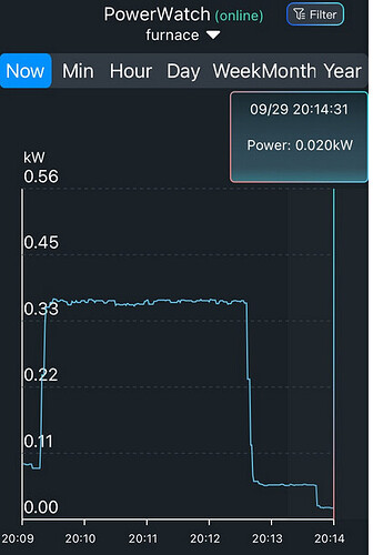

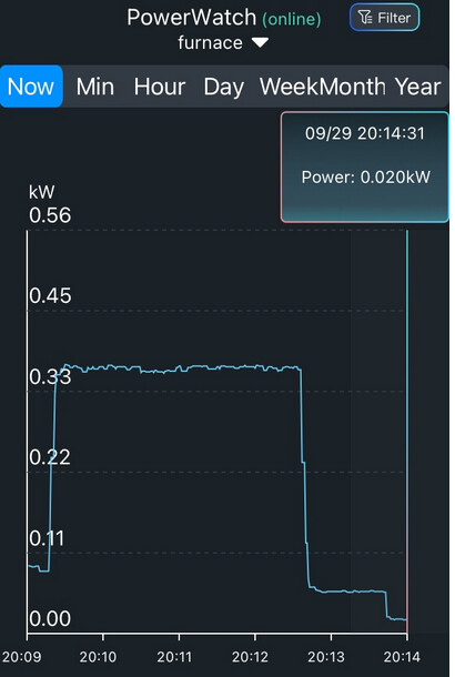

Here is a picture of the power changing when I switched our furnace fan from HI to Auto
