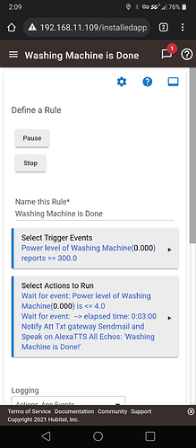

Have this rule to let me know when the clothes are clean. The washing machine is connected to a Zooz Zen15. Thanks to @marcusvrsilva for the idea.
This works but when the clothes are soaking, there is no power consumption so the message is sent. The message should be sent only after the clothes are clean.
Was looking in the rule for wait 10 minutes for no power or something like that but this old man brain couldn’t figure it out. Please don’t use words like boolean. My brain is taxed enough keeping the WAF manageable.

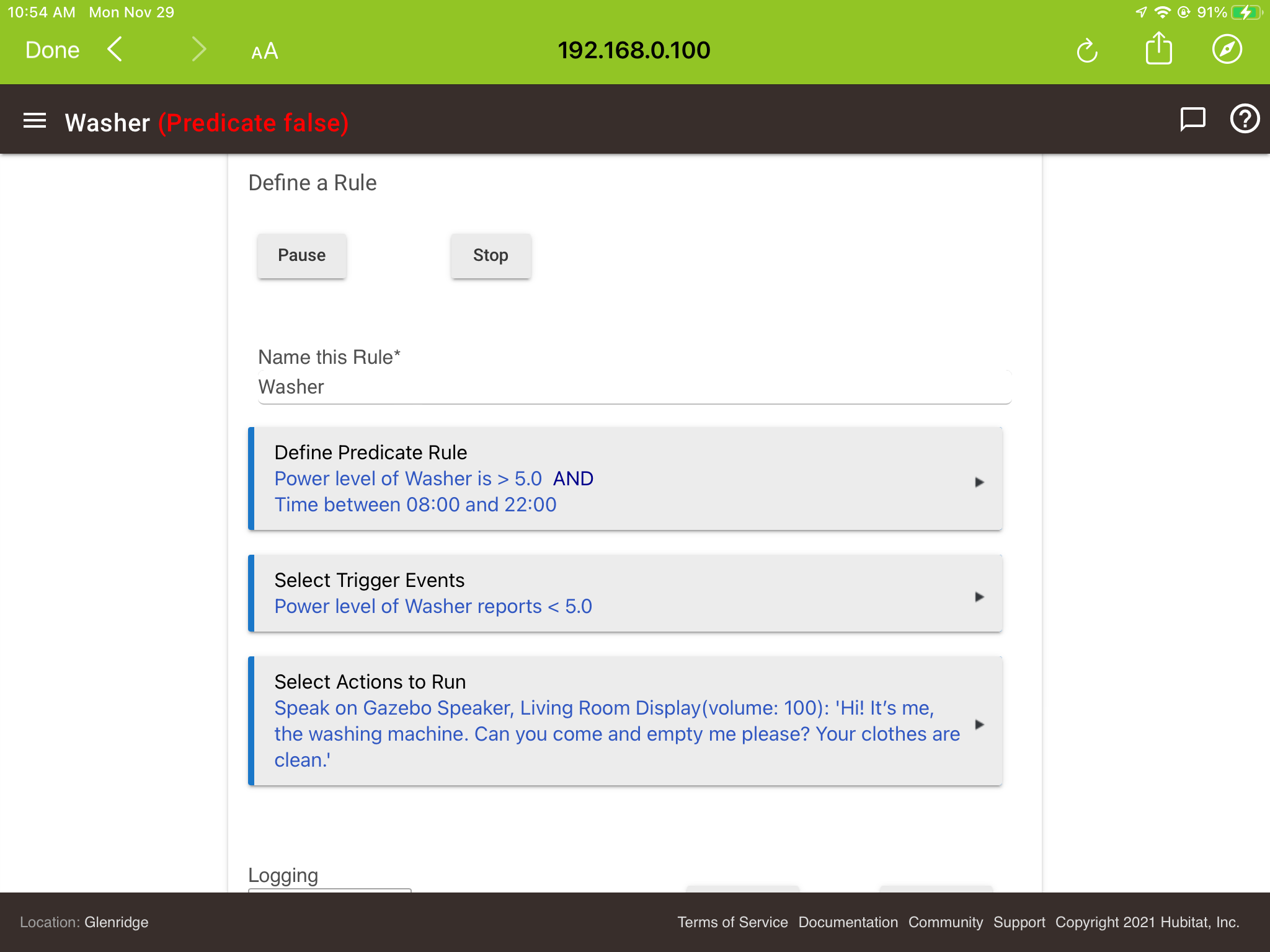

You could use a Wait for rule with a duration and it will wait until the power stays below a certain level for a specified amount of time.
Did you try one of the various community laundry done/monitoring apps? They account for soak cycles.
Here is mine with same device. Should work fine if you adjust power and times for your washer.
