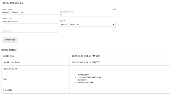

Hi Krishna,
Could you post a screenshot of the device page for both locks please? The part I would like to see to debug this issue is under the "Device Details" section toward the bottom of the page.

Sure, here is the Back Door Lock which works most of the time:
Here is the Front Door Lock which is the problem:
Does this help?
Yes, tremendously.
Notice how your backdoor lock has paired securely? In the data section it says, "zwaveSecurePairingComplete: true"?
Your front door lock has not paired securely. Hence you cannot control it with Hubitat (locks and garage door openers must be paired securely to the z-wave controller).
Here's the larger issue. During secure z-wave pairing, the controller uses a low power radio mode (sometimes called whisper mode) to reduce the possibility of snooping. So secure devices have to be paired directly (and very close to the controller). Even though the distance might seem the same to you, your front door lock is unable to pair securely.
