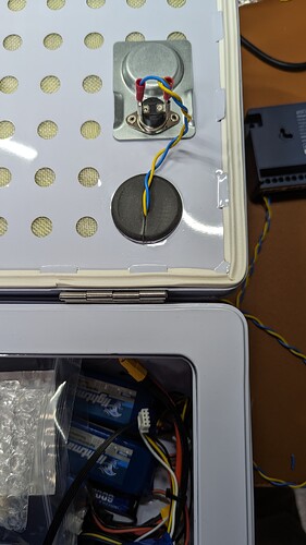

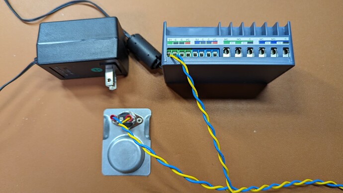

So my solution is to use a Zooz Universal Relay S2. It allows me to use two inputs and gives me two relay outputs to Hubitat. I use a 12vdc wall wart to power it and that means there is only 12v going into the battery compartment and all electronics are outside including the transmitter. With the i4 I would need to have 120vac to the temp contacts in the box. And I doubt it's rated for that anyway. So I like this a lot better.
The temp sensor I'm using is a dry NO contact. I would prefer a NC contact so an open circuit would alarm, but no big deal.
The contact will not show up as a "switch" or any type of input in the Safety Monitor App, but they do show up as contacts in Simple Automation. So I created a virtual switch in SA and had the contacts activate the virtual switch and that switch as an alarm input and notification input in safety Safety Monitor App.
When the switch sees 120F it closes and Hubitat instantaneously sees the closure and alarms through safety monitor. I'm getting a phone text within five seconds.
I have two inputs, but if I wanted I could run multiple switches in parallel to add additional switches on each input circuit.
The only down side is the S2 is pretty large and takes up more space than I would like on my workbench. But I'm very happy with the results so far. I would have attempted to get the i4 working since it's so small but I really didn't like the 110 in the box going to the contacts and associated hardware and safety problems.
There you go. Let me know if you have any questions and THANKS for all the ideas in this thread folks. I really appreciate your time investment.
