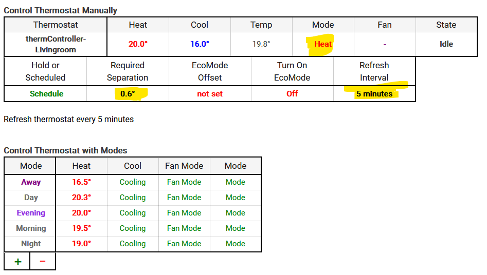

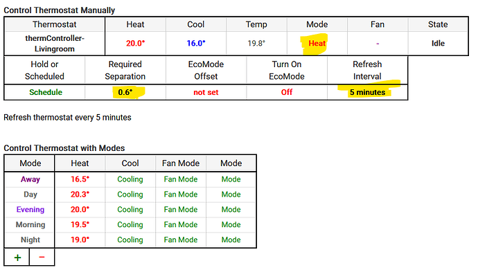

  1. Mode Manager:

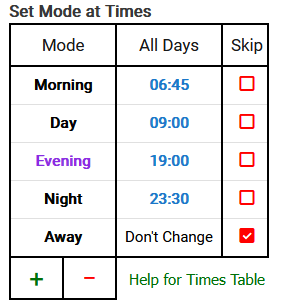

  2. Thermostat scheduler:

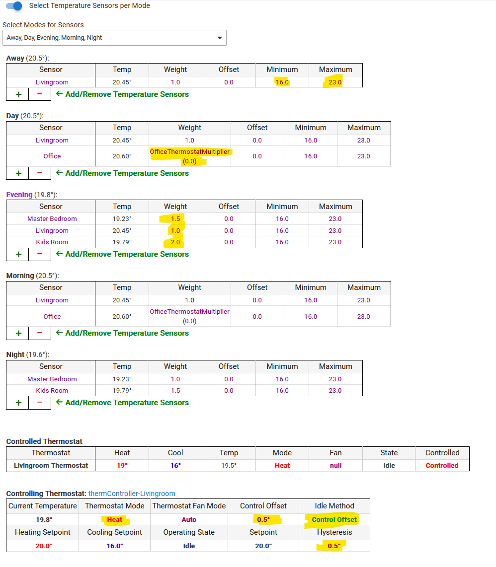

  3. Thermostat controller:
    a. It has temperature sensors in each room named as the room, so literally 'Master Bedroom' instead of 'Master Bedroom Temperature and Humidity Sensor'.
Hoping to get some feedback for improving this and mainly resetting the office multiplier on inactivity (i am thinking of a train's dead-man switch or what's the name?). So, if i don't press the switch for say 60 or 90 minutes, the multiplier goes to 0 (no heating).

app:4972025-10-25 13:40:01.399info
Livingroom Thermostat heating setpoint set to 19.8
dev:2792025-10-25 13:40:01.391info
Livingroom Thermostat Heating setpoint changed to 19.8
app:4442025-10-25 13:40:01.155info
SetThermostate() Mode: Heat; Heatsetpoint: 19.8; CoolPoint: 16 API Response: 200
app:4442025-10-25 13:37:07.039info
Honeywell API Token Refreshed Succesfully, Next Scheduled in: 1699 sec
app:4972025-10-25 13:35:09.772info
Livingroom Thermostat setting to idle by setpoint below temperature
app:4972025-10-25 13:35:09.770info
dev:2792025-10-25 13:35:09.762info
app:4442025-10-25 13:35:05.797info
app:4972025-10-25 13:30:01.581info
app:4972025-10-25 13:30:01.579info
dev:2792025-10-25 13:30:01.567info
app:4442025-10-25 13:30:01.288info
app:4972025-10-25 13:26:35.410info
app:4972025-10-25 13:26:35.408info
dev:2792025-10-25 13:26:35.398info
app:4442025-10-25 13:26:35.160info
app:4972025-10-25 13:26:33.327info
Office temperature = 20.88°, Average sensor temperature = 20.7°
app:4972025-10-25 13:26:33.235info
Controller: setTemperature(20.7) was called
dev:3042025-10-25 13:26:32.970info
dev:1702025-10-25 13:26:32.920info
Office pressure is 99.8kPa
dev:1702025-10-25 13:26:32.874info
Office temperature is 20.88°C
dev:3102025-10-25 13:26:04.739info
Livingroom pressure is 99.8kPa
app:4972025-10-25 13:25:01.436info
app:4972025-10-25 13:25:01.432info
dev:2792025-10-25 13:25:01.424info
app:4442025-10-25 13:25:01.180info
app:4972025-10-25 13:20:10.938info
app:4972025-10-25 13:20:10.935info
dev:2792025-10-25 13:20:10.924info
app:4442025-10-25 13:20:10.708info
app:4972025-10-25 13:20:08.791info
Office temperature = 20.86°, Average sensor temperature = 20.7°
app:4972025-10-25 13:20:08.708info
dev:3042025-10-25 13:20:08.441info
dev:1702025-10-25 13:20:08.401info
Office pressure is 99.7kPa
dev:1702025-10-25 13:20:08.382info
Office temperature is 20.86°C
app:4972025-10-25 13:20:01.265info
app:4972025-10-25 13:20:01.263info
dev:2792025-10-25 13:20:01.255info
app:4442025-10-25 13:20:01.034info
app:4972025-10-25 13:18:23.004info
app:4972025-10-25 13:18:23.001info
dev:2792025-10-25 13:18:22.991info
app:4442025-10-25 13:18:22.765info
app:4972025-10-25 13:18:20.960info
Livingroom temperature = 20.71°, Average sensor temperature = 20.7°
app:4972025-10-25 13:18:20.856info
dev:3042025-10-25 13:18:20.591info
dev:3102025-10-25 13:18:20.555info
dev:3102025-10-25 13:18:20.533info
Livingroom temperature is 20.71°C
app:4972025-10-25 13:15:12.003info
app:4972025-10-25 13:15:12.001info
app:4442025-10-25 13:15:11.778info
dev:2792025-10-25 13:15:11.135warn
Livingroom Thermostat Set heating point failed, attempting a refresh and re-try.
app:4442025-10-25 13:15:11.130error
java.net.SocketTimeoutException: Read timed out on line 679 (method setThermosatSetPoint)
app:4442025-10-25 13:15:01.049info
app:4972025-10-25 13:10:54.075info
app:4972025-10-25 13:10:54.073info
dev:2792025-10-25 13:10:54.065info
app:4442025-10-25 13:10:53.849info
app:4972025-10-25 13:10:52.447info
Office temperature = 20.78°, Average sensor temperature = 20.8°
app:4972025-10-25 13:10:52.329info
Controller: setTemperature(20.8) was called
dev:3042025-10-25 13:10:52.064info
dev:1702025-10-25 13:10:52.006info
Office temperature is 20.78°C
dev:1702025-10-25 13:10:51.999info
app:4972025-10-25 13:10:01.232info
app:4972025-10-25 13:10:01.230info
dev:2792025-10-25 13:10:01.222info
app:4442025-10-25 13:10:00.895info
app:4442025-10-25 13:08:47.297info
app:4972025-10-25 13:07:57.576info
app:4972025-10-25 13:07:57.574info
dev:2792025-10-25 13:07:57.567info
app:4442025-10-25 13:07:57.341info
app:4972025-10-25 13:07:55.517info
Livingroom temperature = 20.75°, Average sensor temperature = 20.8°
app:4972025-10-25 13:07:55.405info
dev:3042025-10-25 13:07:55.132info
dev:3102025-10-25 13:07:55.058info
dev:3102025-10-25 13:07:55.036info
Livingroom temperature is 20.75°C
app:4972025-10-25 13:05:03.372info
app:4972025-10-25 13:05:03.370info
dev:2792025-10-25 13:05:03.362info
app:4442025-10-25 13:05:02.011info
app:4972025-10-25 13:05:01.591info
app:4972025-10-25 13:05:01.588info
dev:2792025-10-25 13:05:01.576info
app:4442025-10-25 13:05:00.267info
app:4972025-10-25 13:04:58.688info
Office temperature = 20.68°, Average sensor temperature = 20.8°
app:4972025-10-25 13:04:58.512info
dev:3042025-10-25 13:04:58.141info
dev:1702025-10-25 13:04:58.057info
dev:1702025-10-25 13:04:57.967info
Office temperature is 20.68°C
app:4972025-10-25 13:04:41.076info
app:4972025-10-25 13:04:41.073info
dev:2792025-10-25 13:04:41.064info
app:4442025-10-25 13:04:40.651info
app:4972025-10-25 13:04:33.440info
Livingroom temperature = 20.79°, Average sensor temperature = 20.8°
app:4972025-10-25 13:04:33.346info
dev:3042025-10-25 13:04:33.056info
dev:3102025-10-25 13:04:33.025info
Livingroom pressure is 99.7kPa
dev:3102025-10-25 13:04:33.004info
Livingroom temperature is 20.79°C
app:4972025-10-25 13:02:57.391info
app:4972025-10-25 13:02:57.389info
dev:2792025-10-25 13:02:57.382info
app:4442025-10-25 13:02:54.227info
app:4972025-10-25 13:02:52.299info
Livingroom temperature = 20.85°, Average sensor temperature = 20.9°
app:4972025-10-25 13:02:52.210info
Controller: setTemperature(20.9) was called
dev:3042025-10-25 13:02:51.946info
dev:3102025-10-25 13:02:51.876info
dev:3102025-10-25 13:02:51.853info
Livingroom temperature is 20.85°C
app:4972025-10-25 13:02:33.642info
app:4972025-10-25 13:02:33.640info
dev:2792025-10-25 13:02:33.634info
app:4442025-10-25 13:02:33.258info
app:4972025-10-25 13:02:31.853info
Livingroom temperature = 20.80°, Average sensor temperature = 20.8°
app:4972025-10-25 13:02:31.695info
dev:3042025-10-25 13:02:31.430info
dev:3102025-10-25 13:02:31.389info
dev:3102025-10-25 13:02:31.370info
Livingroom temperature is 20.80°C
app:4972025-10-25 13:02:19.191info
app:4972025-10-25 13:02:19.188info
dev:2792025-10-25 13:02:19.179info
app:4442025-10-25 13:02:18.752info
app:4972025-10-25 13:02:16.244info
Office temperature = 20.64°, Average sensor temperature = 21.0°
app:4972025-10-25 13:02:16.185info
Controller: setTemperature(21.0) was called
dev:3042025-10-25 13:02:15.879info
app:4972025-10-25 13:02:15.821info
Office temperature = 20.63°, Average sensor temperature = 21.0°
dev:1702025-10-25 13:02:15.762info
Office pressure is 99.6kPa
dev:1702025-10-25 13:02:15.757info
Office temperature is 20.64°C
app:4972025-10-25 13:02:15.735info
dev:3042025-10-25 13:02:15.398info
dev:1702025-10-25 13:02:15.338info
Office is 57%RH
dev:1702025-10-25 13:02:15.320info
Office temperature is 20.63°C
app:4972025-10-25 13:00:04.526info
app:4972025-10-25 13:00:04.524info
dev:2792025-10-25 13:00:04.513info
app:4442025-10-25 13:00:01.669info
app:4972025-10-25 12:55:01.310info
app:4972025-10-25 12:55:01.308info
dev:2792025-10-25 12:55:01.301info
app:4442025-10-25 12:55:01.075info
app:4972025-10-25 12:53:49.215info
app:4972025-10-25 12:53:49.213info
dev:2792025-10-25 12:53:49.206info
app:4442025-10-25 12:53:48.976info

Any help is welcome in figguring out what i missconfigured.

The idea to use the thermostat scheduler and controller did come from the community as a recommendation and i would like to at least understand the reason that my heating goes ON/OFF/ON/OFF every 5 minutes.
I hope someone that is using this combo can point me in the right direction.

But, regardless of the balancing, i am pretty sure i still need either proper TRVs or the apps i mentioned above if i need to have per room temps.
