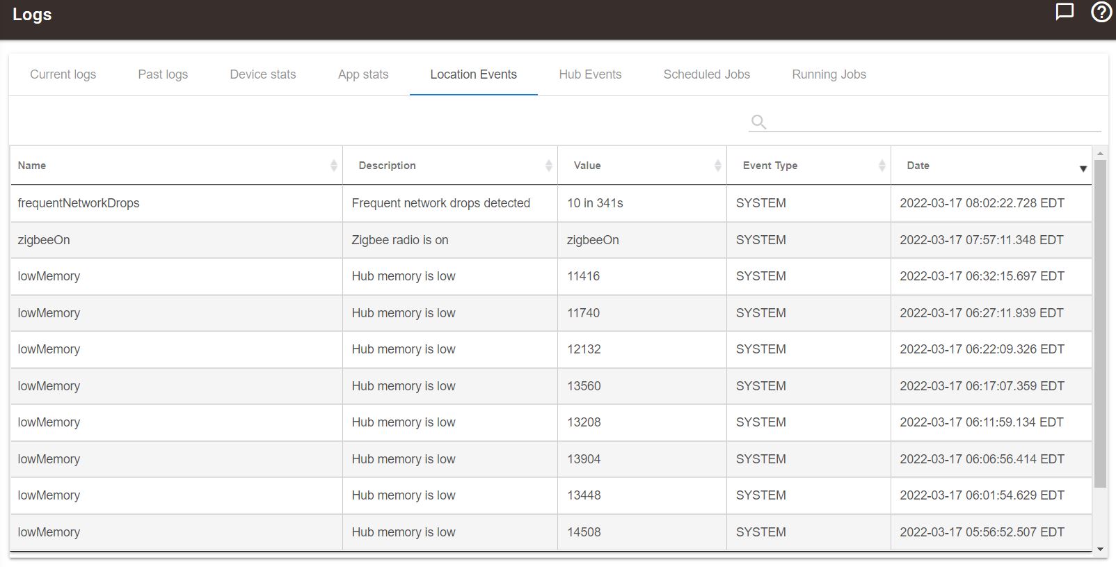

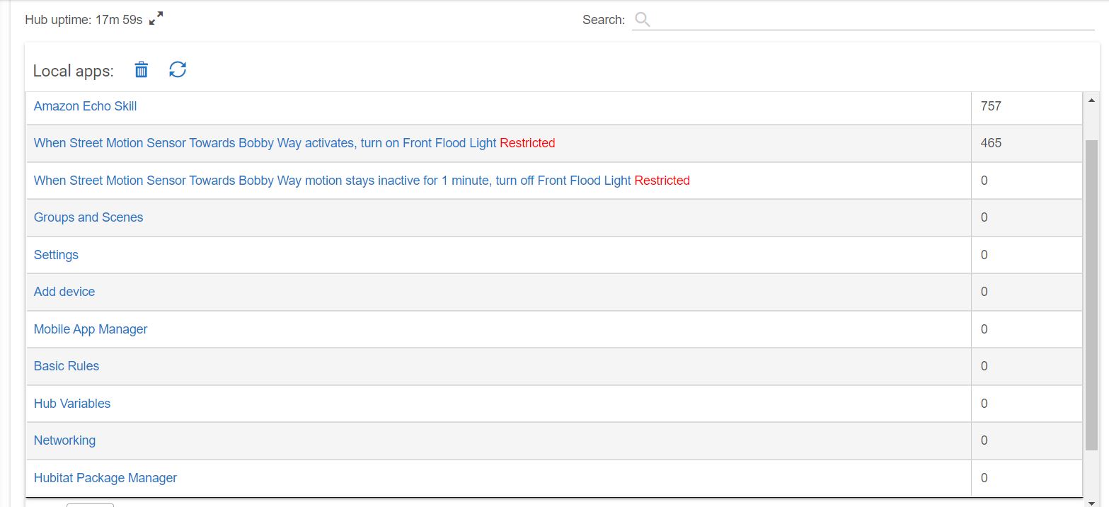

@Jaimiewonder What apps are you running? Can you post a snapshot of your entire z-wave details page? Post a screen shot of your LOGS>>APPSTATS and DEVICE stats page.

I was having similar issues, and found very little help on the forums. An email to support was very helpful. I had my hub attempted to auto-reconnect to internet every X seconds, which they suggested I disable. I did, and all my issues went away. That may help.

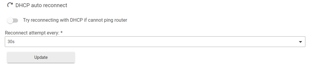

Is the hub running WiFi adapter?
If not, please disable this option in Settings - Network Setup:
Some routers reject a ping, and reconnecting every 30 seconds will definitely eat up hub's memory over time.
@gopher.ny -- just to confirm, by "disable this option", you are referring to just the slider, correct?
Mine looks exactly like your image above -- I'm just wondering if I need to additionally select "No selection" (or something else) in the dropdown menu too. Thanks!
Yes, if the slider is off, the selection below it doesn't matter. Unless the hub is running WiFi, then auto reconnect is always on. The app should probably reflect that...
Perfect - many thanks!
