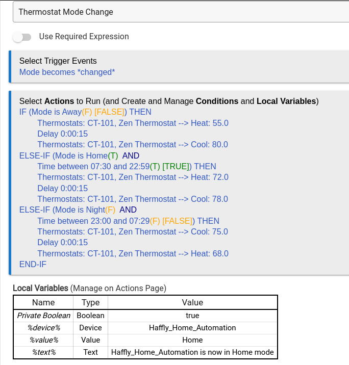

Can you post a screen shot of a rule that uses if/then/else and maybe describe what you're trying to do?
So that we don't keep this discussion on the hypothetical level, a few screenshots of your existing Rules might be in order. Extra pairs of eyes never hurt, and you never know... someone might pipe up with something unexpected like, "Hey, you're missing an END-IF" or some other speck of housekeeping that's bollocksing up your workflow.

Those triggers are most likely good since you used the *changed" as the trigger, some people misuse the True or False as the trigger instead, and expect a different outcome because the action part will never go to the else (flase) part because the trigger is set to run when true only.
