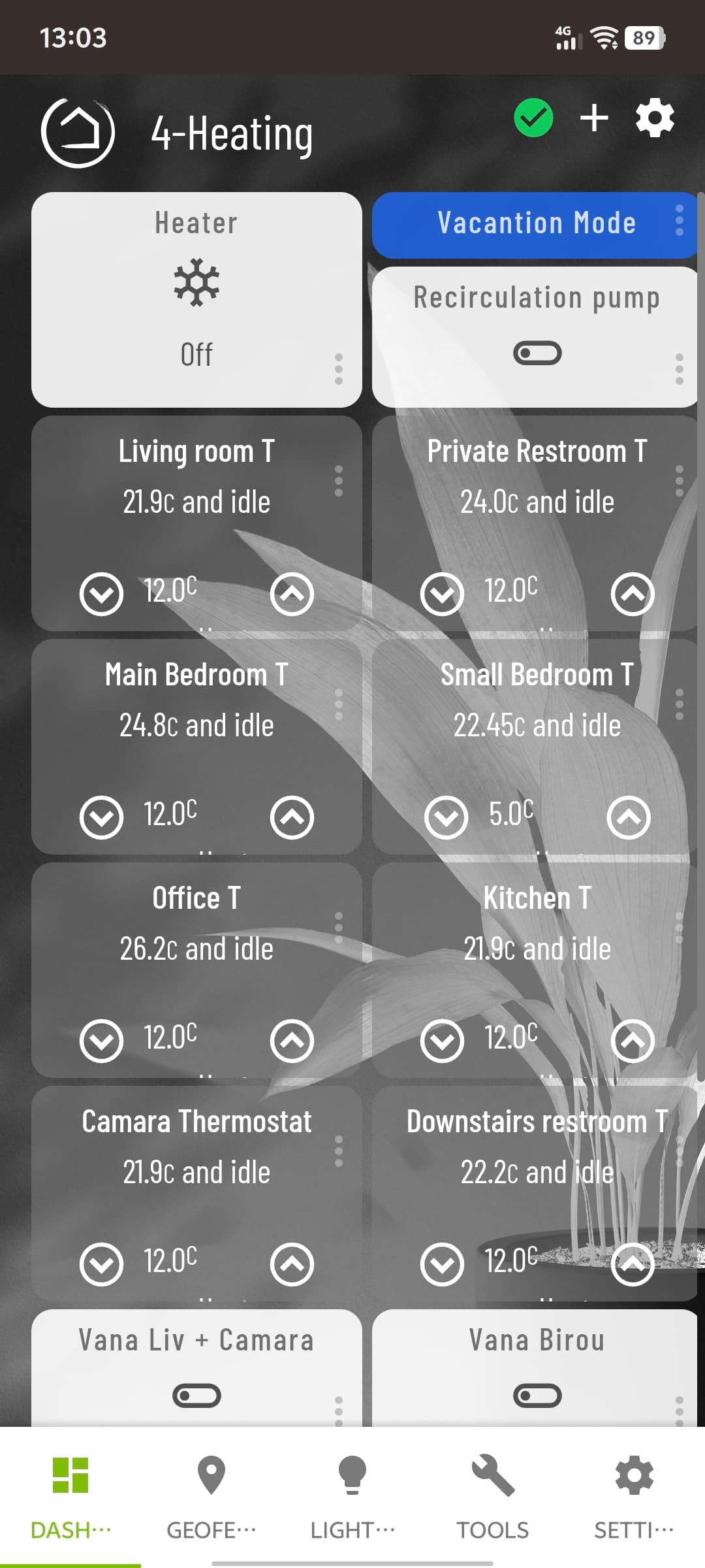

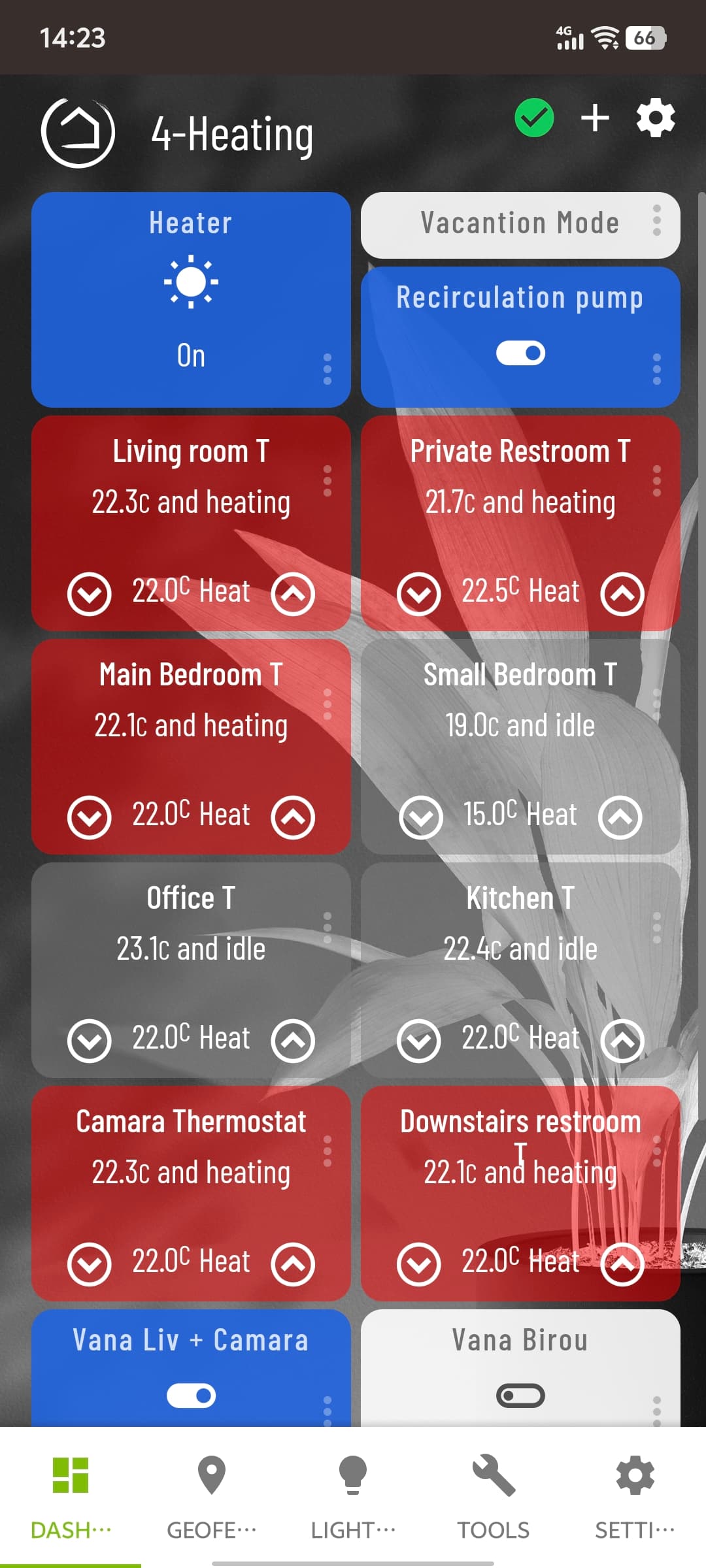

Hello, I'm not sure exactly what happened but my heating dashboard got screwed in some update, I found an older screenshot to show how it look when it was working compared to now
As you can see the Heat text got below, if i expand the title i see it floating around
Also I noticed on my desktop that is shown correctly but is glued to the C (from celsius) when it supposed to be a space between them.
I haven't changed anything in my code, I tried adding padding and margins to fix it but not idea what happened, below my is css code if someone can know how to fix it, thank you

You posted the json layout file, not the css, just fyi.
The background colors in the json layout can be changed manually, but this is also what changing the colors in templates tab modifies. So you can just reset your colors in templates as it gives you a color picker.
You must have CSS as well, that is putting your titles on top and removing the Mode and Fan Mode buttons. You should post that CSS. Your Do Not Modify section is just pulling css in from the CSS file, but it is best edited in the CSS file. That long line is very hard to read, I assume you have a formatted CSS file?
The long line is injected by the use of smartly. Hard to be sure how best to troubleshoot the issue....
Also, am I missing something... but what is different? Obviously the colours are due to different status' for tiles, but what exactly is the issue?
Ah. It injects it into the Json instead of the CSS file? That does make it hard to troubleshoot if the CSS has not been done manually.

here is the css as well, i've edited my dashboard with smartly and i realize is hard to debug now sadly...

maybe a dev knows what changes he made that broke my dashboard? I tried reverting up to 3versions ago but the problem was still there so it might be a bit older, i noticed only now since it was hot outside and didn't had to use my heater
