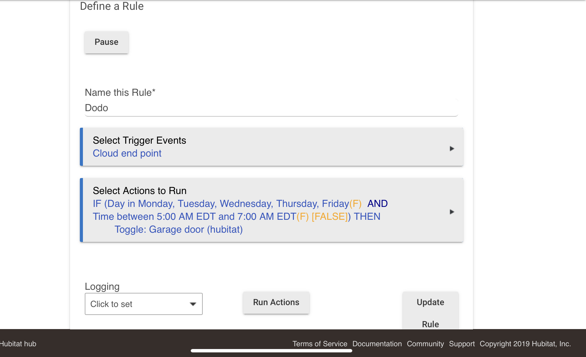

Hey, u think this would work, I just give her the cloud end point
That should work. Are you going to give her the URL as a bookmark?
I would have her add it as an iOS shortcut
