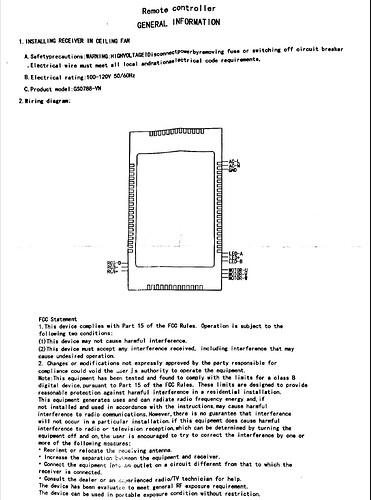

What I didn’t realize is that it would only operate from the included remote. However I see the control unit on the fixture can be easily removed so I was wondering if it’s possible to swap out the control fixture with separate controllers for the led light and fan. This would make it connectable to Hubitat for control.
This is the wiring diagram for the control unit

It looks like the motor has three speed wires, similar to other three wire three speed motors.
For my stove fan hood, I used a 4 channel Zigbee relay, to simply switch each of the fan speed wires with three of the relays. I put it in the mode where closing one relay causes all the others to open, so there can never be more than one speed activated at a time. The last relay I use for off, since when the off relay is on, the other three relays turn off.

Any "Fan controller" is going to be manipulating the AC power to get the different speeds. The DC fan is expecting full line voltage and then converting that to DC internally, and I would assume all the speed adjustments are done by manipulating the DC power after the conversion happens.
Best bet is to mount the remote on the wall but then its not conducive for HA integration. Maybe we will get a real solution eventually?
You almost need a special DC canopy module but I don't know if any of this is standardized or if every mfg is just doing their own thing with the DC controls. Guessing the latter, so a universal module may not be feasible.
Many modern DC Motors actually a 3-phase AC Motors. The speed is controlled by variable frequency, not voltage. On the diagram above motor control signals labeled U, V, W. This is 3-phase sine wave signals, created by using digital PWM sine wave sequence.
