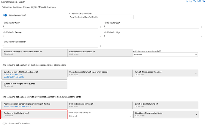

The easiest way to achieve this exact type of lighting automation that I have found, is to use the built-in "Motion and Mode Lighting" app.

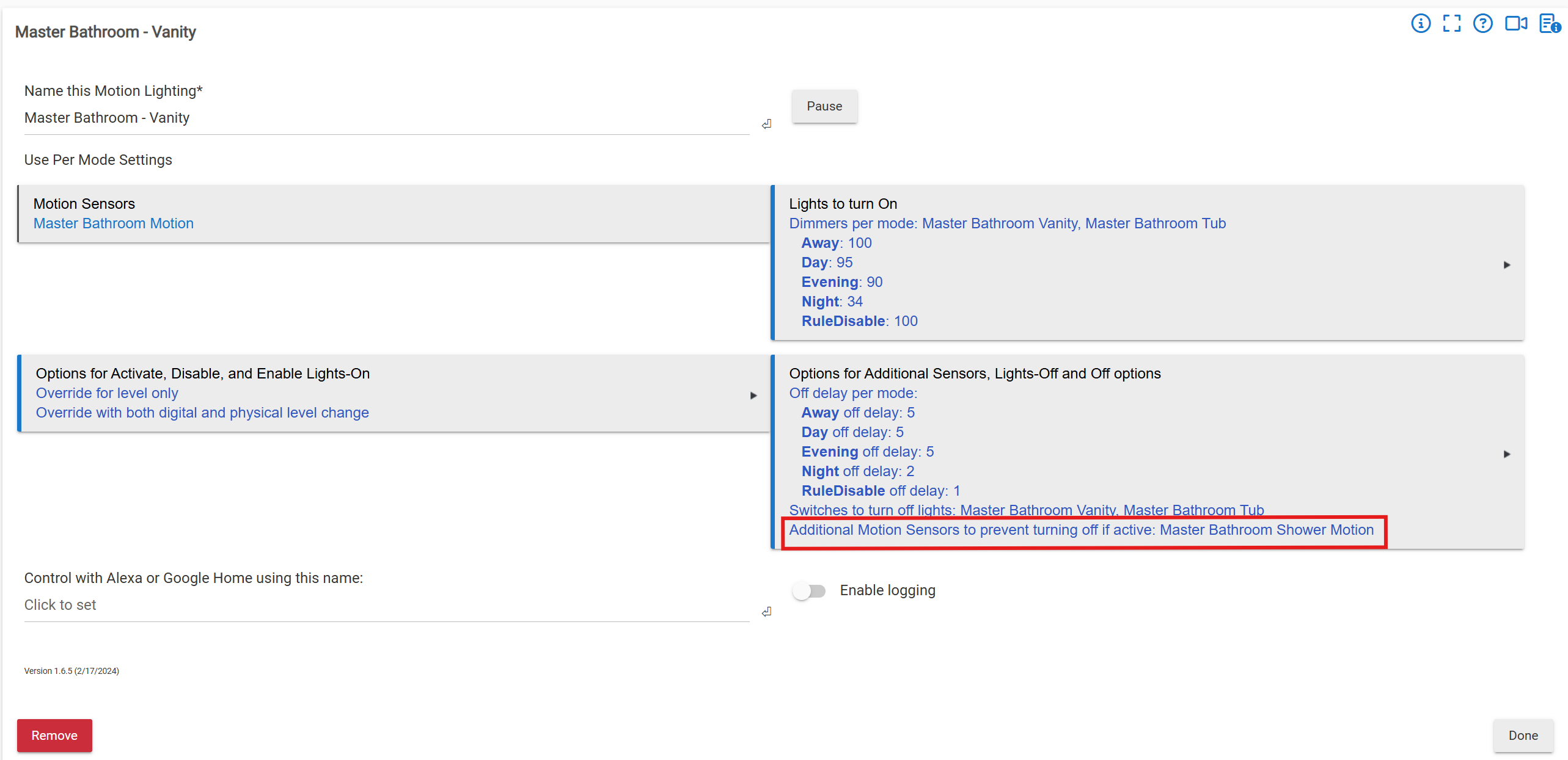

Here is an example of my bathroom's instance of this app.

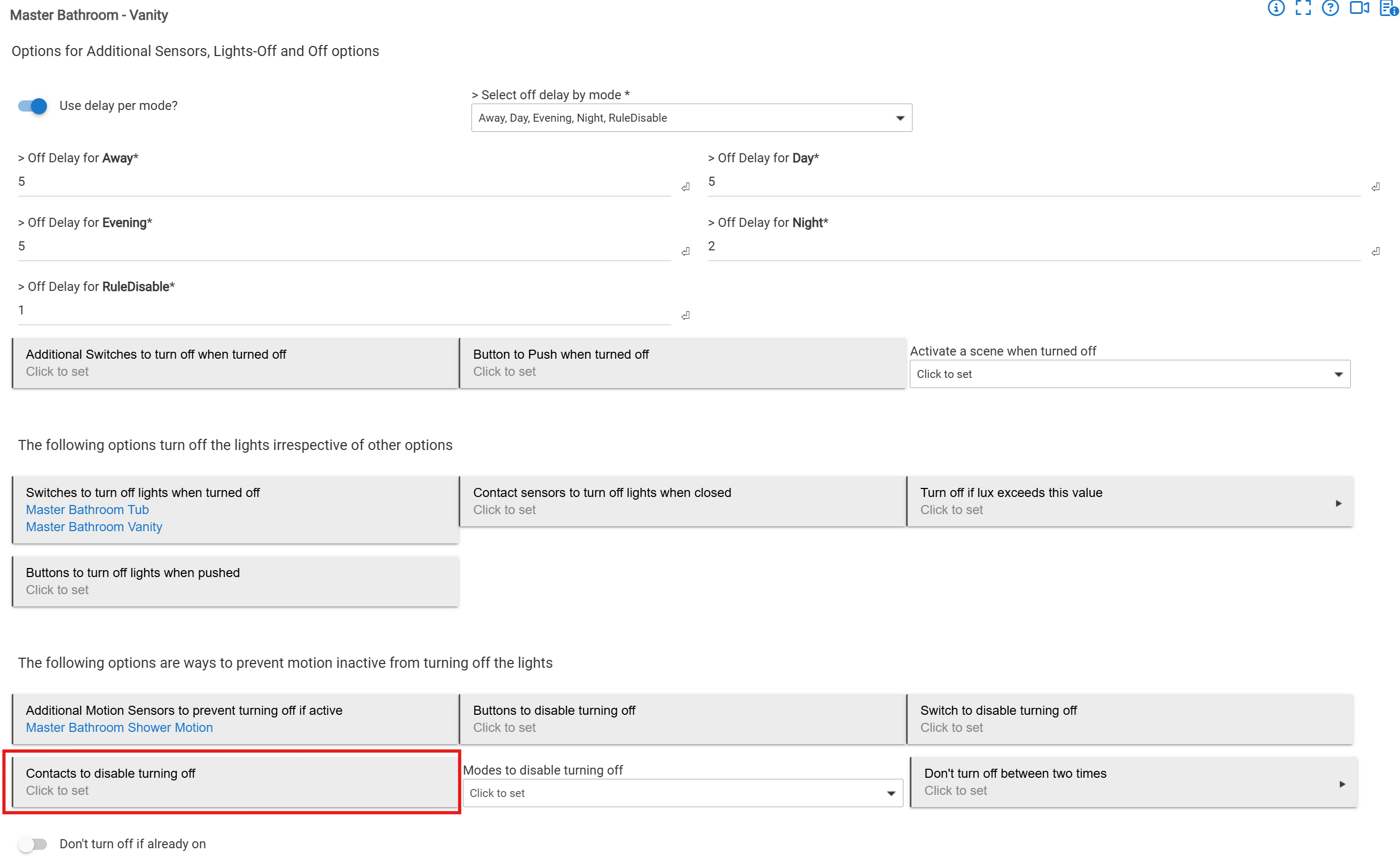

You can see the red-circled section where I use a second motion sensor to keep the lights on while in the shower.
There is an option in this app, where you can also assign a contact sensor to keep the lights on.
Using an app that is designed specifically to handle these lighting automations is much, much simpler than trying to build a Rule Machine rule to achieve the same results.
I believe the same lighting automation could also be created using the newer built-in "Room Lighting" app. I have just never bothered trying to migrate to Room Lighting as my automations already work 100% reliably for my requirements. (i.e. If it isn't broken, don't fix it! )

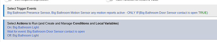

If you are using a motion sensor to turn the lights on, then use the contact sensor on the door to turn them off. I have a rule like this.
Example:
Trigger - motion sensor is active turn on lights with either a required expression or conditional triggers that the door is open.
Wait event - door contact sensor is opened
Action - turn off lights
I have a rule like this in one of my bathrooms that works great. It might not sound like it will but it will.
The system won't read the second open to turn the lights off until the door is closed and reopened.

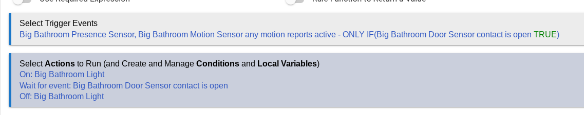

Edit:
Below is a screenshot of a test rule I just wrote. The lights come on with motion. Motion can go inactive and lights stay on. Lights will stay on until the door is closed and then reopened. Lights go off.
If you want them to go off if the door is not closed you can do if statements to make that work as well.
I tried and came pretty close, but it you leave right after entering and close the door, the lights never turn off...
