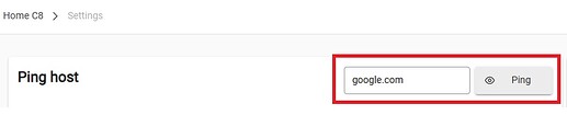

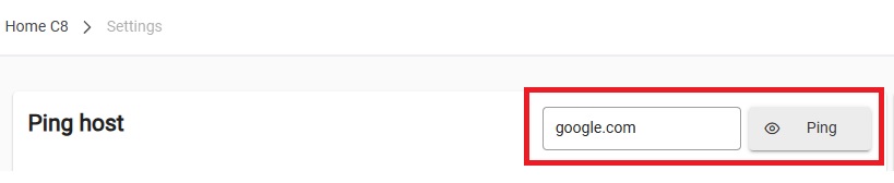

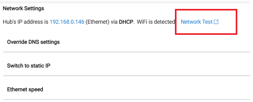

  • Similarly, have to gone to the Settings tab, Network Setting, Network Test (See first screenshot below)and tried to do the Ping Test? Use google dot com in the box as shown, and hit the Ping button. You should see some results that show you can communicate with Google. (See second screenshot below)
Yes I have done that multiple times. I do see the items I selected on Google home listed in the Hubitat app. So they are communicating at some level. But something is preventing full integration. I can not use google to control anything through the Hubitat (even when just selecting a couple of basic switches). And Hubitat is not showing as linked in the Google home app.

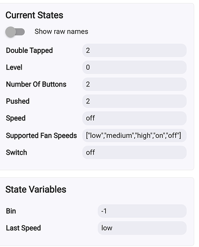

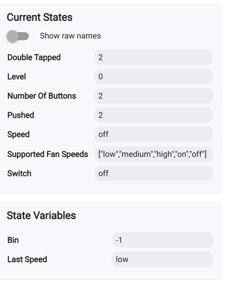

What device are you using the control your fan? What driver (type) do you have it set to? And also please post a screenshot of the "Current States" from a fan that is giving you problems.
I am using the "GE Smart Fan Control" driver with GE z-wave plus fan controllers. Here is the status:

That is a system driver, it should be fixed.
You may just need to run the Configure command to reset the supported speeds value. It will probably look the same but it has to be saved in a specific way or it breaks downstream integrations.
Another way to be absolutely sure it is cleared and reset:
Switch the driver to "Device", and then run the command to clear current states. Refresh the device page to be sure it is cleared out. Then switch back to the GE driver you were using. Then run the configure command and the refresh command, the Current States should populate again.
