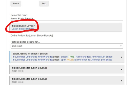

I saw the rule example below in this thread. I'm trying to create a single rule that would handle the 3 button presses of an Aqara mini button. Can someone explain to me how this trigger was achieved, i.e., "Select Button Device *"? Currently I have 3 different triggers, one for each button press.
-Thanks
Can I use rule machine to make a single button do different things based on the status of the controlled item? Specifically asking about shade control - :triangular_ruler: Rule MachineĀ® / All things Rule Machine - Hubitat
That 2021 thread predates the introduction of Hubitat's Button Controller (and Basic Button Controller) apps, and discusses a version of Rule Machine that is long gone.

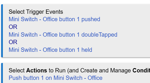

That would explain why I can't duplicate it in Rule Machine! Here's what I have so for for the trigger handling 3 button presses. it seems somewhat redundant to me though, because I'll need If/Then logic in the action or actions to handle the 3 different button presses.

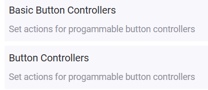

Try the button controller app.
Thanks I'll check it out! Would you recommend one of these over the other:

TBH I forgot there were two versions of it now.
I believe it’ll depend on how complex you need the actions to be once a button is pushed.
Basic button controller is probably the better place to start.
If you can’t achieve what you need from that, then button controller should be capable of doing anything rule machine can, with respect to the complexity of the actions.
The advantage of using either of these purpose-designed apps (over rule machine itself) is that it’s much easier for the user to assign actions to various button taps, holds, double taps etc.
