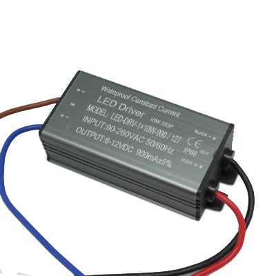

I Made it...using a Led driver between the zooz and my 127v doorbell xD...
I used a led driver like this one
LED-DRV-1X10W-900_127

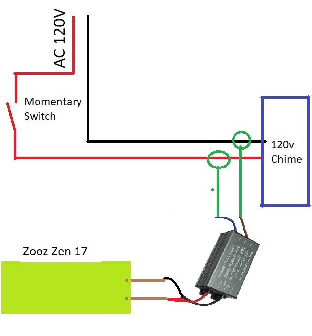

and the final scheme would be something like this
Even a fast or long pushing to the switch on my door,activate the Zooz zen 17 register an On and an Off Event
