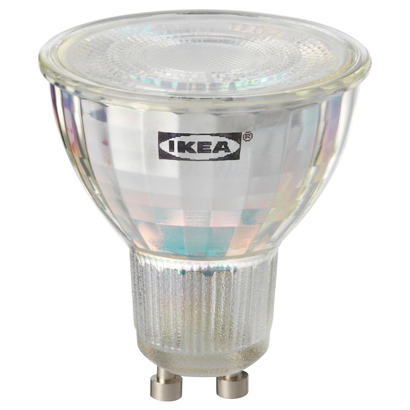

Answer: Get IKEA Bulbs - and control them in a group.
P.S. Get the more expensive Ikea bulbs - they work great even on the same Hub as other zigbee devices.
P.P. S. Use the generic zigbee rgbw driver

I plan on doing the same … getting these from Ikea US:
They are only $1USD more than the non-CT counterpart
You guys are lucky with the GUI10 bulbs! I have the G9 type so no smart for me.
I have a Broan hood … it was about $350-ish and what attracted me most was the 4 integrated GUI10 bulbs … they are nice and bright but seeing as they are Halogen, burn hot and can fail … I never use them for any sort of mood lighting - only cooking. When I switch to the Ikea bulbs, I'll automate my hood with the rest of my mood/ambient lighting schemes.
