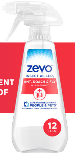

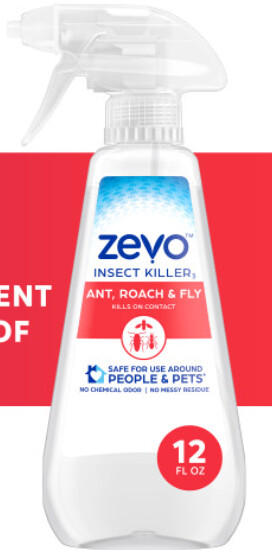

Update: the Heiman NG sensors will also detect this. :thinking:

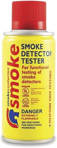

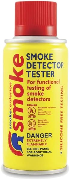

I test with this:
It worked with these devices:
  • Manufacturer _TZE204_iuk8kupi, Model TS0601 [VERY, VERY spammy - 6-8 log entries per second, non-stop; I keep it only because it returns numeric values, but I only enable it for 30 secs every 5 minutes]
  • Manufacturer _TYZB01_0w3d5uw3, Model TS0204 [Heiman clone]
