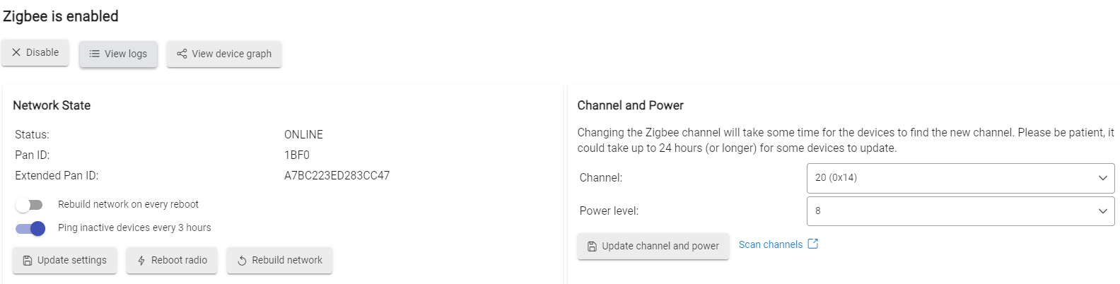

I've disabled Z-wave and Matter but made sure Zigbee was enabled and on a clear channel (20).
With these settings I tried to pair it with the very first Zigbee device, a SmartThings Button, but the pairing process wouldn't find the button. I started with the button a couple of rooms away from the hub, but the button is now sitting right in front of the hub and it still cannot find it. I've tried all pairing modes available but it won't find it using any of the modes.

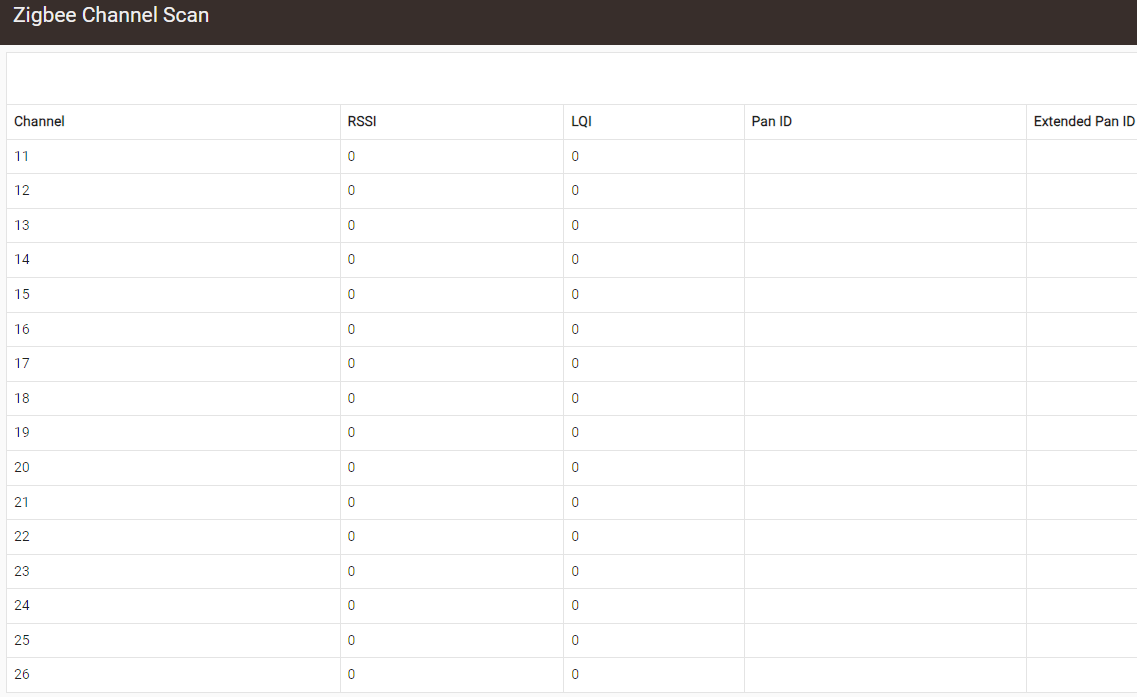

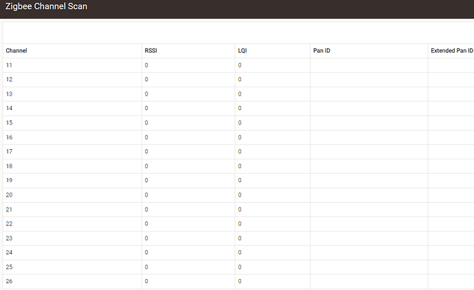

When I do a Zigbee channel search I get zeros for all channels:
I have three Zigbee channels in use and other HE hubs identify all these channels, but this hub doesn't. Makes me think something with the Zigbee radio isn't working properly.

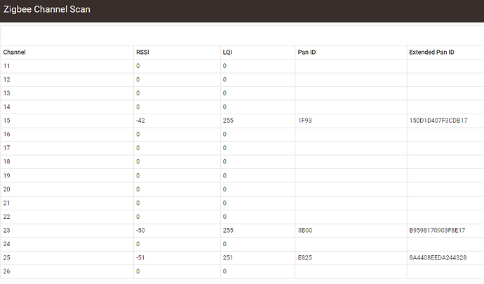

I swapped the USB power adapter and cable that came with the hub with other ones I had and all of a sudden I'm getting results from my Zigbee channel scan:

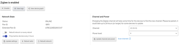

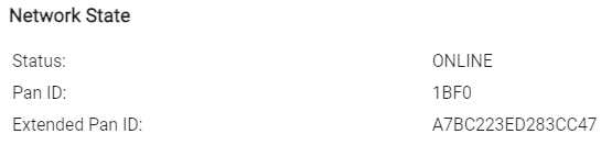

I played around with different combinations of USB cables and power adapters, but now Zigbee has stopped working again, even with cable and adapter combinations that worked before. It still thinks Zigbee is working though:

Seeing the hub cannot find anything when doing the Zigbee channel scan, it leads me to believe that there's something wrong with the Zigbee radio or the connection between the radio and the antenna. :man_shrugging:
Edit: If there is a break in the connection between the radio and the antenna, that could explain why the Zigbee channel search returned results a few times. That happened when I was testing different power cables and adapters, so I was physically moving the hub around between those tests. Moving the hub one time there might have been enough to get a connection across the break in the connection between the antenna and the radio but then moving it subsequent times the connection was again severed. That could also explain why the hub thinks that Zigbee is online. The radio is working and is online, it's just that it cannot hear anything with no connection to the antenna :thinking:
