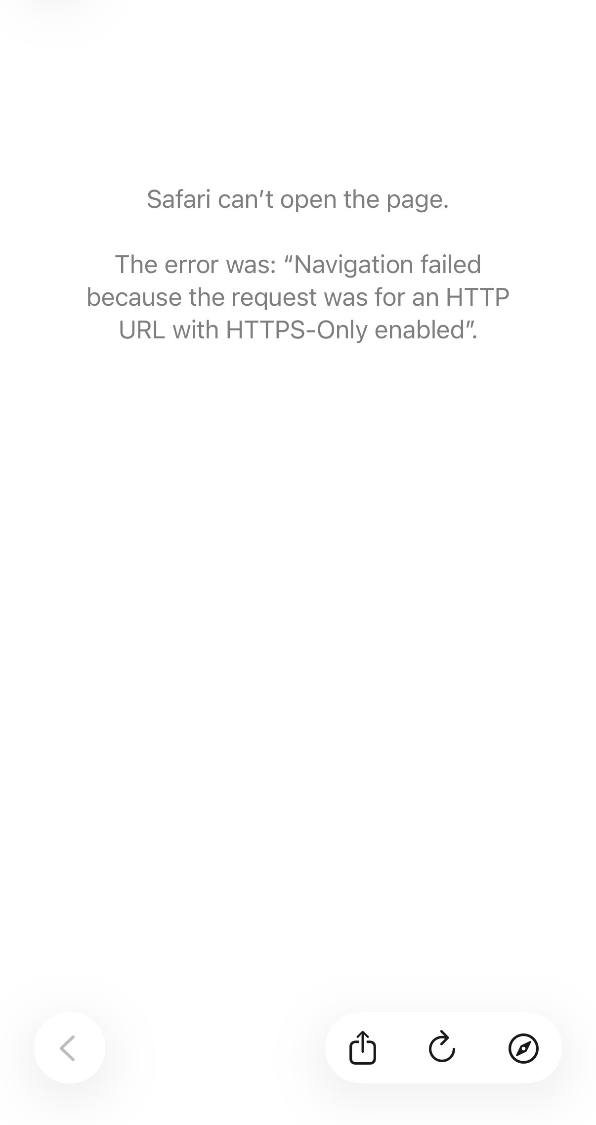

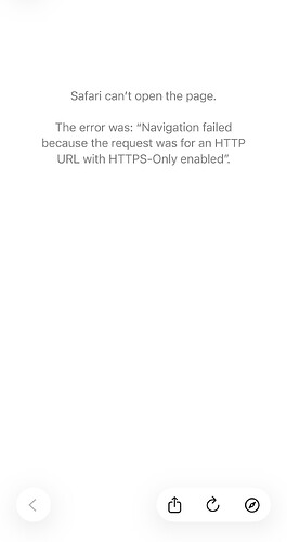

Could be a coincidence, after the last update, I can no longer connect to my C8 and C7 hubs from the HE app on my iPhone (iOS 26). Get the error in the screenshot below. I can however go to Safari and type in the address of the hubs and connect without issue. I have not had this issue before.
Apparently if using iOS 26 and the Safari browser, if you want to view http sites, you will have to go to settings, apps, Safari, privacy & security, and disable Not secure connection warning. In Apples infinitive wisdom, it is NOT a warning but a block of the website.
