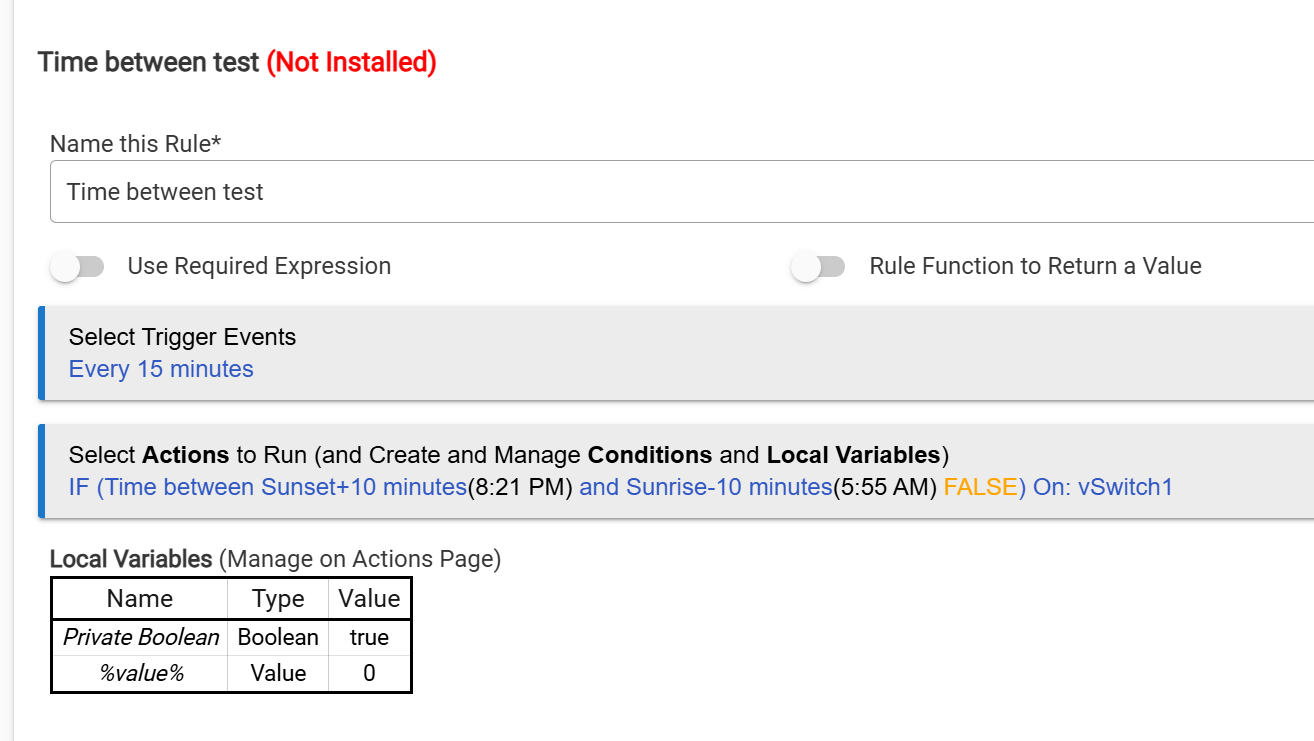

Why not just use a simple Conditional statement to check the time relative to Sunrise? Here is a quick example I just put together that may do what you want with the need for any variables or additional rules.
In this example, I used a Periodic Trigger, as I had no idea what your actual trigger would be. It only has one Action, however you could add other actions that are not time dependent to the same rule if desired.
