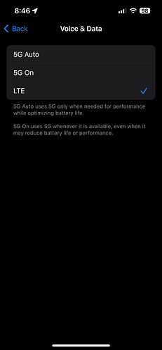

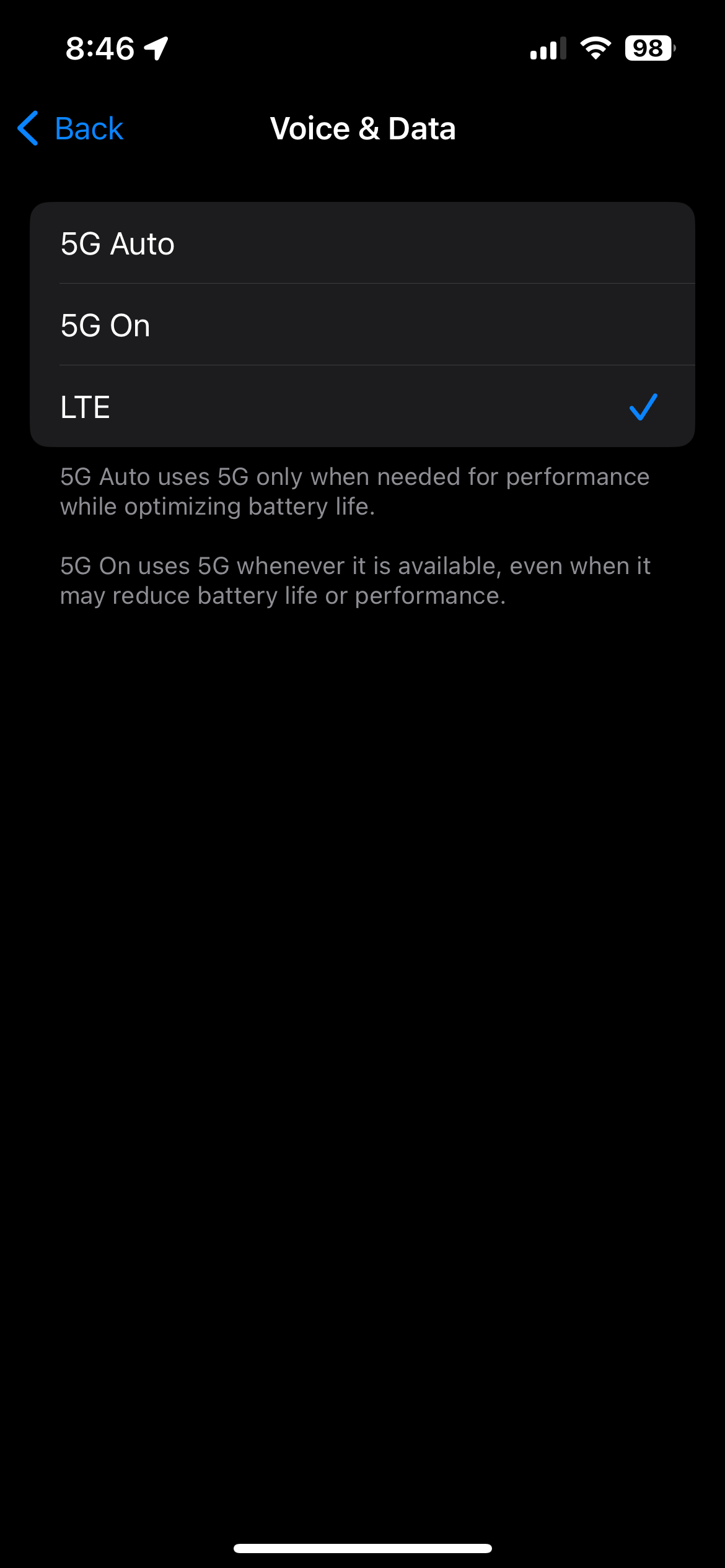

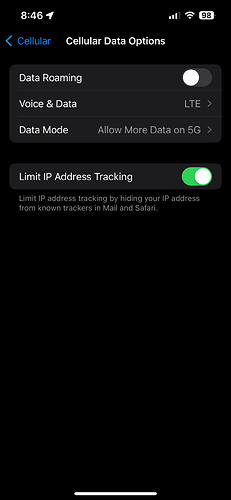

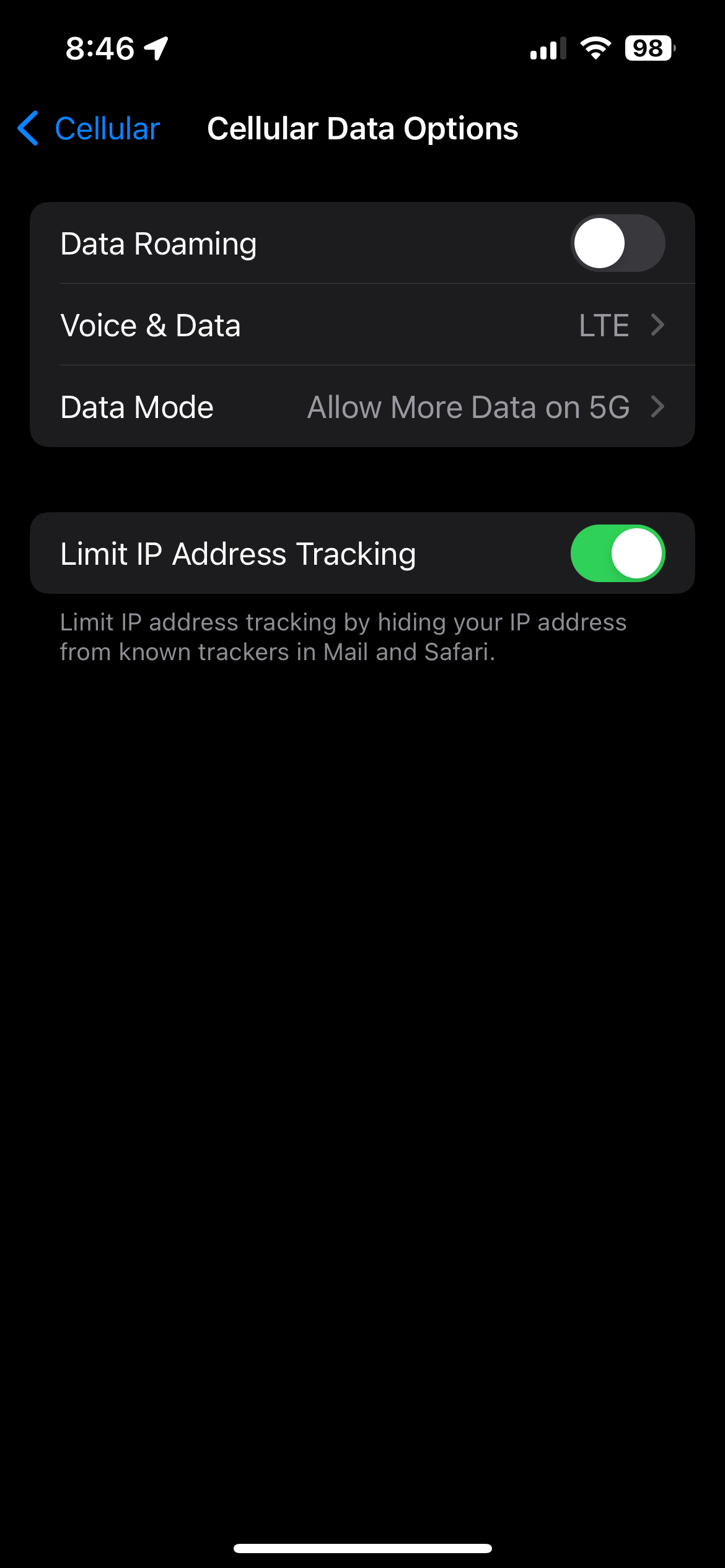

Here’s a very general one that might help someone. I use an iPhone and when I am set to 5G Auto, I sometimes cannot access the hub over WiFi. This is a known issue by Apple. They do state that when set to 5G Auto, the phone may try to access 5G, even when you’re in your home if it’s determined that the 5G connection is a faster than your WiFi. To fix this, I set my phone to LTE only and that instantly resolves the problem.
