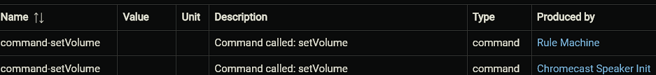

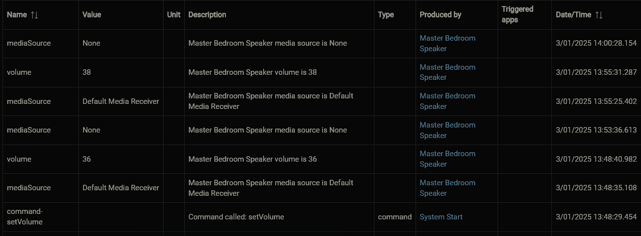

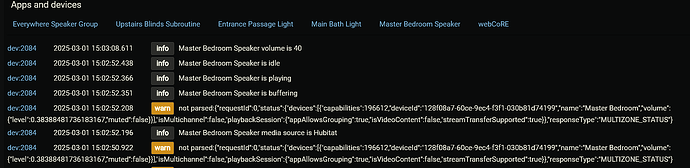

I can't set the volume of a Chromecast device by using setVolume; the command does nothing. Even the Speak command var Volume does not work.
The only way I can set the volume is to Speak a " ", wait a few seconds and then setVolume.
People have suggested Initialize first but that does nothing as well.

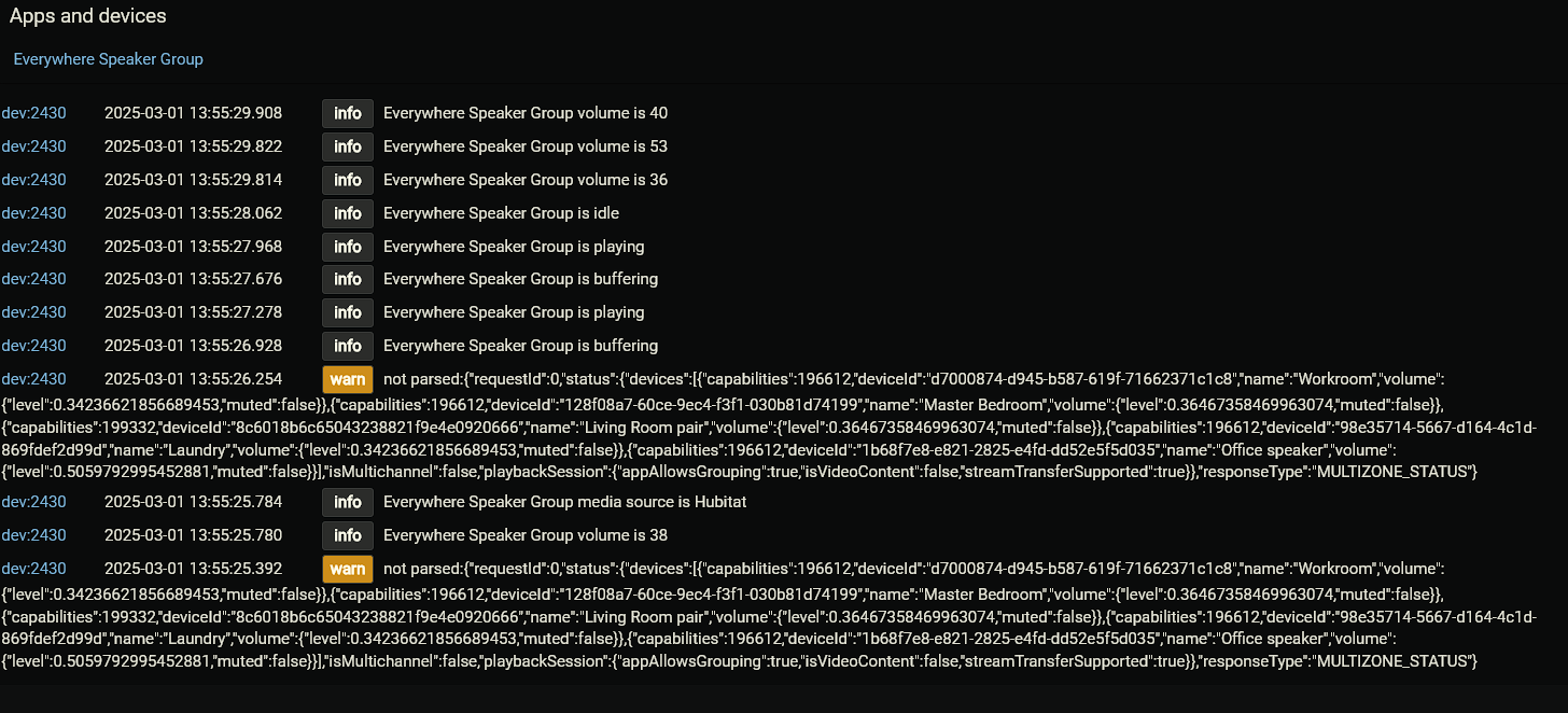

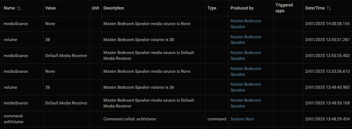

You can see from the screen capture I started with a vol of 40, it randomly goes to 38, speaks a blank, the changes vol to 36, 53 and then 40. Ending at 40 is never the result, lucky this time.
In the second example of events you can see I send a setVolume of 40 but the value show as blank and then I get my usual random volumes.

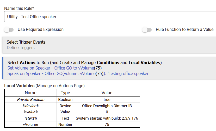

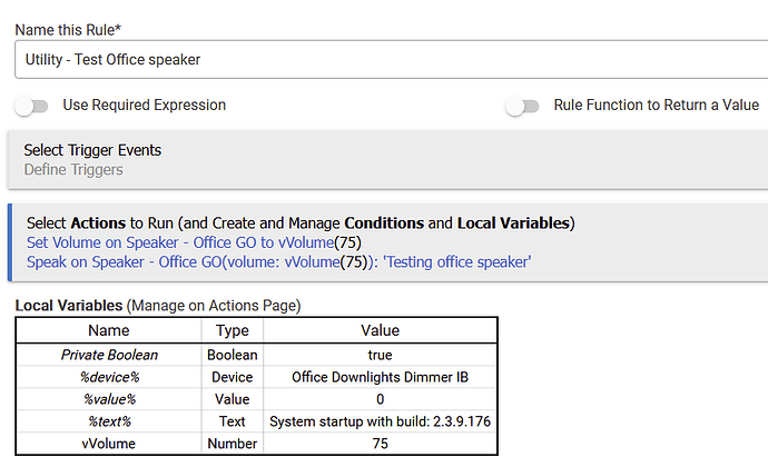

This test rule works for me (the device name is "Speaker - Office GO"):
Note: you are correct that the "Speak command var Volume does not work." It's been broken for a LONG time, at least with respect to a Chromecast device.

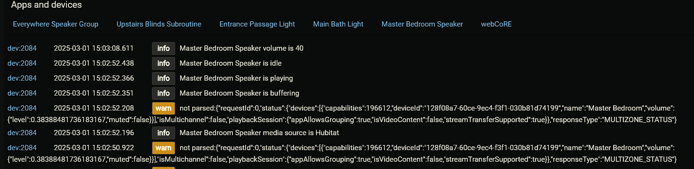

I tried just a plain mini with debug on.
I got no log entries and no events.
If I do a Speak " " first I get a log entry for the setVolume after the Speak " ".
I could try an RM rule but I'll have to investigate on whether it can be called by my startup piston from WC or run on the startup event.
I haven't used RM since SmartThings. :slight_smile:
EDIT: WC has an Execute Rule command so maybe some hope.

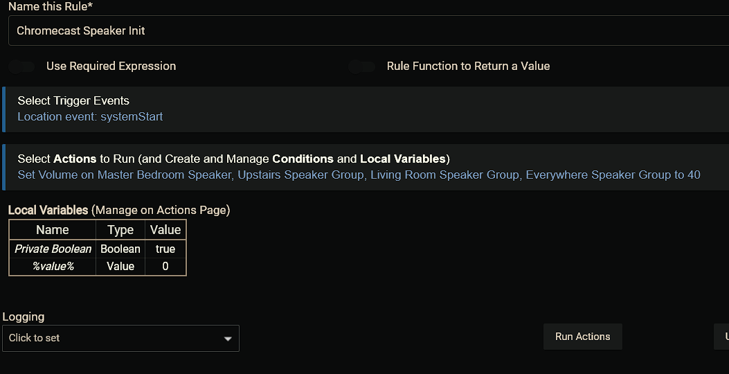

Well, I made a rule and executed it while in RM and it set my 4 groups to 40 when I initially created it and pressed Run Actions.
Editing and pressing Run Actions doesn't do anything now even if I remove the trigger event.

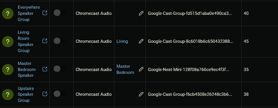

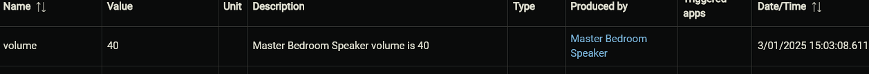

I set all my groups to 45 and run it on startup and this is what I get. One group changed. :frowning:
There isn't even a Value set.

My issue has always been trying to set all the volumes on boot to be the same.
setLevel command mostly sets random numbers and in the logs you'll see random volume numbers magically being reported.

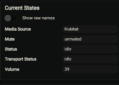

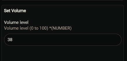

Another crazy example.
setlevel to 38 and this is the output.
Send 38, get 39.
