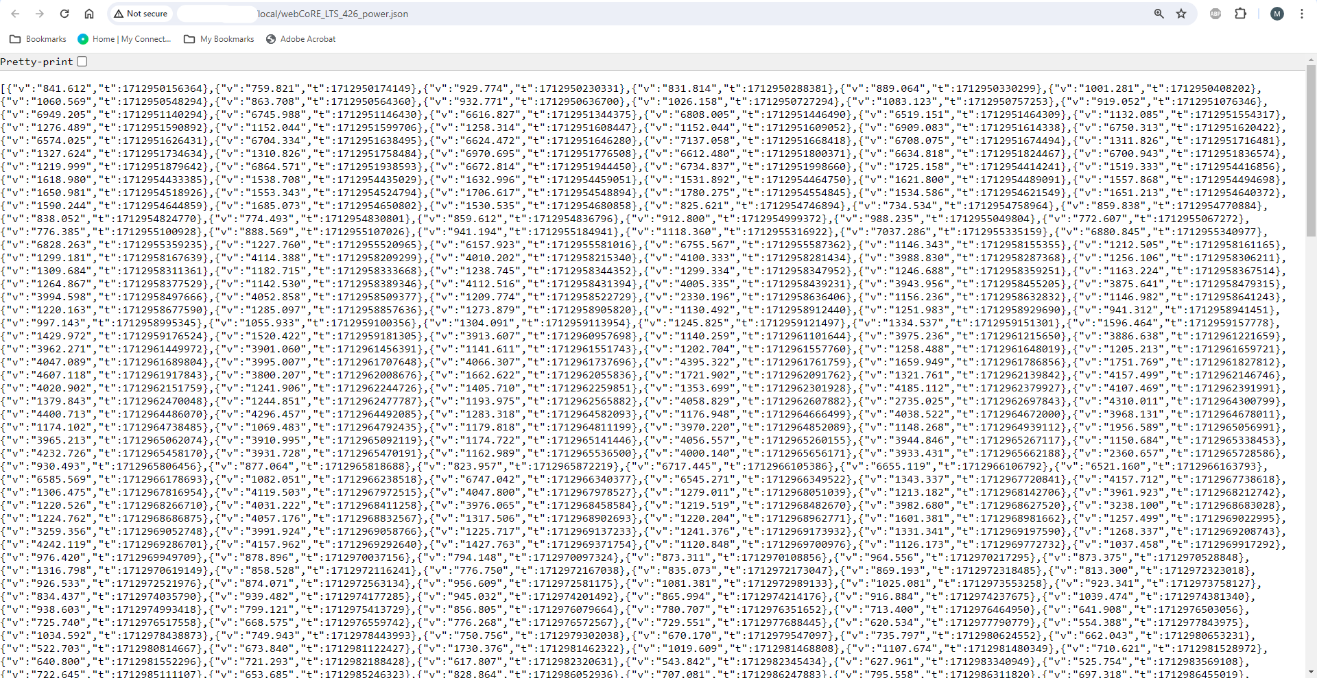

You could try Long Term Storage(LTS) in webcore. It will create a file as shown below that you could download off your HUB. It is just a text file.
The file in my case contains about 1000 data points and that is for 2 days. You can save up to a year or more but the file will get pretty big. This file according to the HUB file manager is 32K.
