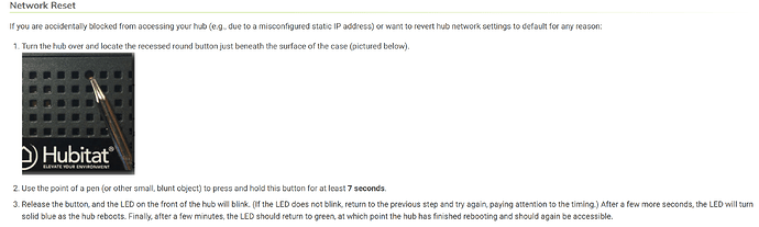

I doubt you need to do a hard reset. Sounds like you just need to reset the network settings.
Network Reset

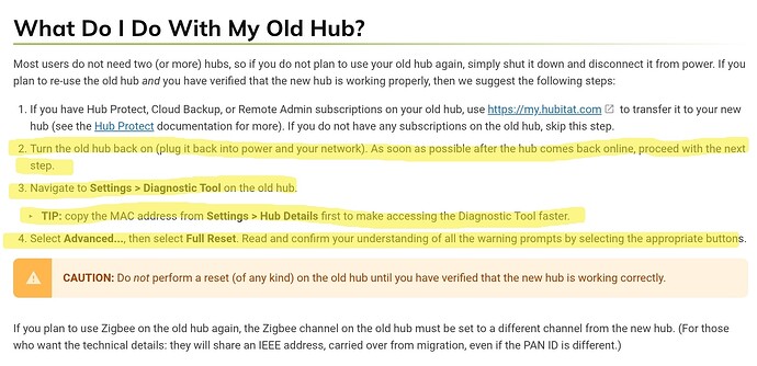

That said, powering up your old C7 after having migrated to another hub can be problematic also.
(Click on what do I do with my old hub)
Directions for doing a full reset are in those directions. (NOTE: DON'T SKIP STEP 1 IF YOU HAVE A SUBSCRIPTION ON YOUR OLD HUB)
Resetting Old Hub

Try the Network Reset again. Then search for its NEW IP.
You should then be able to connect (at least thru maintenance port.)
On the bottom of the hub, there is one opening that looks slightly different than the rest. There is a physical Network Reset button in that one hole that will reset your hub to DHCP network settings. Hold the button for 7 seconds (the LED light on the hub will change colors) and then wait for the hub to reboot. Afterwards, you should be able to 'see' your hub in your router's DHCP leases. Once you know the new IP address, connect to it via a web browser and then you can perform whatever type of reset you'd like, typically via the HUB's Diagnostic tool. It is all covered in the official Hubitat documentation that @tray_e mentioned earlier.

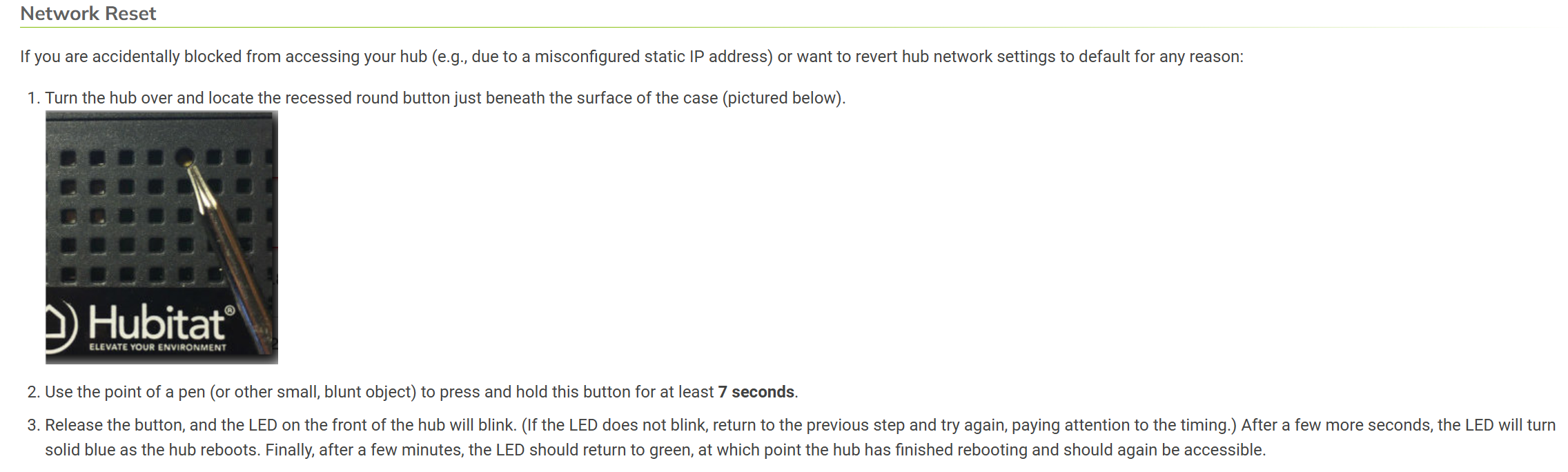

And included the same picture..... :upside_down_face:
