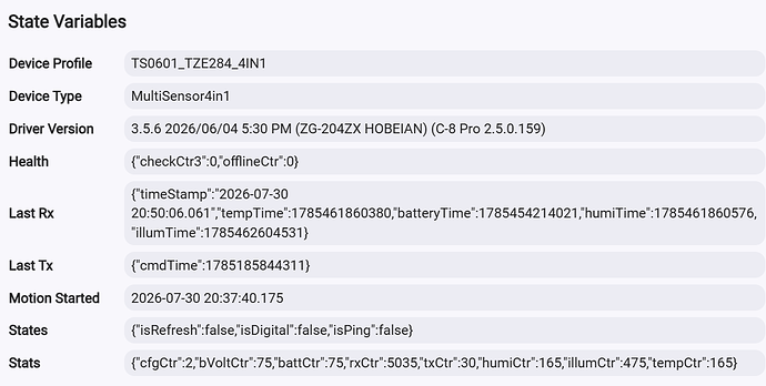

This is my device info:
It has apparently been working find but it’s not really in production doing something useful so it would be easy to overlook if the motion sensor was not operating. But the events suggest they are. I am using the battery that was included.

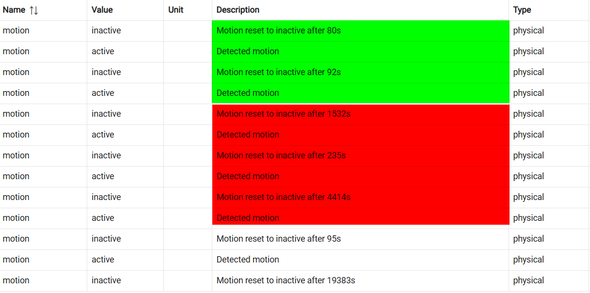

Hello,
I'm having some issues with this device. It detects motion in an unoccupied bathroom and never seems to go inactive.

Hi Aaron,
Join the ‘Hub owners’ group so that you can post screenshots:
https://community.hubitat.com/g/owners
What is the ‘healthstatus’ attribute value on your device Commands tab?
If it shows ‘Online’, go to the Preferences tab and reduce the sensitivity parameters. Reduce the maximum distance too. Then, click on Save.
If the device is showing Offline 12 hours after the first pairing , it may have been disconnected from the Zigbee network. Try to pair it again at a close distance to your hub.
Joined, and thank you!

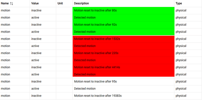

That might have done the trick. Here is a screenshot that shows before and after making the changes. Here are the settings:
PIR Sensitivity = low
Radar Sensitivity = 3
Detection Range = 1
Red = before changes. Green = after changes
Thanks again for the help!!
