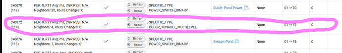

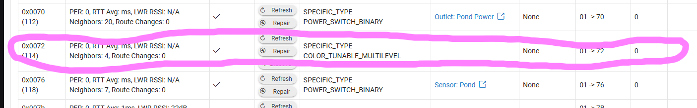

This is the only thing that may be a ghost is this device. but when using PC Controller it dosen't turn it RED when I use "Is Failed" though.
